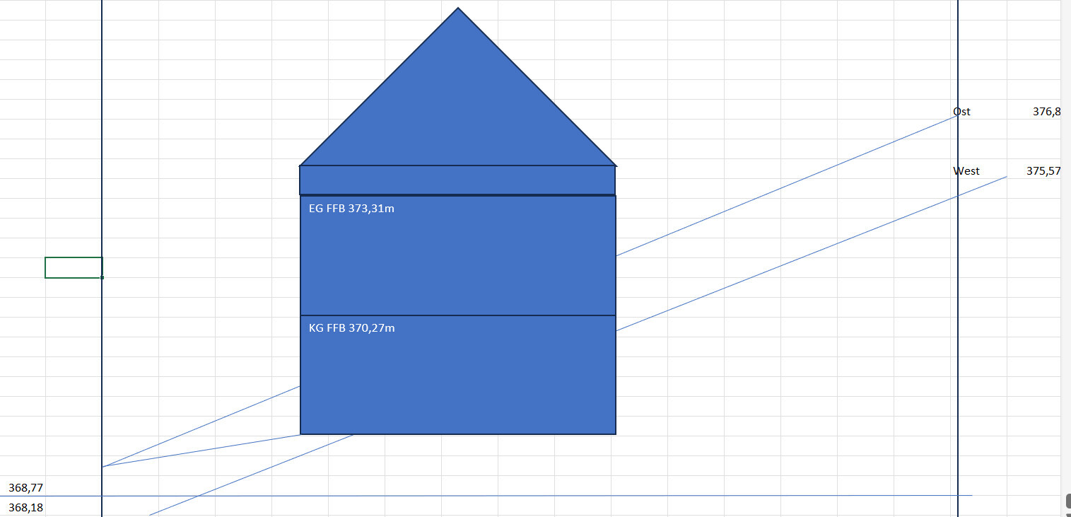

hanghaus2023 schrieb:
Here is my suggestion. The garage/carport and entrance would be in the basement. Answering my question would help. I assume there is a building boundary (see neighboring houses).

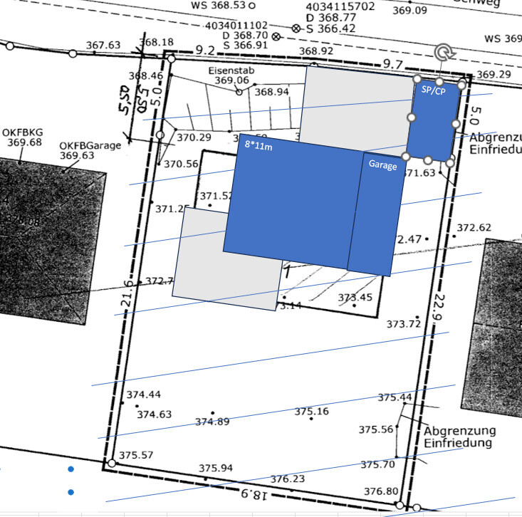

hanghaus202325 Mar 2025 09:0657Christian schrieb:
When it comes to the question: I have no idea. I just noticed this number on the drawing, with a D in front of it.
Or was it about a different question?
So, the house should be moved further forward? Lower the level of the basement and garage even more? Otherwise, it would be even steeper. Exactly. If the manhole cover is the reference point, what should it be used for?

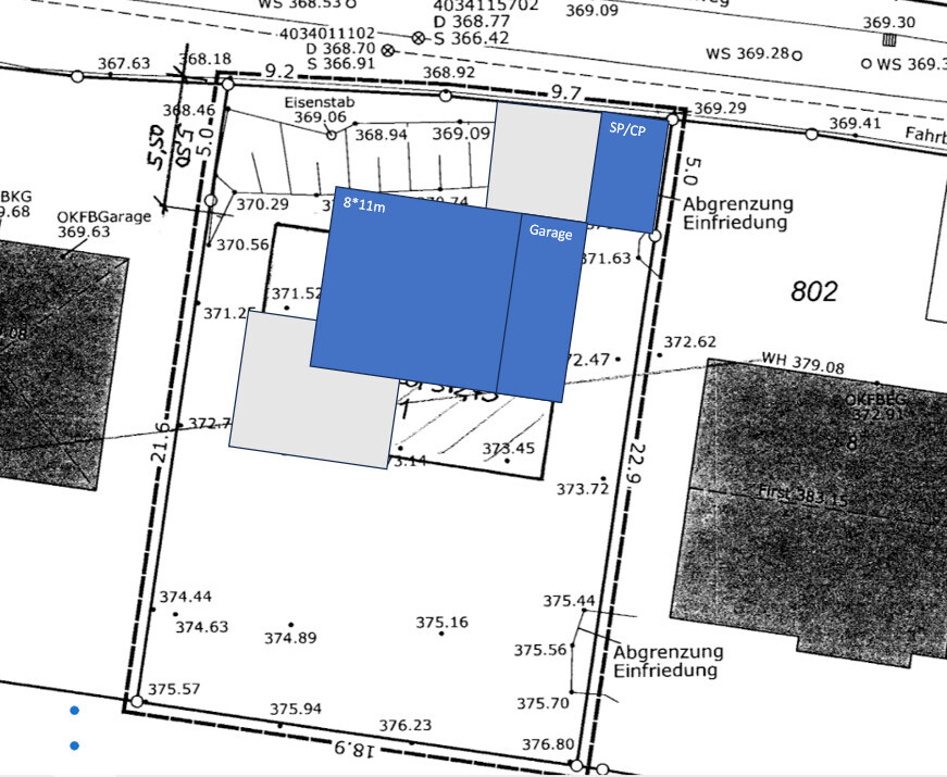

The neighbor also has the garage in the basement. Please share some pictures of the plot.
Please provide the development plan / zoning plan. With such selective information, it’s hard to make sense of it.
Wall heights in the attic are limited. That’s confusing because with a pitched roof you can’t meet those requirements.
hanghaus202325 Mar 2025 09:07ypg schrieb:
I assume there is a building boundary (see neighboring houses) Always these assumptions? Where is the zoning plan / building permit?
hanghaus202325 Mar 2025 10:26In my opinion, the garage/carport should be placed on the eastern boundary, as it is already 1.11 m (3.6 ft) higher there.
Positioning the house as close as possible to the street also helps reduce costs. Planning a narrow house design is beneficial as well.
Your driveway needs to overcome a height difference of 1.5 m (5 ft) over 5 m (16 ft). That is too steep.
