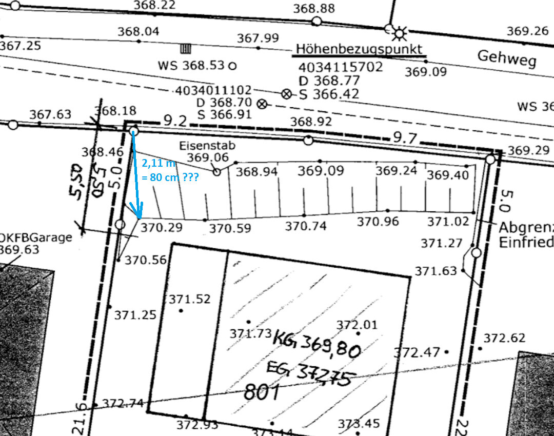

That is "Architect 3D Ultimate." However, the version is very old, from about 10 years ago.Is that the same software you use to create the purple floor plans?57Christian schrieb:
Exactly. That’s what I meant with the 20%. (80cm (31 inches) on 5.5m (18 feet)), and then another 2-3m (6.5 - 10 feet) behind the house.We probably have very different views on the heights: https://www.instagram.com/11antgmxde/
Is that the same tool you use to create the purple floor plans?Yes, in the past Avanquest used purple as their standard color. Now, I think they use a light blue instead.11ant schrieb:
We seem to have very different perspectives regarding the heights:What I mean is that the basement starts about 80 to 90cm (31 to 35 inches) above street level. The driveway and the 2m (6 ft 7 in) height difference will be excavated to accommodate this.57Christian schrieb:
Are there any major inconsistencies or things we absolutely need to change in the other version I shared? That is a huge, monster house. It fits even less within your budget. Please tell me the maximum amount you can spend all-in.

57Christian24 Mar 2025 20:35The plot is already ours. For the second house, we were quoted a turnkey price of 680,000. (650,000 is our maximum). This again excludes earthworks, additional costs, and exterior landscaping.
The entrance should be located in the basement level. At my in-laws’ place, there is a chain blocking the stairs for months due to ice and snow. Everyone, including visitors, then has to enter the house through the garage.
Driveways with a slope of up to 15% or 8.5 degrees can be managed relatively well. Beyond that, winter conditions or wearing shoes with heels make it more difficult and less practical. At my parents’ and in-laws’ houses (both have significantly steeper driveways than we do), I have slipped and fallen many times while shoveling snow or spreading salt. The car has also ended up stuck in the driveway several times.
Add a five-figure contingency on top of a turnkey price until the structural engineering report is completed and priced.
K a t j a schrieb:
The idea is that the basement starts about 80 to 90cm (31 to 35 inches) above street level. The driveway, including the 2m (6.5 feet) height difference, will be excavated accordingly. So a lowering of about 1.3m (4.3 feet) below the current terrain, which means the underground floor will be adapted to serve as the basement. This is not only a significant cost for excavation but also a notable intervention in the groundwater level. What does the soil report say about this?
