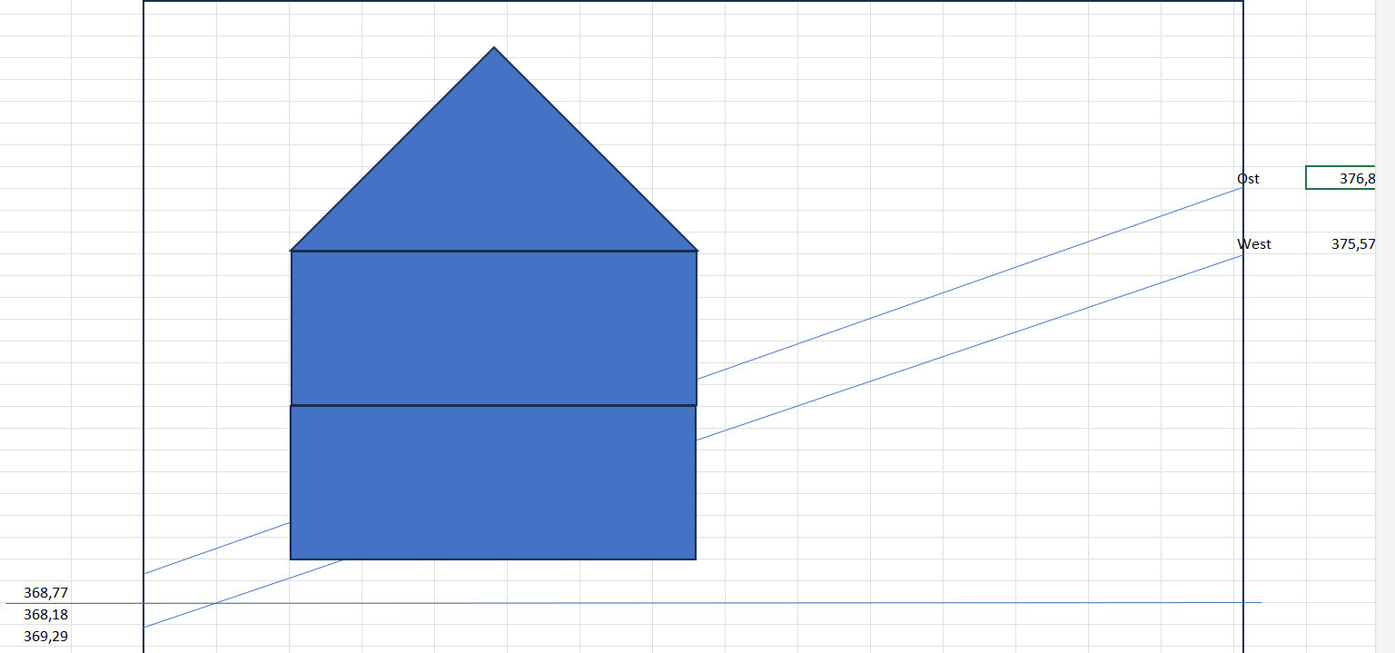

So it seems that one of us is still struggling with the elevations. If you want a terrace behind the house and another one on top of the garage, through which patio door do you plan to access the rear terrace? From the attic? Or do you intend to excavate the hill behind the house and end up sitting in a huge hole?
I sketched it out:
Assuming you place the garage in the basement and align the height with street level, then the basement would be completely embedded in the hill. Above that would be the ground floor, which would still be more than half covered by the hill. A terrace at the back would then be more accessible from the attic. (Note: these are just sketches to get a sense of the slope)
[ATTACH alt="Christian-Straßenansicht.jpg"]90914[/ATTACH]
[ATTACH alt="christian westseite.jpg"]90913[/ATTACH]
[ATTACH alt="christian ostseite.jpg"]90912[/ATTACH]
Of course, the driveway doesn’t necessarily have to be at street level. The car can handle some height difference as well. But we’re probably talking centimeters rather than meters. (Maybe someone here who’s a car enthusiast can tell us the maximum slope a vehicle can manage without scraping?)
Please correct me if I’m misreading the slope. I’m estimating a height difference of 7m (23 feet) across the property. @hanghaus2023 Could you take a look? You seem to have experience interpreting "slopes."

hanghaus202324 Mar 2025 11:5157Christian schrieb:
That should allow for a maximum of 2 or 3 meters (6.5 to 10 feet) further back.What do you mean by that? The car clears 80cm (31.5 inches) over 5 meters (16.5 feet). I think that’s already close to the limit. The ground floor is exactly at the rear (southern) ground level. The depth of the south terrace will have to be fully excavated, and the hill stabilized accordingly.

57Christian24 Mar 2025 19:29The car has to climb 80cm (31.5 inches) over 5m (16.4 feet). I believe that’s already close to the maximum. The ground floor is exactly at the rear (southern) terrain level. The depth of the south-facing terrace will therefore need to be fully excavated and the slope retained.
Well, that sounds reasonable to me, apart from the budget. Exactly. That’s what I meant with the 20% gradient. (80cm (31.5 inches) over 5.5m (18 feet)) and then another 2-3m (6.5-9.8 feet) behind the house.
