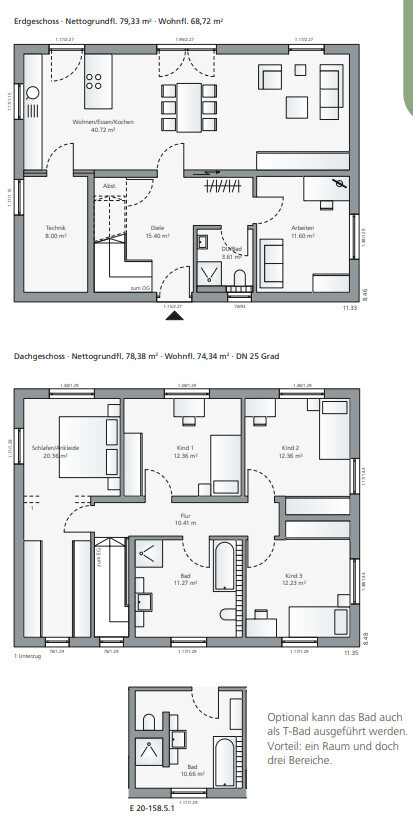

The fifth: Windows! Windows on the upper floor eaves side (that’s my assumption, hence my guess about the two-story design and the assumption that something is wrong there) … and windows on the gable side. Are they at floor level in your design? You will not be able to build or approve any of those windows like that (parapet guard 90cm (35 inches)) … Dormers in turn reduce the allowed 2/3 negatively. I’ll show you where there are problems with the parapet and upper line.Sorry, but I thought that with a hip roof or gable roof you don’t need gable walls, big sorry. The note about the parapet guard of 90cm (35 inches)—is that a general regulation? My exterior wall would be almost 1.50m (59 inches) high (That is the parapet height, right?) I wanted to do it like the picture below, only with a higher wall (like in my first draft).I thought a smaller roof pitch automatically results in a larger window area. 🙂 Thanks again for the info—is this a regional regulation or where can one find such information?
Just for @Gregor_K, a draft with three children's rooms and a study, but unfortunately without a separate apartment, which I am missing. Here, I have also adopted a few new basic principles.
Have you ever looked inside a room with a window that has a sill height of about 70-90 cm (28-35 inches), and where the window itself ends at a maximum height of 150 cm (59 inches)? You enter the room and can't see outside because the window frame—and that’s just the frame, not even the glass—ends roughly at chest level.
So you should definitely check this again and visit model homes for reference.
Koehler schrieb:
Just for @Gregor_K, a draft layout for 3 children's bedrooms and a home office, but unfortunately without a granny flat, which I personally miss.
However, I have also applied a few new basic principles here.

WilderSueden14 Sep 2022 22:09Koehler schrieb:
[IMG alt="1663180324865.png"]https://www.hausbau-forum.de/attachments/1663180324865-png.74945/[/IMG]I had a similar idea in mind once. (Is that from the Schwörerhaus catalog?) Luckily, a sales representative talked me out of it. You can only see inside through the windows, but not outside. That only works if you care about the exterior appearance. If you want something practical for yourself, either build a full additional floor or invest the money in roof windows.Ysop*** schrieb:
Apart from the fact that I also find it unfortunate to take away any say from the possible future wife -I don’t see it that critically. She will get to know him that way and then decide for or against it 😉Similar topics
