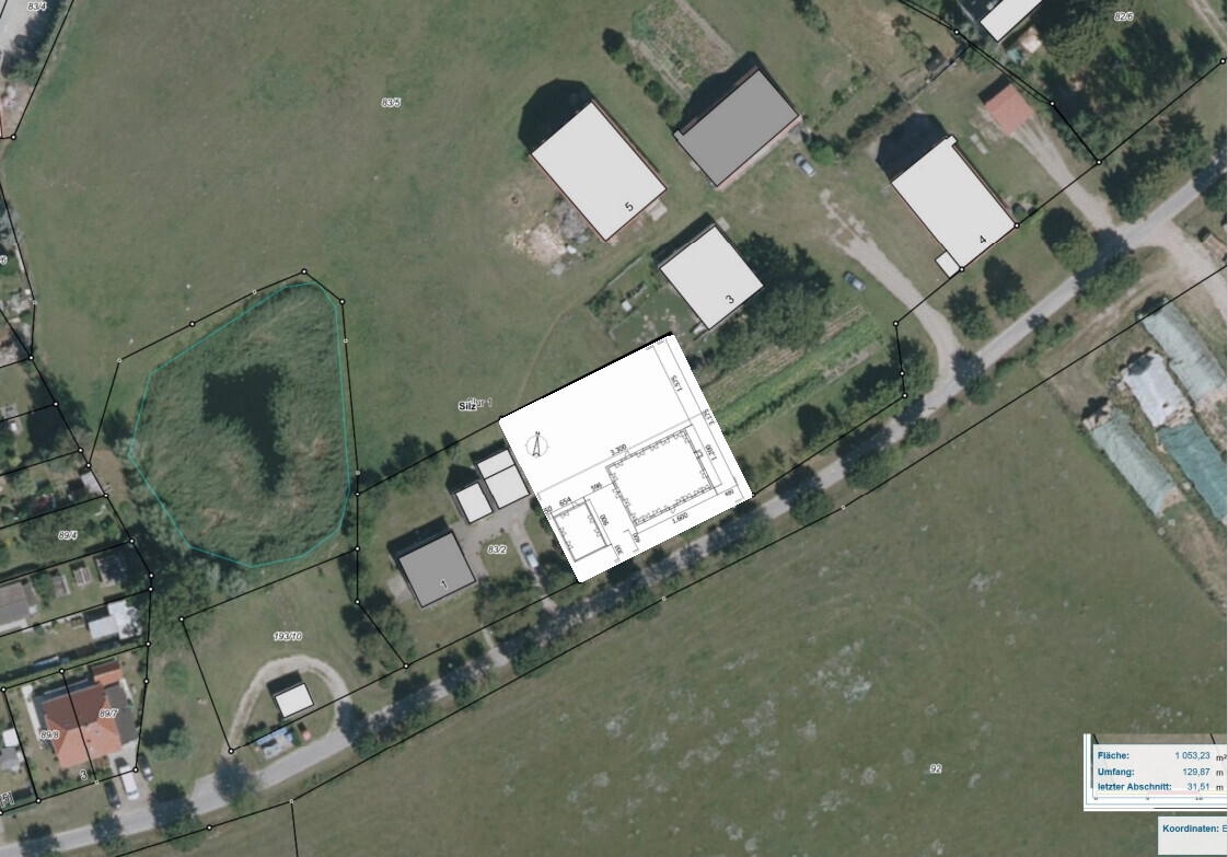

I am planning to build a house. I might receive a share of the plot from my mother if she gets her own apartment (accessory dwelling unit) on the property (our relationship is excellent so far). In any case, there should be two separate units on one plot. (Yes, financing might be challenging…)
Zoning Plan/Restrictions (Requests from the Building Authority as there is no zoning plan)
Plot size: approx. 1050 m² (given in exchange for mandatory accessory dwelling unit on the plot)
Slope: no
Site coverage ratio: no zoning plan
Floor area ratio: no zoning plan
Building setback lines, building line, property boundary: no zoning plan, but the building authority requests at least 3 meters (10 feet) setback from the street
Edge construction: maximum 9.0 m (30 feet) for garages up to 3.0 m (10 feet) height
Number of storeys: one-story with a converted attic (2/3 of the lower floor may be max. 2.30 m (7.5 feet) high)
Roof type: building inquiry was for a gable roof with two small dormers
Architectural style: no specifications
Orientation: no specifications
Maximum height/limits: 9.0 m (30 feet)
Other requirements: residential building should not be larger

Who designed the plan: do-it-yourself (myself)
What do you especially like? Why? Most walls overlap each other
What do you dislike? Why? Utility room and living room in the accessory dwelling because the living room is too small and the utility room too large
Estimated cost according to architect/planner: not yet available
Personal maximum budget for the house, including equipment: (total) 700,000 plus significant own work and family involvement
Preferred heating technology: fireplace and natural gas (available in the street)
If you had to give up, which details/extensions
-you can give up: 1. fully finished basement 2. garage 3. basement rough construction 4. pantry 5. kitchen island 6. indoor sauna 7. completed children’s room with bathroom 8. full upper floor finish
-you cannot give up: fireplace in both apartments

What is the most important/basic question about the floor plan, summed up in 130 characters?
  • Any fundamental mistakes in the plan?
  • Can the utility room be moved to the attic (not the converted attic)?
  • Garage directly on the property line?
  • Is (partial) basement with bathtub and/or garage financially feasible?

Aerial view of a plot with overlaid floor plan of the house

The orientation with the garage in the southwest is questionable. Has any site planning even been done or was it skipped? Where are the terraces? They aren’t included in the plan at all. Orientation of the rooms, entrance court, terraces, their integration, division of the property into two private areas... everything looks slapped on.
I have little experience with the grid used by the software, so I can’t judge the design itself. However, the walk-in closet stands out negatively, as does the too-small technical/laundry room, dark dining area with no windows, and a dark kitchen in the separate apartment. Many rooms’ sizes will inevitably create lots of dark areas in the middle of the house.
A somewhat larger Google Maps screenshot would be useful since you need to adapt to neighboring buildings.
I’d probably rotate the house, put a shed and terrace of the separate apartment in the back, the garage in front, driveway on the east side, and then terrace and garden in the southwest for the main unit. Then the house planning can begin properly.
Thank you very much for the comment about empty rooms — I expected that. The basement is filled only with placeholders because I don’t necessarily need it but would like to have it to reduce the load upstairs a bit: two offices, one hobby room for me and one for my wife, sauna, bathroom, relaxation room, storage, gym, laundry room, pantry, etc.
Regarding your four points concerning two of my questions, I would like to sincerely thank you. That’s very tough but honest criticism. At least now I know that I won’t build a basement or garage at first due to financial improbability. Thanks — I welcome this kind of comment, no matter the direction.
I have added a larger excerpt of the site plan image for the outdoor layout; there is no terrace planned yet (financial reasons), and for now everything will remain green. Later, we’ll see where we spend time the most. Small terraces were initially planned behind the house and between house and garage but will come much later.

Aerial view of a plot area with multiple buildings, parcels, and a construction plan in the center.
