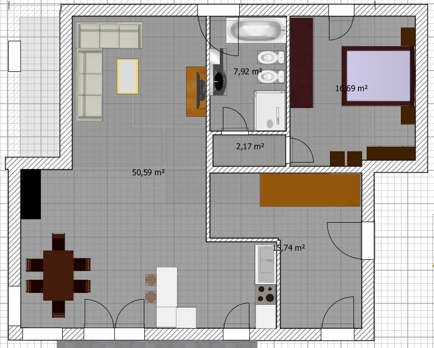

So, I have now tried a different layout. Thanks ypg. Please note that this is just a rough draft and many details are still missing. The purpose is to see if this could be a sensible and expandable arrangement:
Ground floor
Floor plan of an apartment: open living/dining area, kitchen with island, bathroom and bedroom.

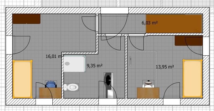

Upper floor
Floor plan of an apartment with two bedrooms, bathroom, hallway and furniture.
Advantages:
  • Ground floor is spacious
  • Separate guest toilet or pantry, or both, possible
  • Sleeping area nicely separated with its own bathroom
Disadvantages:
  • Upper floor is very fragmented; the layout is not harmonious at all. Also, we wanted two equally sized children’s rooms
  • Office/guest room in the basement (but this is not a big issue)
  • The path from the master bedroom to the children’s rooms is very long and involves many turns. We currently have a 4-year-old daughter and another on the way. A direct route to the children would be nicer. But probably you can’t have both a secluded bedroom and good access to the kids
The main dealbreaker for me is actually the upper floor layout—it just doesn’t work in my opinion. What do you think about this option?
11 Apr 2014 21:01
zovima15 schrieb:
That is only 4.15 m (13.6 ft)
For the staircase, there are about 6 meters (19.7 ft) to be accommodated.
In the newer version, some things are still off, but I prefer the room layout overall. An L-shape for the living and kitchen area is always nicer than a rectangular room. Where would the utility room or additional room be now? On the hallway side?
Still: the kitchen has too little workspace, and the upper floor is not acceptable, as you yourself noticed...
Just as a thought: the staircase could theoretically be placed along the kitchen wall now, with a quarter turn. Then you would have a more suitable room upstairs. The kitchen could be moved toward the dining area.
But: the current staircase seems too short to me! Plan at least 3.70 m (12.1 ft) in length!
What is the knee wall height planned for the upper floor?
Regards, Yvonne

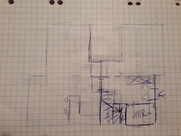

I have moved the staircase further again...
In our case, as you can see from the staggered floor levels, the staircase runs within the roof area of the lower roof...
Handgezeichnete Grundrissskizze eines Hauses mit Räumen auf kariertem Papier
Handgezeichnete Grundriss-Skizze eines Hausgrundrisses auf kariertem Papier.

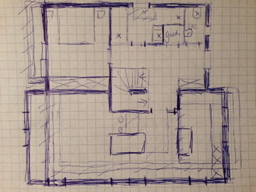

11 Apr 2014 22:32
Wanderdüne schrieb:
I believe you.
Suggestion: Stop posting creepy DIY design attempts and spend that saved time working at a fast-food restaurant of your choice. With the money plus tips, hire someone who has actually studied design.
WD
@ WD: You can probably learn nicer ways to communicate working in a fast-food restaurant
@Zovima: The sketches were made while preparing cabbage rolls. Still, sometimes even unplanned sketches can inspire ideas.
Maybe consider allowing the upper floor above the front door to extend outward by about one meter (3 feet)... this would create a canopy and add interest to the elevations. I can’t comment on the costs.
Enjoy experimenting!

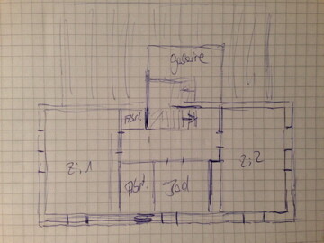

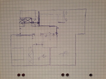

12 Apr 2014 00:25
Hand-drawn floor plan sketch of a house with several rooms.
Hand-drawn floor plan sketch of a house with room layout
I rearranged the rooms again... unfortunately just with a pen... and without knowing the building envelope or budget limits... of course, it needs revision, but perhaps it might serve as some inspiration?
The size can certainly be adjusted somewhat...
