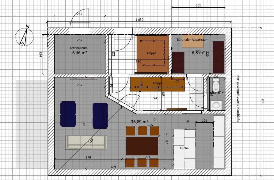

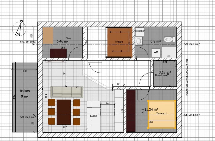

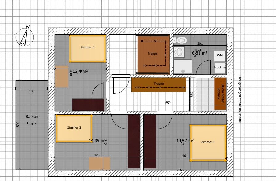

smartsurfer8529 Sep 2022 23:42Due to personal circumstances, my project was put on hold, and now I want to resume it.
In the meantime, I have also come up with a new floor plan: two separate, self-contained apartments within a semi-detached house.
This means the “granny flat” moves to the attic, living spaces are on the ground floor and first floor, and there is still no basement.
That also explains the two staircases: one enclosed stairwell for the main house entrance and access to the attic apartment, and a second staircase connecting the ground and first floors into one living unit.
The external dimensions are now larger, but the previous floor plans didn’t really work out anyway. Still, with 8.35m (27 feet 5 inches), it remains within the lot width.
Here is the ground floor (GF)
The kitchen is shown as an example with cabinets as placeholders. Due to space considerations, the two doors for the WC and storage room open outwards (better usable space).
The first floor (FF) with the rooms:
Here I optimized it to have as much closet space (= storage) as possible.
And the attic floor (AF) with the separate apartment:
For the attic floor, it is still difficult for me to estimate how high the knee wall can be and where the roof slope will be, which will affect the need for dormers. I hope the neighboring buildings are tall enough to allow a knee wall of about 1.20m (4 feet).
The kitchen is again shown with cabinets as placeholders.
What do you think about the individual levels?
Do you have any suggestions for improvement?
I consider a common room just under 3 meters wide (3.10) with a staircase measuring 3.10 meters in length and 80 centimeters (31.5 inches) in width hardly worth discussing. A staircase in the plan, assuming a standard ceiling height, should have at least 3.70 meters (12.1 feet) in length and 90 centimeters (35.4 inches) in width. For amateur designs, even more. (This criticism also includes other narrow spots in this plan)
As long as it remains unclear what the building authority requires from you, the discussion is, in my opinion, pointless. Section 34 does not mean you can build whatever you want. First, clarify how much area you are allowed to build on your 500 m² (5,382 ft²) plot and how many housing units are permitted. Also, be sure to check the required number of parking spaces. After that, I would recommend verifying whether the utility providers can supply the necessary services and which other conditions must be met (e.g., fire protection, fire department requirements).
Only then can you start thinking about floor plans.
The plot is 15 m (49 feet) wide, and your house is 8.35 m (27.4 feet) wide, so there is exactly 3 m (9.8 feet) distance to the neighboring property on both the north and south sides.
And now there are supposed to be 4 residential units?
The building depth of your two semi-detached houses is now just over 20 m (65.6 feet). Additionally, there is at least a 3 m (9.8 feet) setback to the east boundary and about 6 m (19.7 feet) depth for parking space to the west. This leaves only about 4 m (13.1 feet) of garden between the parking area and the house on the west side.
The floor plans themselves don’t work. Yvonne has already mentioned the internal staircase. But the staircase in the stairwell with a floor area of approximately 180 x 225 cm (5.9 x 7.4 feet) also doesn’t function properly. It will become steep and narrow, and furniture needs to be moved to the top floor through it.
Your drawn-in furniture highlights the tight spots in the rooms.
Bedroom beds on the top floor with head clearance below 2 m (6.6 feet)… that’s not feasible.
After subtracting the stairwell, walls, and areas with ceiling height under 2 m (6.6 feet), the top-floor apartment will have, at best, just under 60 sqm (645 sq ft) of usable living space.
Are you only reading your own thread? Otherwise, you shouldn’t have missed the example from @MarlenP. You’re currently trying to replicate this discouraging example (simplified just for the brother). If you want to stick with your current concept, I recommend a solution with only one staircase (the trick would be the granny flat on the ground floor and the maisonette then on the first and attic floors). If you decide to switch back to the previous concept, you can find suitable inspiration with @MadameP, even though your plot is not a corner lot.
P.S.: I just realized that the floor plans shown are only for one half, and you want to squeeze four residential units onto the small plot. However, that won’t work. Only the currency was changed from DEM to EUR, but the square meter still counts as 10,000 rather than 5,113 square centimeters. I don’t see your desired calculation working out in this respect. As much as you want to benefit from the market level in your area, you won’t become a real estate tycoon with this small plot of land. The original builder back in 1961 had realized this. Increasing density beyond a single-family home might be possible, but the plan for a double multi-family building is definitely too ambitious.
