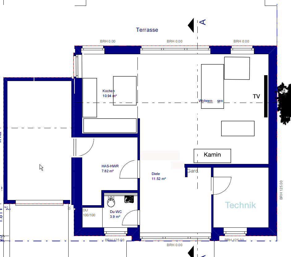

Questions we have:
- The utility/technical room with 8m² (86 sq ft) will probably be too small, I assume. Where could space be saved? Controlled ventilation/heating, washing machine, our small current kitchen (along the wall on the right when entering, could be “shortened” accordingly) and a drying rack should fit there.
- Do you have a better idea for the position of the fireplace? Between the two windows seems a bit tight. We would actually prefer the wall opposite, but then the chimney does not fit with the room layout upstairs.
- Is the entrance area possibly too narrow, or is there another way to place the stairs? We would actually like to place the front door in the center, but then according to the plan the stairs are in the way.
If any more information is needed, just let me know.
We look forward to your comments!

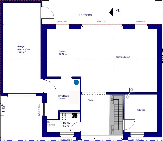

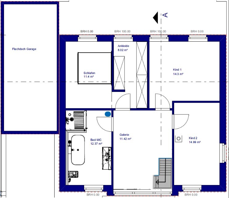

We have also been thinking more about the current plan. Keep it up. The more you free yourselves from the model house as a "framework" for your planning, the better. Try to identify the aspects of the model that truly fascinate you and use them as inspiration. Copying the entire design and just making some areas a bit narrower here and there or shifting the fireplace is not a "recipe for success."
Have you looked into the serious suspicion regarding the right-side building line?
Unfortunately, the living area will be quite tight in terms of width, and the kitchen space is rather small.
With a house width of 10.12 m (33 feet), the interior width is probably around 9.3 m (31 feet).
Kitchen with island about 280 cm (110 inches)
Table, allowing enough space to walk through properly, about 350 cm (138 inches)
Remaining space to the right approximately 300 cm (118 inches) from the back edge of the sofa to the right exterior wall.
I’m still not quite sure how the staircase is supposed to run.
Regarding the door between the garage and utility room: I would consider leaving it out, but if it is included, we should think about its purpose. For example, bringing groceries directly into the house from the trunk. Since the garage is not very wide (bicycles and other items will also need to be stored somewhere), the door should probably be relocated further inside. This also has the advantage that the upper wall of the utility room can be used more effectively.
As a starting point, I find the reversed Maxime 300 useful; the utility/technical room would then be without garage access.

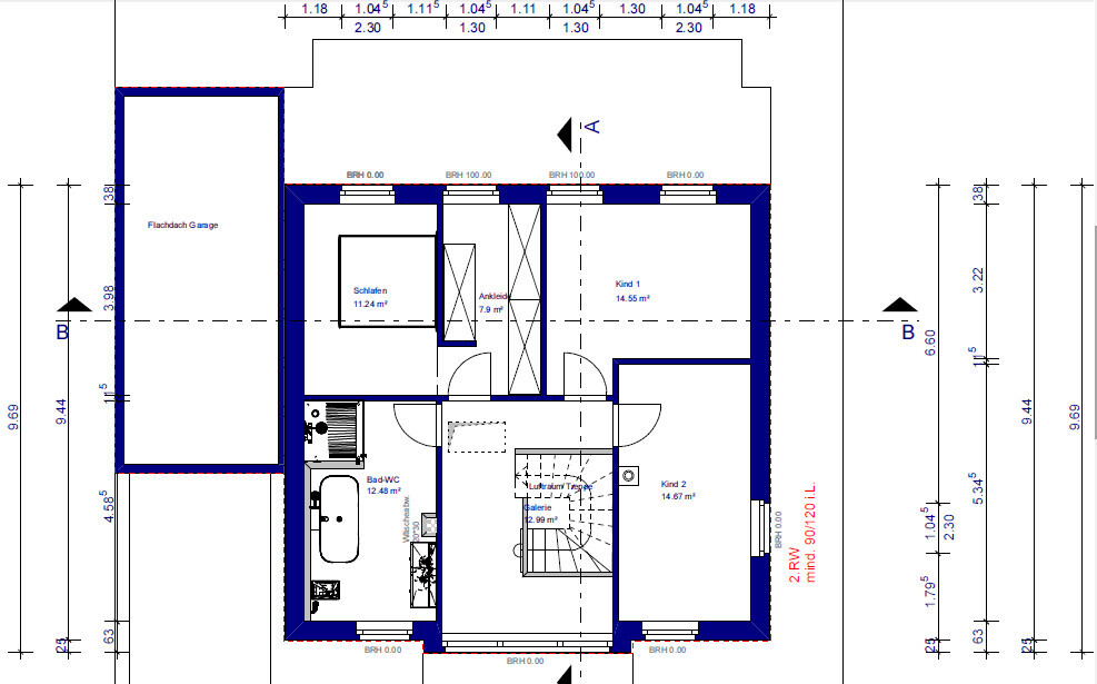

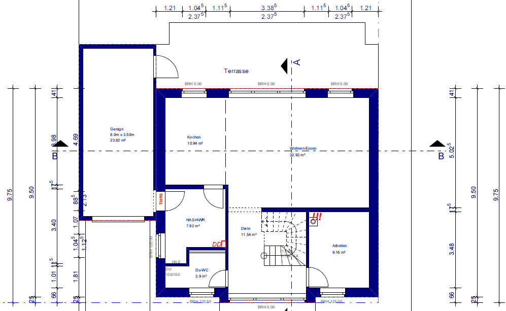

thank you again for your support. Last Tuesday, we had another meeting with the architect. We had sent him our improvement suggestions as attached. He then tried to incorporate them as best as possible. Unfortunately, we are still not satisfied with the staircase. Do you possibly have 1 or 2 ideas on how to best position the staircase? With our proposed solution, the door to the study no longer works. If we were to move this door, for example, into the living room, I worry it would disturb the nice wall with the fireplace. Otherwise, what bothers me about the staircase is that it might overwhelm you immediately when you open the front door. I’m hoping for more ideas from you. Many thanks!
