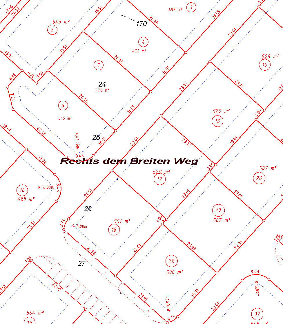

Plot size: 529 sqm (Plot 17 see attachment)
Slope – slight gradient across the plot approx. 80 cm (31 inches)
Floor area ratio – 0.4
Building envelope, building line, and boundary – see attachment
Edge development – permitted

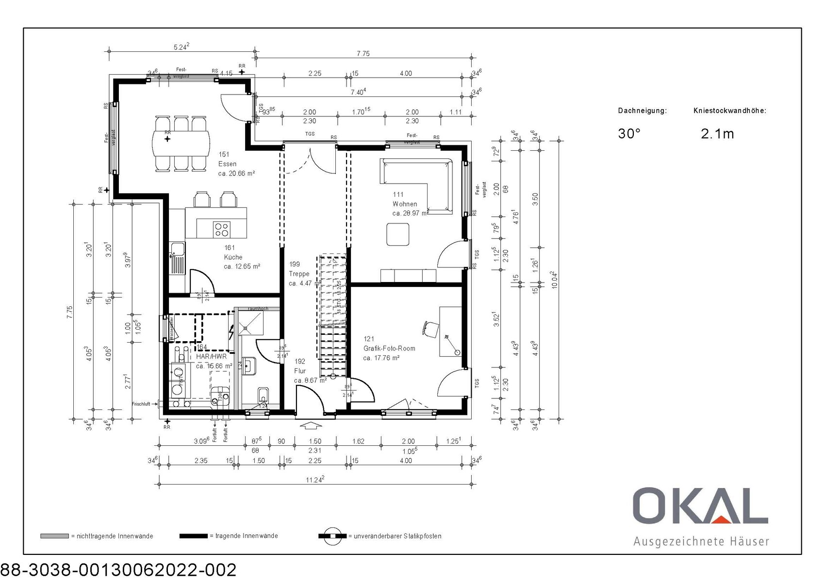

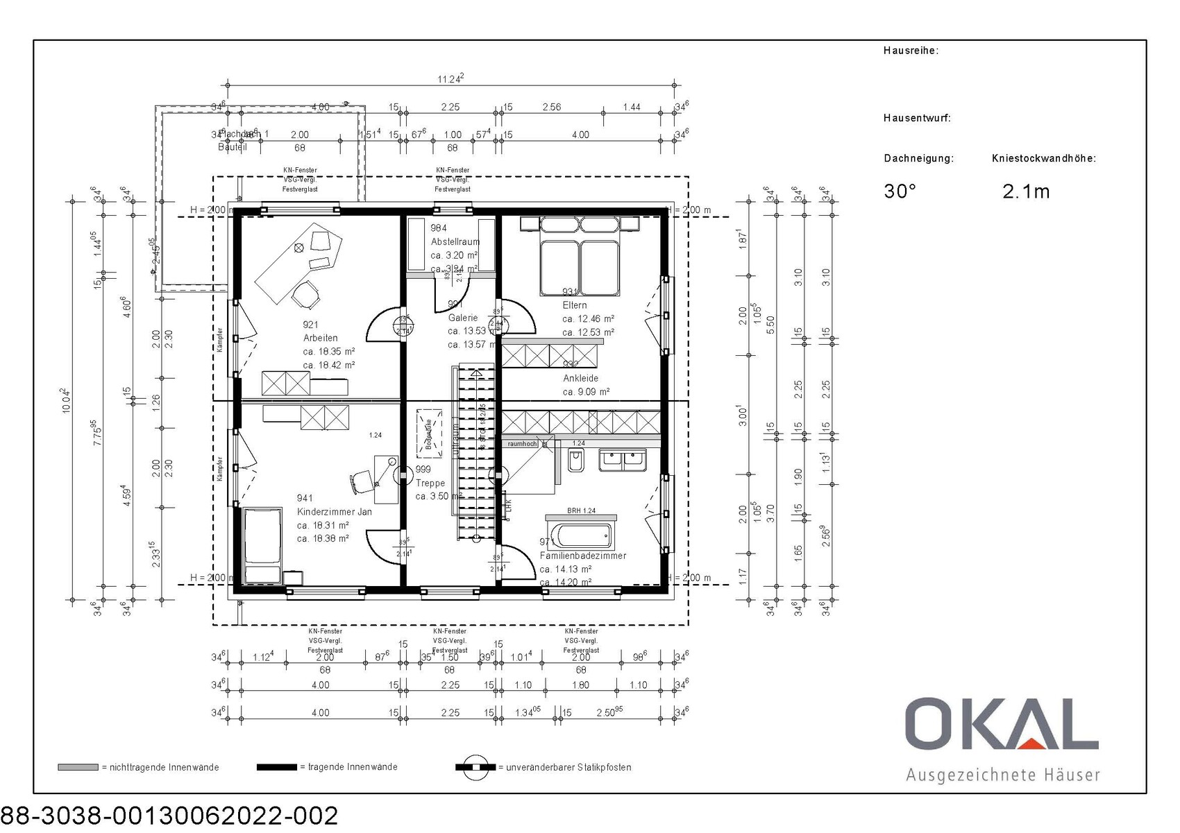

This is a first draft. Changes already clear: utility room and guest room will be “rotated” so doors face the entrance hall. Partition wall in the master bedroom removed. Rooms upstairs mirrored. Kitchen not fully shown on plan but will use full available space. Staircase to be built closed with closed storage underneath, and moved slightly backward. Main questions: Is the floor plan fundamentally sensible? Is too much space “wasted,” and if so, where? How can we create a more spacious entrance area with a wardrobe option?

Myrna_Loy schrieb:
On the ground floor, I definitely find the original layout more practical than the living hall with an unnecessary kitchenette. I also think it works better. Consider swapping the utility room and WC, and adjust things a bit to make room for a wardrobe.
I prefer your design—with a few changes on the ground floor along these lines:
If the utility room becomes too small, the kitchen will need to give up some space, but in my opinion, that should be manageable.
The hallway might be a bit narrow—maybe it could be allowed a few more centimeters and the entire layout on the right side of the ground and upper floors made slightly narrower. Well, and the bathtub on the upper floor is obviously not ideal, but that has already been corrected.
K a t j a schrieb:
If the utility room ends up too small, the kitchen will have to give in a bit, but in my opinion that should be doable.
The hallway might be a bit narrow – … if you also remove the wall between the kitchen and hallway, there will be enough space for a properly larger kitchen island.

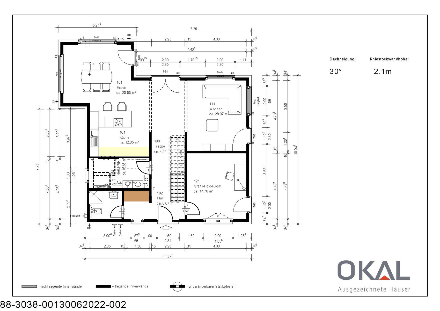

häuslebauer2313 Jul 2022 11:16K a t j a schrieb:
I prefer your design—with a few changes on the ground floor roughly along these lines:
[ATTACH alt="EG-mit GArderobe.jpg"]73291[/ATTACH]
If the utility room becomes too small, the kitchen will have to give up a bit of space, but in my opinion that should be doable.
The hallway might be a bit narrow—maybe it could be allowed a few extra centimeters (inches) and the entire right side of the ground and upper floors made slightly narrower. Well, and the bathtub on the upper floor is obviously not ideal, but that has already been corrected. Thank you very much for the suggested changes; this is exactly the input we needed, and we also appreciate the effort you put into drawing it up!
The kitchen window would then face toward the carport—but yes, better than no window at all, so we would plan for that. And a window in the guest bathroom as well.
häuslebauer23 schrieb:
And a window in the guest bathroom then.Yes, I forgot. 🙂 I’m not quite sure whether an outdoor unit for the heat pump or some other pipes were supposed to be planned next to the front door. If necessary, the utility room and the guest bathroom/vestibule will have to swap places.
