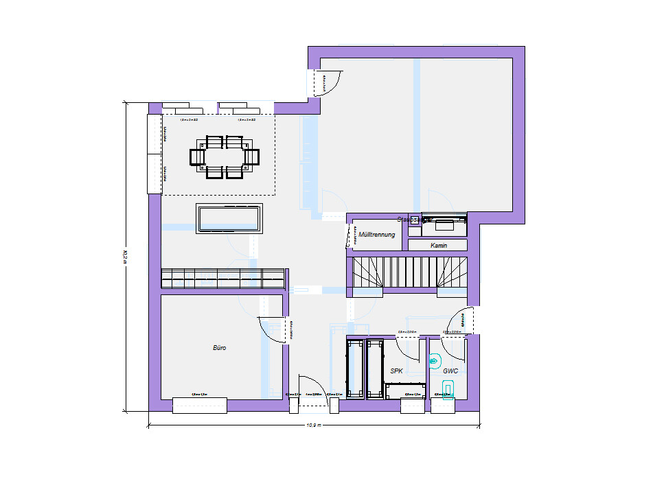

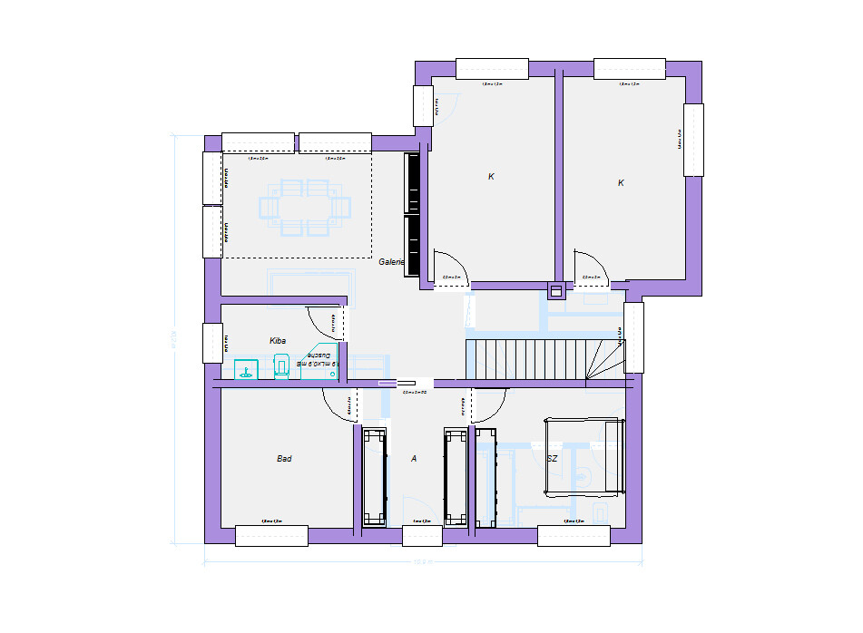

I’m only moderately satisfied with our floor plan because the relatively square staircase causes the surrounding rooms to become quite awkwardly shaped. I’ve accurately transferred the floor plan into a program and created an alternative. Essentially, the alternative floor plan is more open, and with the staircase being more elongated, the rooms are less compartmentalized. I don’t want to burden the architect with many more changes that might not be implemented. Therefore, I ask for your understanding that I cannot provide the architect’s drawings for this alternative. We could definitely consider the concept of a staircase integrated into the living area. I know this might not be an option for many. I would really appreciate your opinions on this or perhaps suggestions for changes.

We adapted the standard design to meet our needs. It was especially important that the rooms upstairs be as large as possible, and the hallway area small. That’s why we had to choose a smaller staircase. Since our plot is a corner lot and quite tightly built around, we planned an open space in the corner. This space is basically oriented toward the center of the gardens of the housing block.
Basically, I would like to know what you think of the alternative I created. Do you perhaps have other ideas? We have already submitted the building application, as timing is an issue in Cologne. We will probably have to submit a change later because the window in the office should be larger and the window in the pantry removed. In principle, it would also be possible to modify additional windows. On the street side, we would like to maintain symmetry.

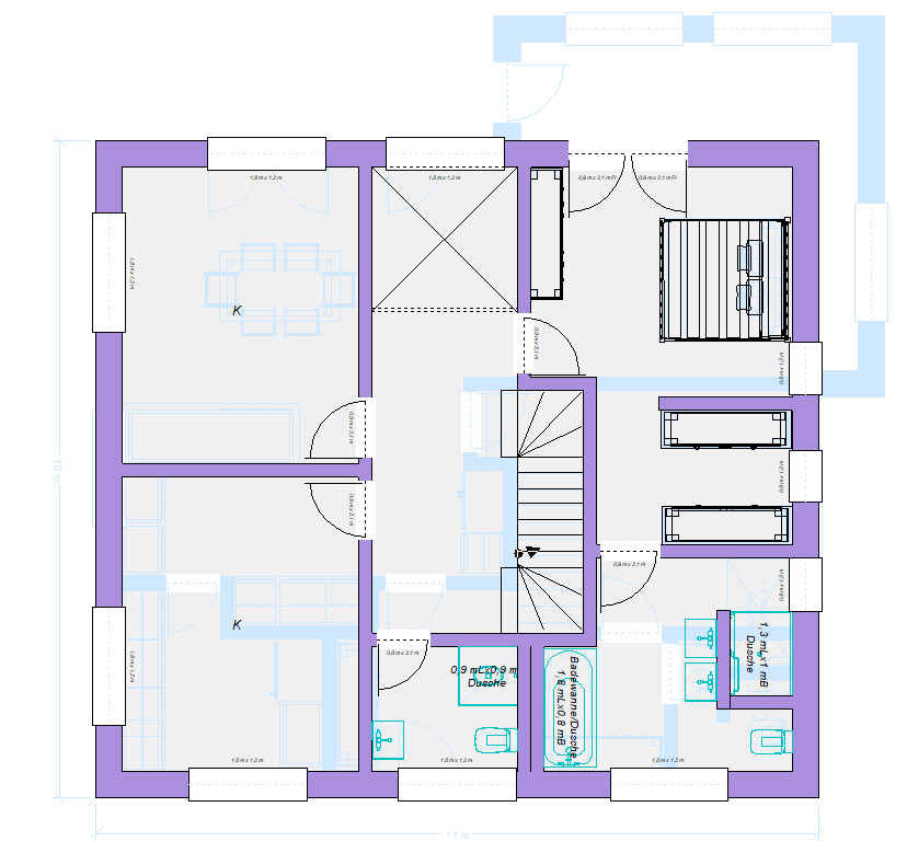

Hausprojekt3515 Aug 2022 16:05Würfel* schrieb:
If the exterior is to remain unchanged and only one or two windows are to be relocated, you might also consider a quarter-turn staircase (basement stairs straight). This creates a tidier layout, with the children's bedrooms and bathroom becoming larger, while the master bedroom gets smaller (which I find unbalanced in your case). The upstairs hallway becomes nicely bright instead of a small dark space. The entrance area feels more welcoming, and there is more room for the kitchen, dining area, and pantry.

Hausprojekt3515 Aug 2022 16:07ypg schrieb:
But the toilet is used more often than the shower, so natural daylight is more useful at the toilet. Katja already marked that correctly. An L-shape instead of a T-shape would be optimal.What would the L-shape solution look like? So no more protruding wall in the WC area?
Hausprojekt35 schrieb:
What would the L-shaped solution look like? So, no more protruding wall in the toilet area?Exactly. The toilet will be rotated to provide more legroom. The shower will be lengthened to prevent water from splashing outside.Hausprojekt35 schrieb:
What would the L-shaped solution look like? So no longer a protruding wall at the toilet?ypg schrieb:
Yes, exactly. The toilet will be rotated for more legroom. The shower will be made longer to prevent splashing.Although this topic seems to have been discussed extensively already, here is the intended version with the window extension for better understanding: H
Hausprojekt3516 Aug 2022 16:24K a t j a schrieb:
Although this option seems to be outdated, here is the intended version with the window extension for better understanding:
Now, another thought: Since the toilet is used more frequently, wouldn’t it make sense to swap it with the shower? Then a small window with an appropriate sill height could be installed above the toilet. This way, you don’t have to walk around the corner at night:
