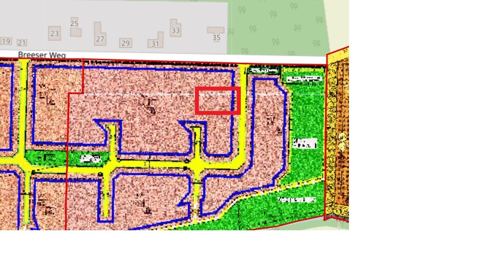

Plot size: 1231 sq m (13,250 sq ft)
Slope: 40 cm (16 inches) descending to the south
Floor area ratio: 0.3
Building window, building line, and boundary: see attachment, red box approximately marks the plot

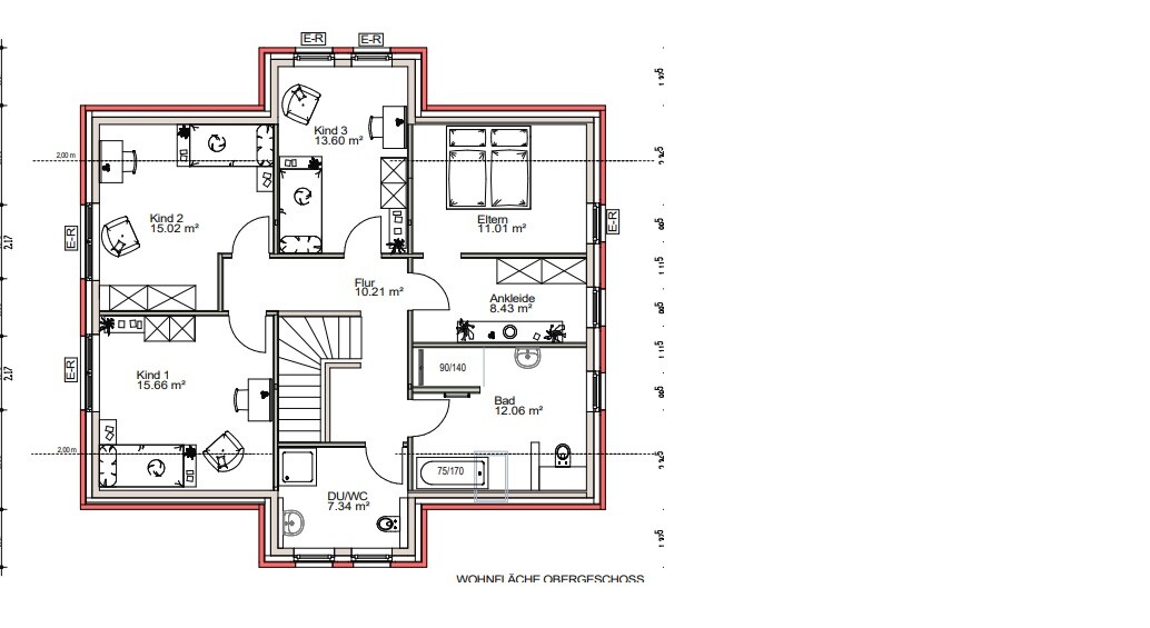

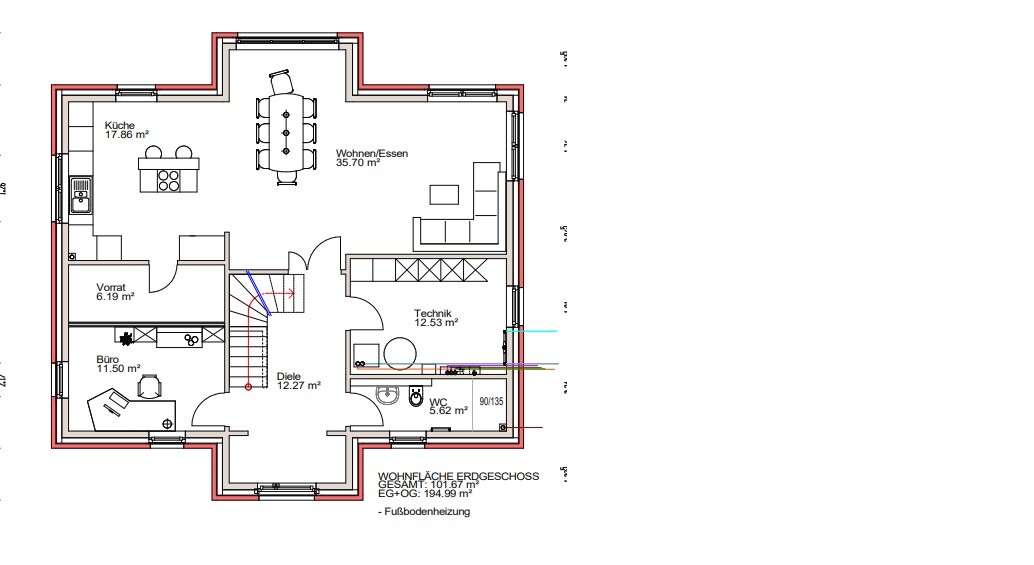

The plan is a first draft. The door to the master bathroom upstairs is not practical in the hallway; access from the dressing room is preferred. Originally a directly connected double garage to the utility room was desired, allowing direct access from the garage into the house. The main entrance side should face north (top of site plan). The double garage should originally be at least 70 sq m (750 sq ft) for hobby cars.

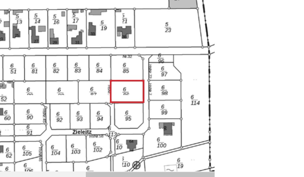

Maverick2312 Jul 2022 12:26ypg schrieb:
From which side is the plot accessed and reached? Southwest or east? From the east.
kbt09 schrieb:
Unfortunately, very few or no dimensions are visible, and neither how the house and ultimately the garage will be positioned on the plot. Is the site plan aligned to true north? Exactly, the plan is aligned to north. The exact positions of the house and garage have not yet been decided.

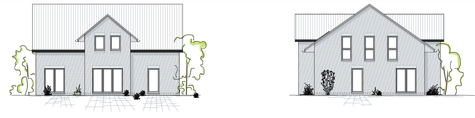

K a t j a schrieb:
I find the floor plan okay. I would give the guest toilet downstairs a bit more depth and make the utility room slightly narrower instead. I would also take another close look at the bathroom layouts, and you should start planning the kitchen as well.
The key question is, how is the house situated on the plot, where is the driveway, and where are the parking spaces? Access (front door/driveway) from the east would be ideal. Otherwise, it could get tricky. We use the utility room for laundry and storage. My wife thinks it’s a bit too small. The front door is planned to face north, and the driveway will be on the east side. In the southwest, there will only be a garden access path.
Thanks for your responses.
I see a west-facing orientation with the entrance on the east much more clearly here. This way, you have a view of the garden in the west, where the children play. In addition, the children’s rooms are located in the south plus one in the west, placing them in the brightest spots.
Maverick2312 Jul 2022 13:08kbt09 schrieb:
Are there any measurements of the plot ... and if you have already decided on the house entrance facing north ... then you must have considered the position of the house and garage. Yes, of course: approximately 43m long (north and south sides) and about 29m wide.
We haven't decided exactly where the house will be located yet. The idea was to approach the property from the east and be able to drive directly into the garage (garage door facing east).
WilderSueden12 Jul 2022 13:12Maverick23 schrieb:
We haven’t decided exactly where the house will be located yet. But that is important, because only then can you determine whether a floor plan makes sense or if you’re planning a window right against the garage wall. Take a large sheet of paper and draw the plot to a scale of 1:100. Then create scale-appropriate templates for the house (make sure to include windows), garage, terrace, garden shed, etc., and experiment a bit to see how different layouts work. You can then share the results here.
