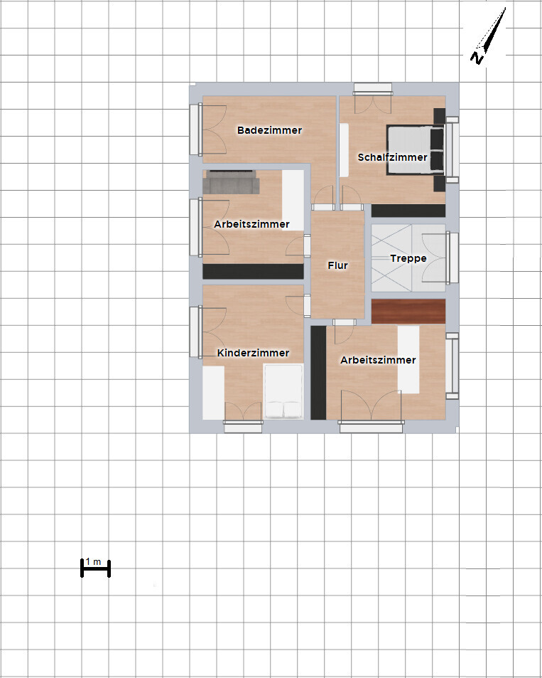

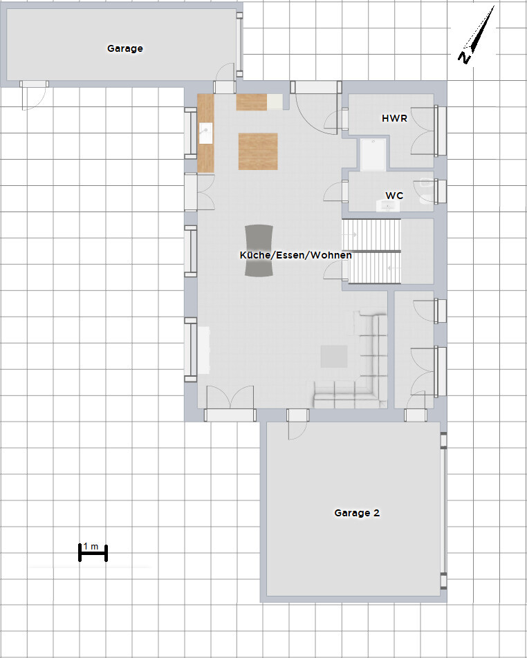

After a long and more or less intensive search, I have a plot of land in sight that fits quite well into our search criteria regarding location and orientation.
At around 500m² (20m x 25m (66ft x 82ft)), the plot is not exactly large. That’s why we have now created initial sketches to see if our ideas and wishes can be reconciled with the size of the plot. The floor plan is based on our first ideas and personal needs. Since we are both in our late 20s and still live in a condominium, we probably haven’t thought of everything yet?
We look forward to your opinions! Please feel free to be very straightforward.

What do you think of the floor plan? What are absolute no-gos from your point of view? What have we overlooked? (Also regarding children)
Info about the first sketch:
Above is a neighboring house
Below and to the left are fields
To the right is a small street
Edit: location of the plot uploaded. (North is at the top)

Matthew0330 Aug 2018 11:53KEVST schrieb:
We look forward to your opinions! Straightforward feedback is very welcome Gladly
Quick thoughts:
All-purpose room = gymnasium
Where is the TV?
Guest bathroom too large
Utility room too small
Room behind the sofa?
Entrance area = none = where is the coat storage?
Hi,
an open entrance area like that wouldn’t really be my preference. You’d end up bringing street dirt directly into the living space. The coat storage will also need to be somewhere near the front door. I’m not sure I’d want to look at a pile of shoes and jackets from the dining table.
The living room will be very large, so the distance to the TV will be quite far. Try arranging the other furniture in the living room to see how it all fits together.
Is there a door from the living room leading to the garage?
I imagine it will be difficult to fit a shower, bathtub, double sink, and toilet into the upstairs bathroom. Could it be an option to use a room as an office for both of you? One room could be a bit bigger, leaving more space for the other rooms.
Alternatively, you could move the office to the ground floor, remove the small storage room behind the living room, make the living room a bit smaller/narrower, and then try to include a study/workroom in that area.

Garages do not have to maintain a setback from the property boundary but are limited to a total length of 15m (49 feet) on one property. Since your garages have a combined length of 9m + 3m + 7m = 19m (62 feet) and are located less than 3m (10 feet) from the neighboring boundaries, a building encumbrance agreement with a neighbor would be required.
In some cities, having two driveways or three garages may not be permitted.
Is there a development plan / zoning plan?
