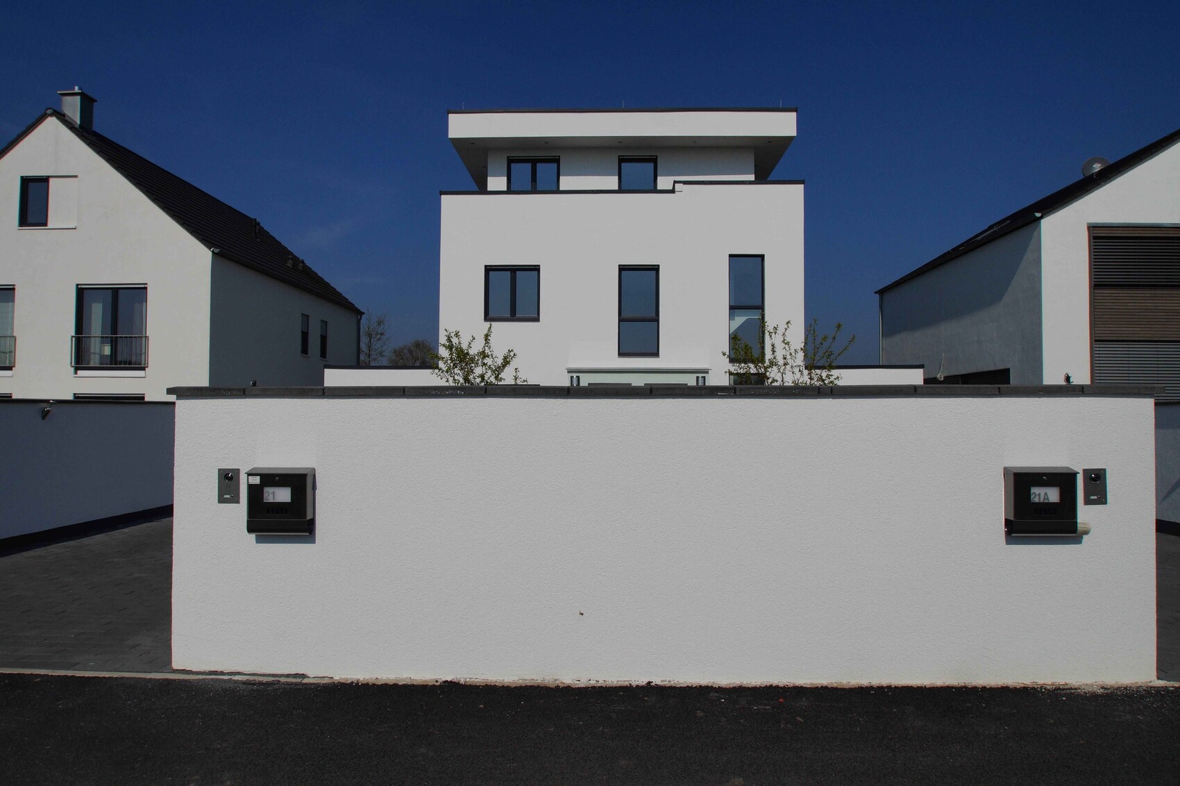

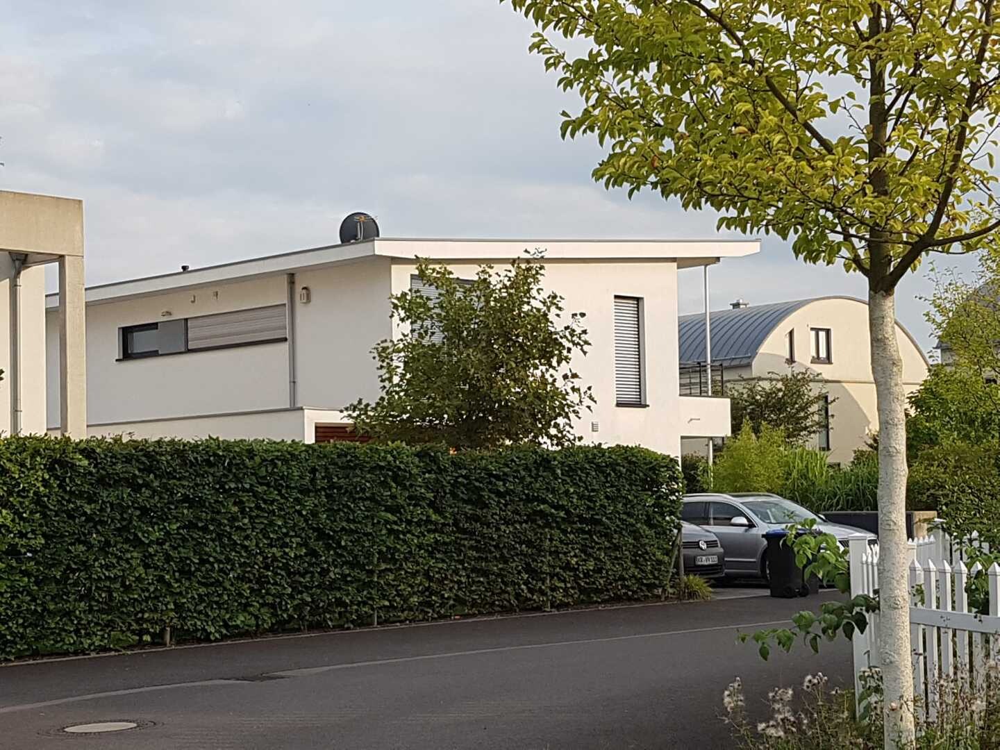

The first set of images shows how we are currently renting our living space (on the first floor and the split-level basement). Just to give an idea...

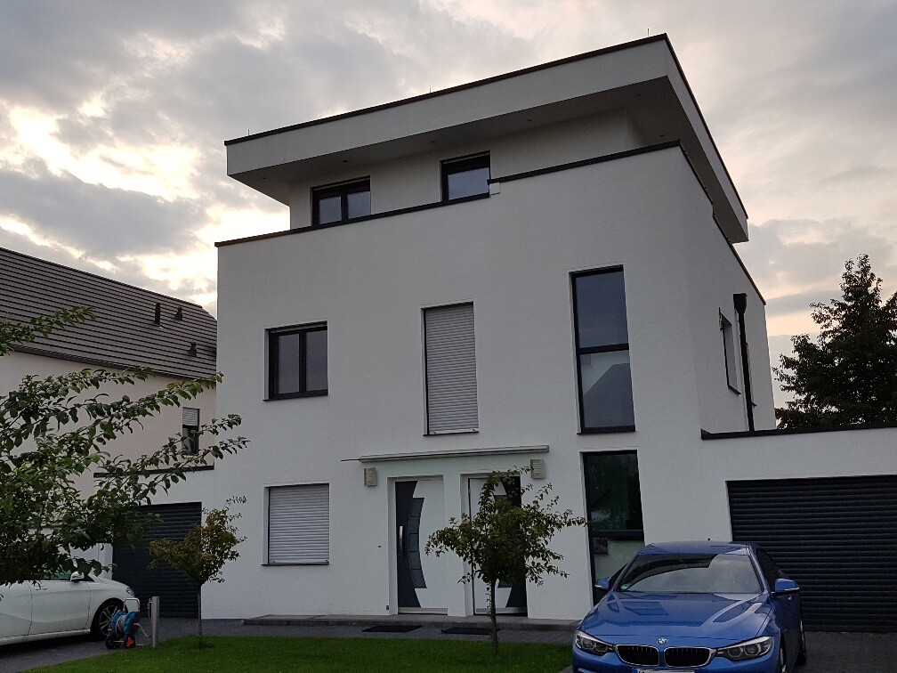

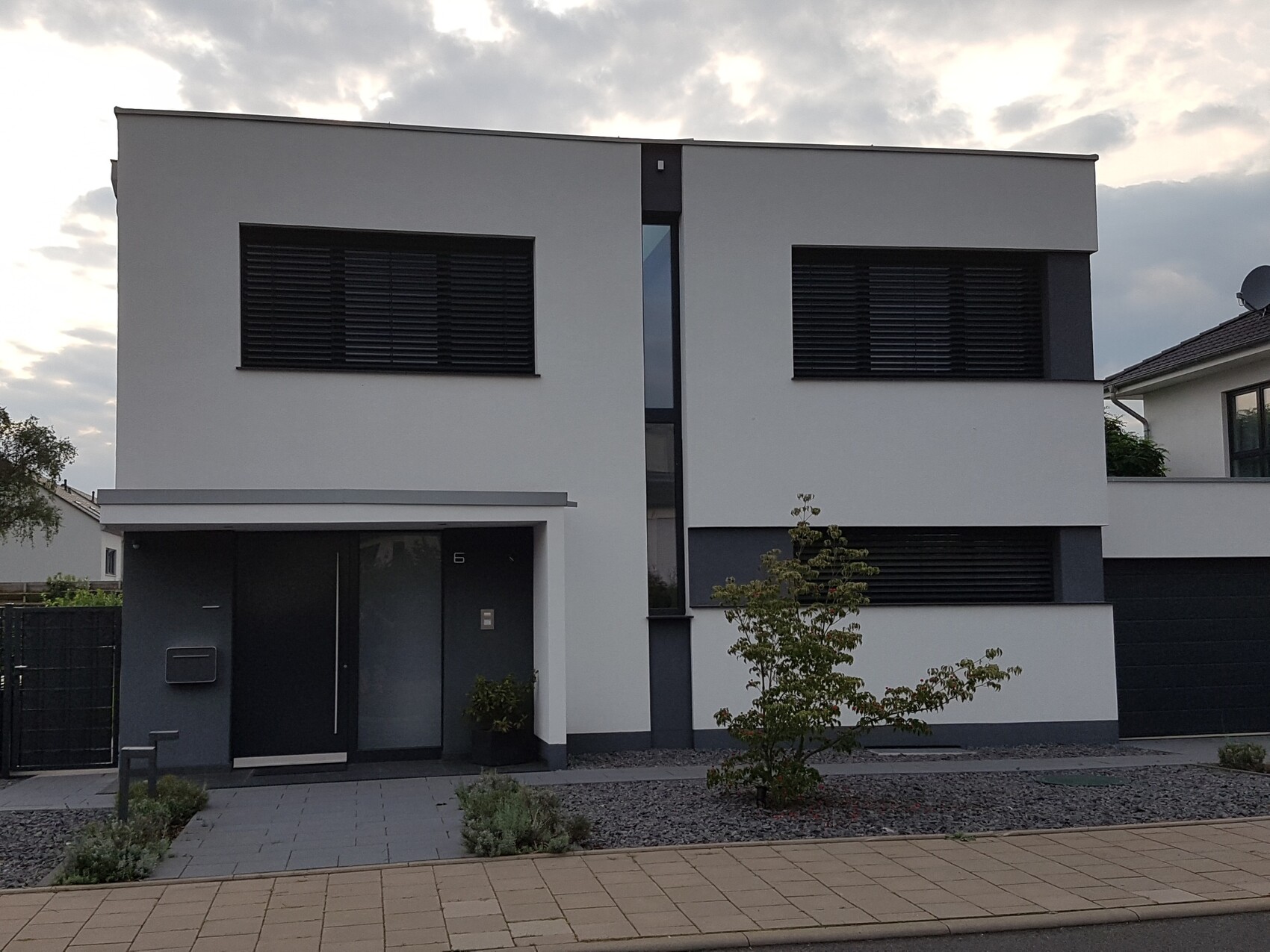

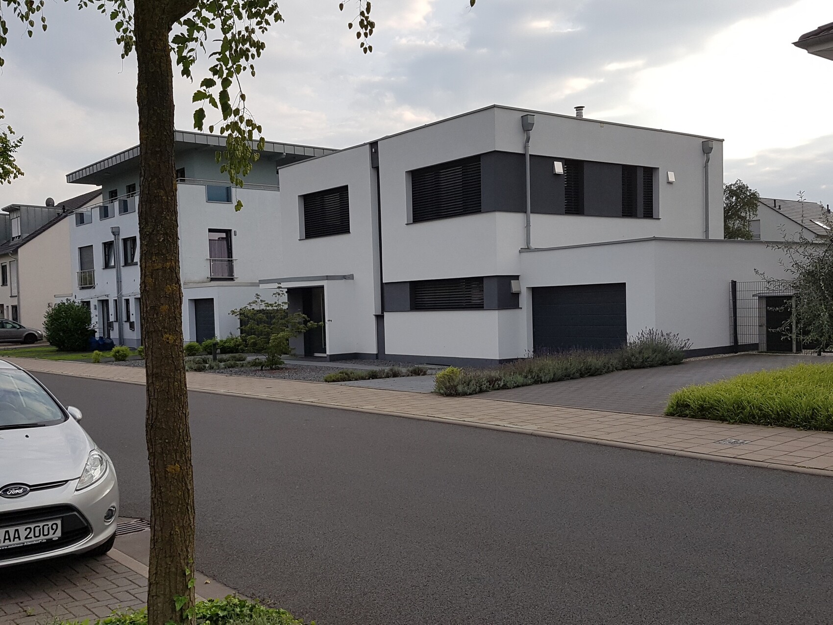

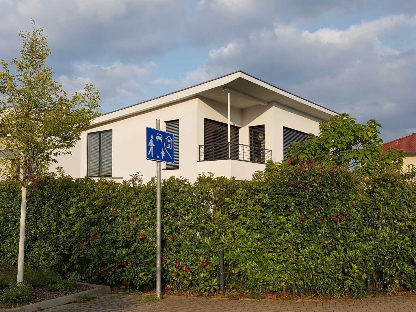

I have now taken new photos of the other two houses in the neighborhood as announced. Personally, I could live very well with a single-sloped roof. In our case, the higher side would face the garden. Although I’m not sure if the current design proposal is even suitable for a single-sloped roof.
I also photographed a classic Bauhaus-style house, which I find quite appealing with its roof overhang. It adds a subtle openness and is structurally solid. Unfortunately, something like that won’t work well with brick cladding, only with painted white surfaces... well, that can always be repainted every few years.
My wife was with me at the time. Unfortunately, she doesn’t like either option. She would be willing to accept it, but we both want to be happy living in our house for decades...
I could live comfortably with any of the options – single-sloped roof, hipped roof, or flat roof with an overhang. The coolest in my opinion is the single-sloped roof as shown in the photo! Really fantastic! As mentioned above, it would be interesting to see if it would actually fit with the building currently planned.
The Bauhaus-style house stands out mainly because of the external blinds. Without the blinds, it would be much less interesting.
Modern white residential buildings behind a white wall; two mailboxes attached to the wall, blue sky.
Modern white residential buildings with flat roofs behind a dense hedge; parked car at street edge, tree on the right
Modern white house behind hedge; balcony visible, blue pedestrian sign at road side, cloudy
Modern housing development with white buildings, garage, sidewalk, and parked car at street side.
Modern two-story house with white facade, dark shutters, and gravel garden.
RobsonMKK21 Aug 2017 19:49
For me, a "classic" hipped roof has a pitch greater than 45 degrees.
Take a look at Kaffeemühlenhaus, that’s where it becomes classic.

11ant21 Aug 2017 20:28
R.Hotzenplotz schrieb:
The first illustration shows how we are currently renting (on the first floor and in the mezzanine).
From the same perspective but behind the wall, I would like to see that sometime.
Personally, I could easily live with a mono-pitched roof. In our case, the higher side would face the garden. Although I’m not sure if the current design proposal is even suitable for a mono-pitched roof.
So far, all suggestions. The conversion to that (with an open underside) could be done quickly; with the hipped roof (with attic), it wouldn’t.
The coolest thing, I think, is a mono-pitched roof like in the photo! Really great!
I like it too. Also with a moderate slope.

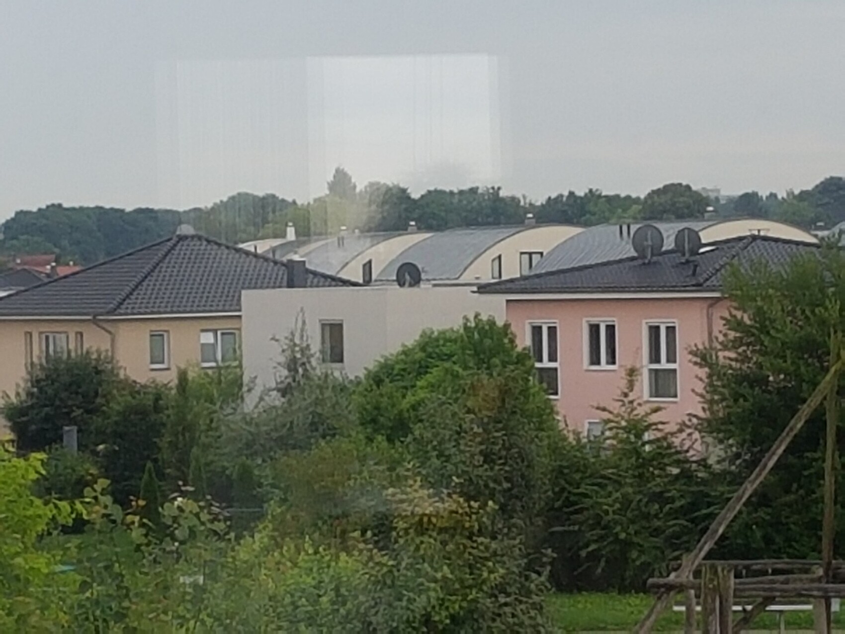

The barrel roof looks familiar to me. Is that the same walking area as in the picture with the two pyramid roofs, where there were also some like those in the background?
I also photographed a classic Bauhaus house that I actually find quite good with an overhanging roof.
The one on the left with the continuous roof terrace, whose corner is hidden behind the small tree?
I find the Bauhaus-style house stands out mainly because of the external venetian blinds.
So the one on the right in the same picture? — I would have thought you’d only like the left one, since the right one doesn’t have that overhanging capping plate.
Without external venetian blinds, it would be significantly less interesting.
Without external venetian blinds, it would be much less Meiermüllerschulze 2015.
Have I understood your terminology correctly now: by “classic Bauhaus” you mean when it’s just white and the roof sits on top like a granite slab on a grave, and “Bauhaus style” when the roof is “not visible” and the facade also includes gray?

R.Hotzenplotz
21 Aug 2017 20:47
I’d like to see it from the same perspective but from behind the wall.
Here you go!
That barrel roof looks familiar—is it the same neighborhood as in the photo with the two pyramid roofs? There were similar ones in the background, right?
Exactly. All the houses shown here are from the same neighborhood.
You mean the one on the right in the same photo? I thought you’d only like the one on the left since the right one doesn’t have that overhanging roof edge with cover plates.
The one on the left is somewhat like where we live now. But that house has two full stories plus a recessed top floor, so it doesn’t fit our concept. I was actually referring to the other house.
That house has no roof overhang. But after taking a closer look earlier, I imagined it with a roof overhang and also realized that with the visual breathing space it already has, it’s actually not bad—even without an overhang. I think a house like that should only have a plaster finish; I don’t find brick or partial brick cladding would suit it well.
Without external venetian blinds, it would look much less like a 2015 Meiermüllerschulze design.
You mean it would look better or at least more distinctive with traditional roller shutters?
Looking closely at this house makes me conclude that the design we have already approved but can’t build yet wouldn’t have fit well at all. Too many corners and edges, making it visually too busy and also more complex and costly to construct.
Did I understand your terminology correctly: your "classic Bauhaus" means simply a white box with a flat roof sitting like a granite slab on a grave, and "Bauhaus style" means the roof isn’t visible and the facade includes gray tones?
I think sometimes my statements shouldn’t be taken too literally. I didn’t subdivide my thoughts that finely. To me, classic Bauhaus just means that cubic look… mostly medium to large windows… understatement… usually white plaster… but let’s just forget about distinguishing between Bauhaus style and classic Bauhaus style. I honestly wasn’t making that distinction in my comments, so let’s just drop it.
However, I find it hard to imagine the Bauhaus style—especially the house in the photo—without external venetian blinds. I think they really complement the overall look. We have roller shutters at our place… and I don’t think that’s so bad… why? I don’t know! Maybe because of the 2.5 stories or the different window shapes. If I had that white plaster and was building a Bauhaus, then definitely with external venetian blinds!
What a day… now I’m seriously reconsidering the roof… it’s already hard enough to come to the “right” conclusion alone. Agreeing with my partner is intense, I tell you.
My wife remains firmly in favor of a hip roof. If I don’t want that, she’d accept a flat roof as a compromise (she doesn’t mind if it has an overhang or not), but she cannot imagine a shed roof at all… although she said that before we start over again, she’d even accept that if we keep the current floor plan. But that’s something we definitely need to decide together… I don’t want to corner her too much and have it held against me later.

11ant21 Aug 2017 21:07
The house has no roof overhang. But when I looked at it more closely earlier, I imagined it both with a roof overhang and also calmly realized that the house, with the current design features, isn’t bad at all—even without a roof overhang. I think a house like this should only have a plastered finish; I don’t think brick or partial brick would work as well.
Where it has gray plastered surfaces, it could also have gray or violet-gray toned brick surfaces.
However, I can hardly imagine the Bauhaus style—especially the photographed house—without external venetian blinds. I think they go really well together. We have roller shutters at our place....
The functions are quite different, so I wouldn’t really compare them. Roller shutters are okay in my opinion, just not if they are standard light gray on a white and anthracite house.
She said, before we start all over again, she would even accept that if the current floor plan remains.
A clear sign to take a break for now.
