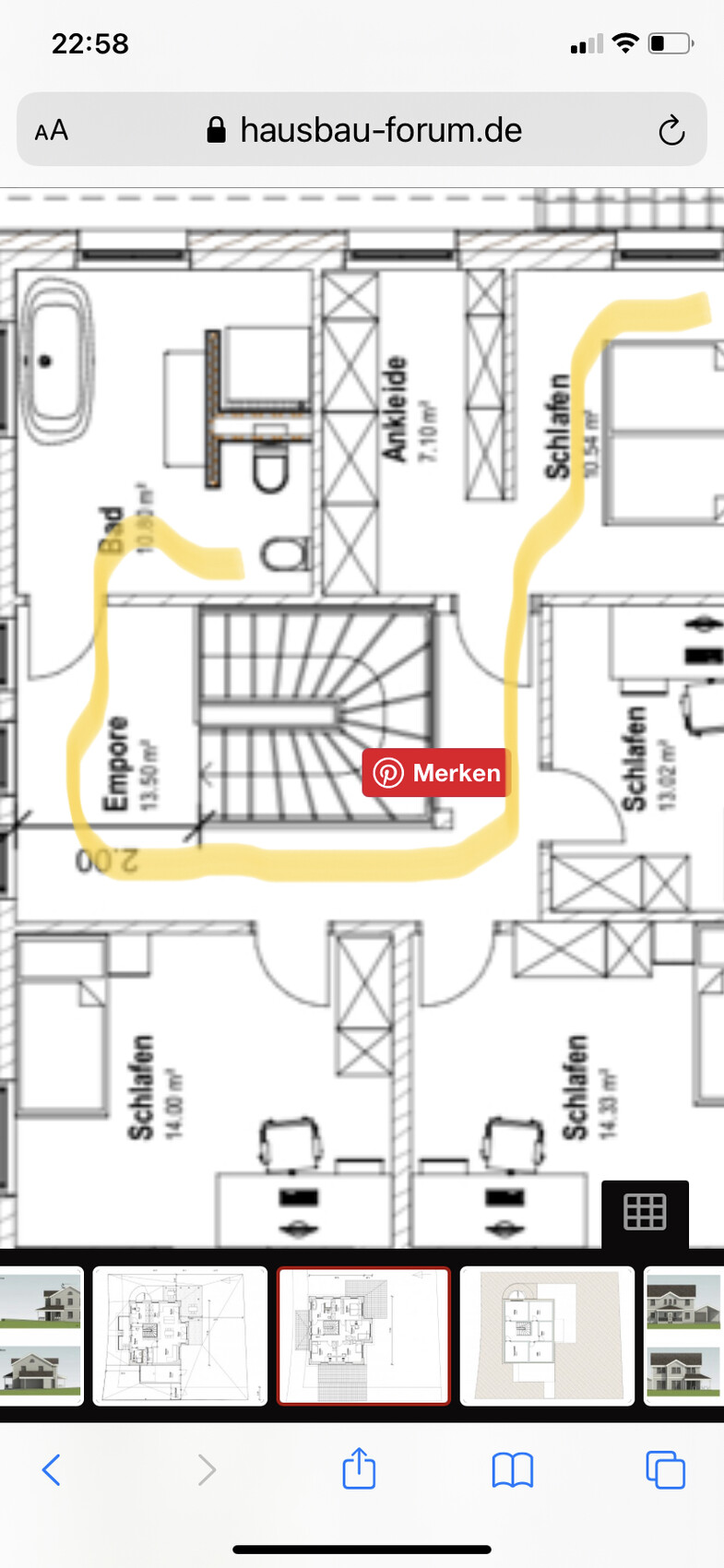

Myrna_Loy31 Aug 2021 23:00Am I understanding correctly that you always have to go around the stairs to get to the bathroom on the upper floor???
I would suggest looking at the floor plans of American houses of this type. My grandparents’ house was a classic neo-Gothic style with a front porch and a central main entrance. However, the floor plan was completely different.
😀 Exactly: I forgot to mention that in my list. We think it’s too long, or do you, @Myrna_Loy? 🙂
Myrna_Loy31 Aug 2021 23:10ypg schrieb:
Exactly: I forgot to mention that in my list. To us, that's too long, right @Myrna_Loy? 🙂 As a mother, I would say just one word: norovirus.
MaSchu250631 Aug 2021 23:17Myrna_Loy schrieb:
Am I correct in understanding that you always have to go around the staircase to reach the bathroom on the upper floor???
😀 Yes, and to get to the living room, you even have to go downstairs 😀
...Seriously: we are aware of that. The alternative would be version V3, which means moving the children's rooms to the south, shifting the bedroom into the bathroom area, and relocating the bathroom. However, that would mean the bedroom is only 14 sqm (150 sq ft) and no walk-in closet would be possible, so wardrobes would have to be in the bedroom instead of separate.
According to the architect, due to the staircase and the access points, there is no other solution... Or do you have any other ideas?
