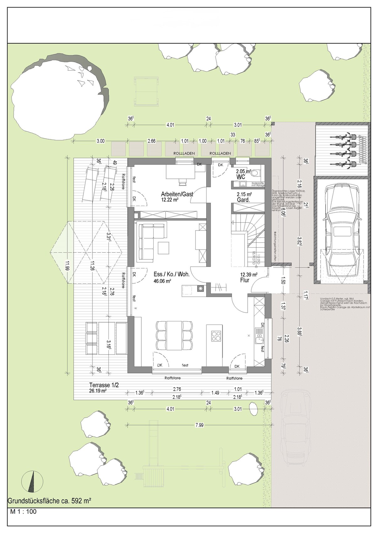

Hello fellow home builders,
after quietly following along, things are finally getting serious for us! We have purchased a building plot and are now busy planning. There is already a draft from an architect as well as our own design. I’m attaching both, with the architect’s draft mainly showing the plot view and garage planning.
In our own design, we have made several changes, mainly enlarging the open kitchen-dining-living area since we have a large open field to the north upstairs and want to enjoy the view also on the ground floor. The planned construction method is solid brick masonry.
We are quite satisfied with the upper floor, but we are not sure if everything works well on the ground floor! I would really appreciate some tips from experienced builders here. I hope the plans are clear ;-)
Thanks in advance and best regards from Bavaria!

What do you like most? -> layout of upper floor
What do you not like? -> unsure if the entrance area and staircase are too narrow or oppressive?!

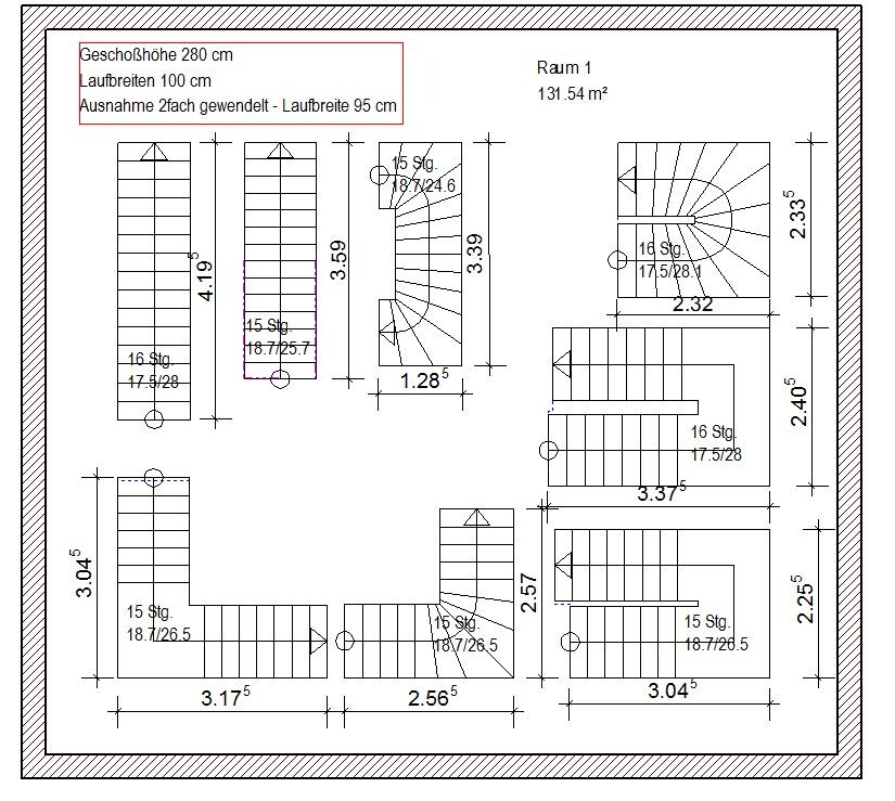

We have approximately 2.2 meters (7 feet 3 inches) at the bottom and 2.4 meters (7 feet 10 inches) at the top (although it now looks as if the last step at the top is part of the floor structure) – the width is 2.25 meters (7 feet 5 inches).
It is okay to good – as mentioned – there are certainly more comfortable options. Half-turn staircases tend to have steps that are not all the same width.

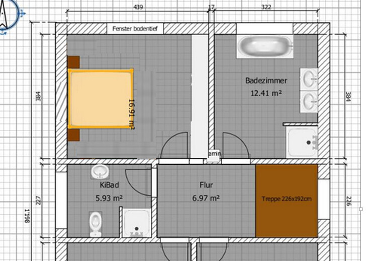

nordanney26 Feb 2016 11:41Children’s room is huge, children’s bathroom is more like a storage closet.
The chimney flue won’t be that small (on the upper floor), so you might have issues with your doors.
Feels like there’s limited natural light in the living area, with only one window facing west and one facing south, plus a very narrow layout.
I personally wouldn’t want it that way, but with the staircase arrangement and the entrance located in the middle of the long side, there’s no other way to do it.
As you have planned the fireplace, it unnecessarily limits the living room space. I would place the fireplace and stove on the exterior wall and more centrally within the floor plan. Then the chimney flue would run up through the children's bathroom — which can be enlarged in that way — while the children's rooms can be made a bit smaller, as they are currently quite spacious. On the other hand, your bedroom is extremely tight.
