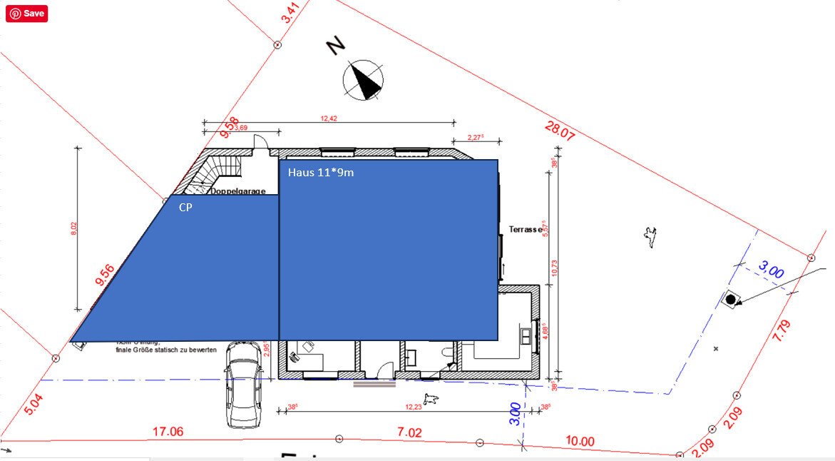

so far we have only been silent readers in this forum and have already gained some interesting ideas this way. We are currently in the planning phase of a single-family house with a basement and have tried to put our wishes into a floor plan. Maybe some of you would like to give feedback on our first drafts. Important: The design is not yet complete. For example, light wells are still missing, the bathroom on the upper floor is not yet fully planned, outdoor areas, etc. Therefore, some changes are still possible, and we would welcome constructive criticism.

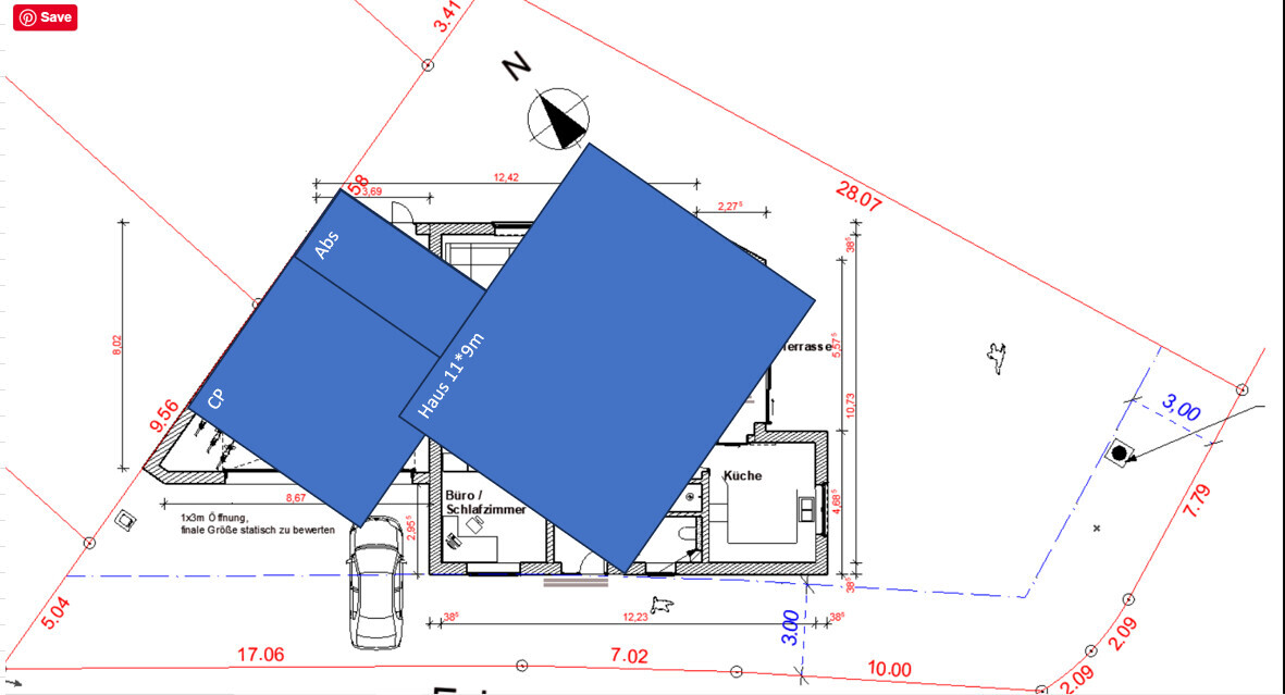

hanghaus202312 Mar 2024 10:52Why is the border garage 10 m (33 feet) long along the property line?
Why is there a 6 m (20 feet) distance between the garage and the street?
The budget is definitely not sufficient.
The friend's design is not a favor. In which direction is the required ridge orientation?
The photovoltaic system will likely be positioned very unfavorably.
