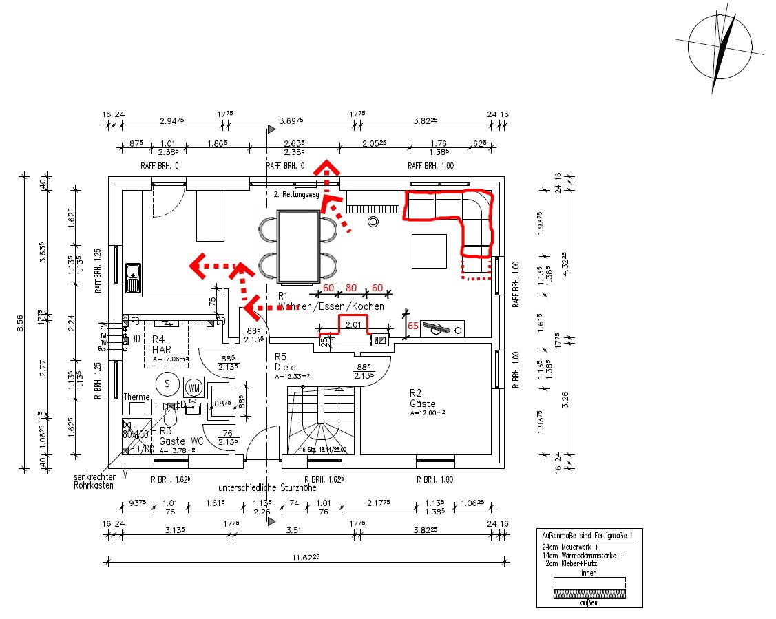

After a long search, we signed the notarized contract for the land purchase at the end of December. We are now actively planning the floor plan. Unfortunately, the plot is somewhat awkwardly shaped (not rectangular), which creates some limitations for the layout from our perspective. We already have a first draft, but there are several areas we don’t like and are unsure how to improve. Maybe you have some ideas; we would appreciate your input.
Plot size: 601 m² (6465 sq ft)
Building envelope, building line, boundary: Building line with the house on the west side
Peripheral setbacks: 7 m (23 ft) from the street (north), otherwise the usual 3 m (10 ft)
Number of parking spaces: 2 desired
Number of floors: 1 full story allowed
Roof style: Gable roof
Design style: open construction method
Orientation: South
Maximum heights / limits: Ridge height max. 8.5 m (28 ft)
Additional requirements: Max. 100 m² (1076 sq ft) of built-up area
Style, roof form, building type: Solid construction house, rectangular, no bay windows, no projections, etc., gable roof
Basement, floors: no basement; 1.5 stories
Number and age of residents: 2 people, age between 30 and 40, possibly children later
Space needs on ground floor and upper floor: Ground floor – living/dining room, kitchen, guest toilet, utility room, office
Office: family use or home office?: family use
Guest stays per year: 20 days
Open or closed architecture: open living area, closed hallway
Conservative or modern style: conservative
Open kitchen, kitchen island: open kitchen, island without cooktop
Number of dining seats: 2-4
Fireplace: yes, chimney planned
Music/stereo wall: no
Garage, carport: carport
Further wishes, special features, daily routine, and reasons for preferences:
- A wardrobe area on the ground floor is important where coats can be stored relatively out of sight.
- On the upper floor, it would be nice to have an open gallery with a desk or similar (not a must and not necessarily next to the stairs).
- A walk-in closet would be nice but not essential.
- A storage room on the upper floor is very important since we do not have a basement.
Who created the design:
- Basic design by the construction company (FIBAV Stadthaus Vision Studio)
- DIY modifications based on online floor plans (especially Viebrockhaus Maxime 330)
What do you particularly like? Why?:
- Layout of the living/dining area and the narrowing kitchen reduces the hallway effect a bit
- Many windows in the living/dining area
- Wide hallway on the ground floor
What do you dislike? Why?:
- Few options to place furniture (dresser, wardrobe) in the ground floor hallway due to many doors
- Very large hallway upstairs, considered wasted space
- Bedroom is quite small; should be the largest room upstairs (preferably 16 m² (172 sq ft), children’s rooms rather 14 m² (151 sq ft))
- Stair placement limited by chimney location
- Door placement upstairs limited by chimney
- A staircase rotated 90 degrees (entrance next to front door) would appeal more
- Difficult to align windows upstairs and downstairs on the gable end vertically
- Floor-to-ceiling windows upstairs; wider windows with a sill height around 100 cm (40 inches) would be preferred
Price estimate by architect/planner: 200,000 €
Personal price limit for the house including equipment: 210,000 €
Preferred heating technology: gas heating
What details or expansions could you give up?
- Can do without: gallery next to stairs upstairs. Living area could also be narrower (e.g., 4.20 m (14 ft) instead of 4.47 m (15 ft))
- Cannot do without: storage room upstairs, shower in guest toilet, extra natural light in the ground floor hallway (e.g., side panel on front door or window)
Why was the design made this way? For example, standard plan from planner?
- Since the house has very little space on the south side, the house should be very narrow in order not to waste more space to the south. It should be wider so that living, dining, and kitchen areas face south as much as possible.
Were corresponding wishes from the architect implemented? No architect meeting has taken place yet.
How can the ground floor hallway be better designed to fit a wardrobe? Can the stairs be positioned better or replaced? Should the hallway be enlarged and living space reduced? How can the upstairs hallway be better utilized? Can the bedroom be enlarged? Is it possible to swap the bedroom with another room, e.g., move it to the southeast to allow a walk-in closet?
Thank you very much in advance for your criticism and suggestions!

Well, to be honest, I’m always a bit surprised by the planned half-height windows—they’re not really my style either. My partner and I actually find window sills nice and practical for flowers, decorations, etc.
On the south side, I think it’s useful as otherwise you’d always be looking at the back of a sofa from the garden.
On the west side, it would indeed have made sense to use a full-height window since there’s no sofa there.
I would definitely put the sofa against the other wall. That way you get more light. The TV could be angled and placed on another piece of furniture or something.
Try placing some indirect lighting on the floor and/or at eye level: a skylight is only useful if you need to look for marbles. We want to replace the current sofa with a corner sofa whose backrest will then extend up to the west window. Finally, we’ll add an ottoman that would fit under the west window.
On the west side, we have also planned a wall lamp at eye level that would provide indirect lighting. Plus some pictures and so on. I think that will make the west wall look nice.
And the dining table could be placed crosswise, right? Yes, it could be, but then half of the people would face the hallway instead of the window, which is a bit of a shame.
That’s why I prefer it lengthwise as shown in the picture. But of course, both options are possible.
What advantages do you see in placing it crosswise?
Climbee schrieb:
I just can’t dance naked through the houseOf course you can! I’d definitely lie naked in the garden at your neighbors’ place. :P11ant schrieb:
I often wonder if no one here is familiar with vertical blinds from their office environment.Right from the planning stage, that just wasn’t considered at all. I think the main problem was that we simply had no vision — no clear idea of how the house (at least the living room) should look. So we just relied on our gut feeling and the architect. Maybe we should have copied more living rooms from show homes, then at least we would have gotten something we had seen before.
chrisw81 schrieb:
We want to replace the current sofa with a corner sofa whose backrest will extend up to the west-facing window. Finally, there will be an ottoman placed under the west window.
[ATTACH alt="Ground floor plan.jpg"]41926[/ATTACH]
I still think "get rid of the island" and put the table there. Corner sofas usually don’t look as good as two separate smaller sofas.Similar topics
