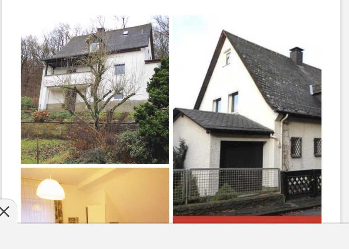

icandoit schrieb:
My question about the architect’s age probably hit the mark—not only regarding the budget.It’s really become clear to me now: Visually, we are dealing with a 1950s style (attached is a house from 1952), with a similarly conservative interior. Even the side terrace was often built back then on a mound leading down to the garden. This strictly separated dirty garden soil from the coffee gathering on the elevated terrace.
This is not meant as a criticism—I actually like 1980s bungalows too 😉
I can’t quite place the 1.80-meter (6-foot) corner sofa. Once you add a family sofa of at least 2.40 meters (8 feet), the space gets really tight.
The fireplace feels too bulky for the narrow room.
The idea of “keeping children in the house while mom cooks” now makes sense.
Sorry, but what needs to be said will be said here.
This isn’t meant to be spiteful, and regarding the “prison” comment: I really think the low safety factor is careless, and you could get into serious trouble because of it.
About the budget: plus two dormers, plus sliding doors, plus fireplace. The rest will probably also be somewhat above standard.
And regarding the question: at the eye doctor, playing children would bother me less than during a personal meeting at a desk.

Comments about it being a 1950s-style build, etc., are all very nicely phrased but not constructive, dear @ypg. As I said, criticism is always welcome, but it should be constructive.

Statements like "1950s construction" are nicely worded but ultimately not very helpful, dear @ypg.
As I said, criticism is always welcome. But it should also be constructive. Hmm... I know it can be uncomfortable to hear certain things. However, you should assume that people are more likely to be glad to find a suitable property, and if financial matters have come to the forefront here, it’s probably because they needed to be addressed honestly and clearly.

Of course, no one wants to hurt anyone’s feelings, but for example, I see the comment about the 1950s construction the same way—if I were to comment on it, I would be more direct. This isn’t directed against you as the builder but could be a hint to encourage you to think critically in a different direction.

Nobody wants to hurt anyone’s feelings, but for example, I see the issue with the 1950s-style house in the same way; if I were to comment on it, I would be more direct. This isn’t directed against you as the client but rather could serve as a prompt to think critically in a different direction.
