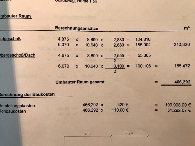

Since I want to name a reliable source, I dug up my building permit application (unfortunately only from 2013) and photographed the relevant section.
It is for a standard house (in a low-cost region of northern Lower Saxony), 135m2 (1450 sq ft), gas heating, Energy Saving Ordinance 70, plaster facade, average fittings. The construction specification is slightly better than Heinz von Heiden’s. Construction costs* add up to around 200,000€ without extra charges for floor coverings and luxury extras. *excluding land, garage, external facilities, slope, and without additional construction costs!!!
Source: Federal Statistical Office, left building year, middle cost/m3, right cost/m2
Facts:
2013 [B][U]429€/m3 1500€/m2 466m3 x 429€ = approx. 199,000€ or 135m2 x 1500€ = approx. 202,000€[/U][/B]
According to the Federal Statistical Office, I am right in line per m2 but not per m3. I would need to add (a bit more than) half there.
What would my house cost today? A simple rough estimate, adjusted somewhat downward as a conservative calculation:
2020 (350 + 1/2) 525€/m3 1900€/m2........466m3 x 525€ = approx. 245,000€ or 135m2 x 1900€ = approx. 255,000€
2021 (360 + 1/2) 540€/m3 2000€/m2........466m3 x 540€ = approx. 250,000€ or 135m2 x 2000€ = approx. 270,000€
These are the reference values for my house.
Facts:
Where do you and your house stand?
