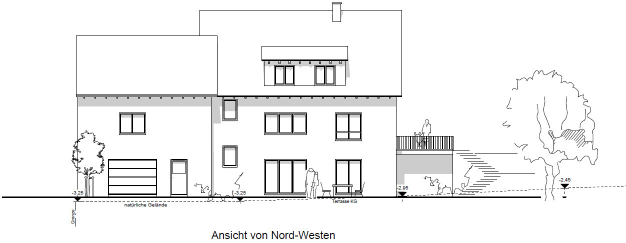

Good morning, dear forum members,
We received the first draft of our single-family house over the weekend and are initially very pleased 🙂
We would like to share the first sketches here to get feedback from experienced homebuilders.

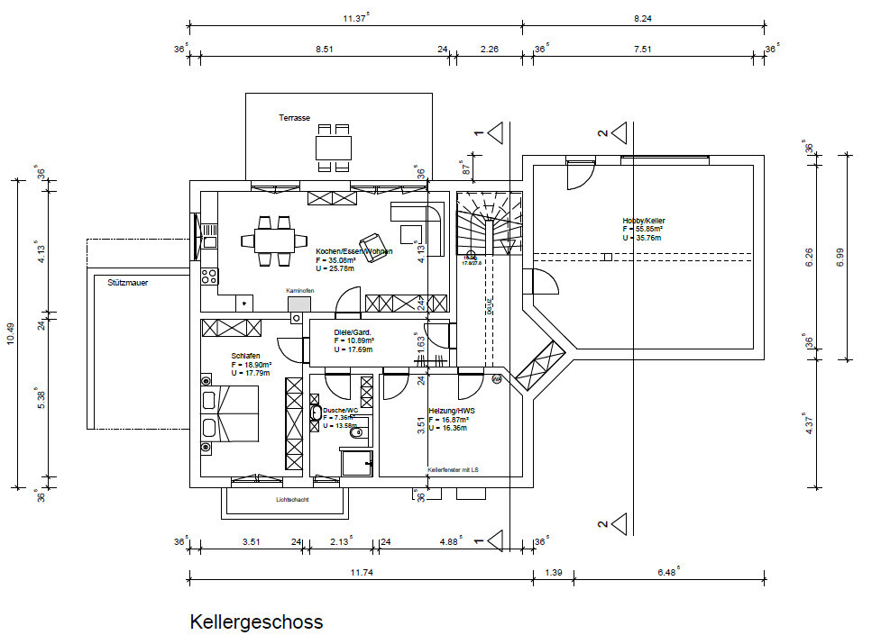

Due to the slope of the plot, we will build with a basement. It will house a separate apartment / my wife’s naturopathic practice.

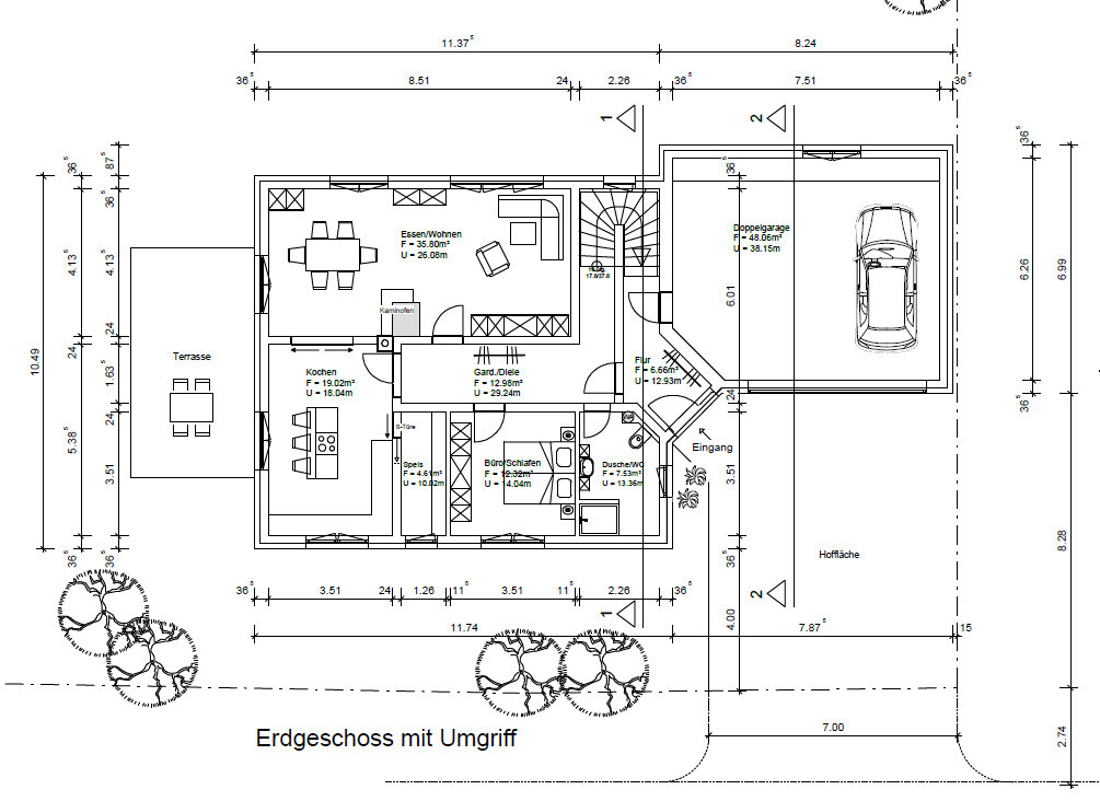

A home office on the ground floor or attic is essential as I regularly work from home (even before the pandemic).
We are currently planning a house for 3 children. Additional space could be created by expanding over the garage.

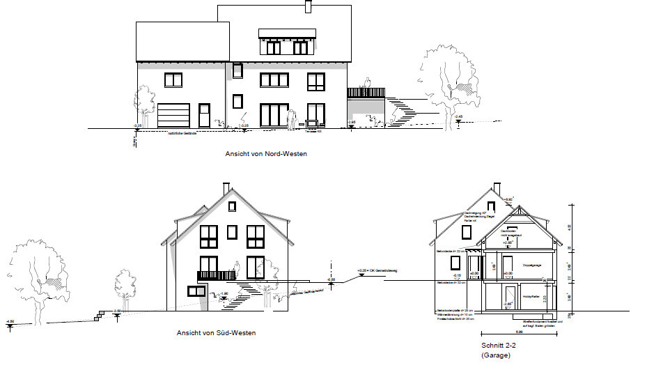

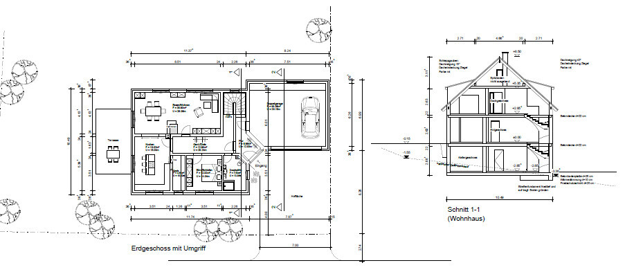

Architekturplan: Einfamilienhaus mit Doppelgarage und Einliegerwohnung – Entwurf
Kellergeschoss-Grundriss: Küche/Essen/Wohnen, Diele, Treppenhaus, Hobbyraum, Dusche/WC
Architekturplan: Erdgeschoss-Grundriss mit Garage, Terrasse und Treppen; Schnitt 1-1.

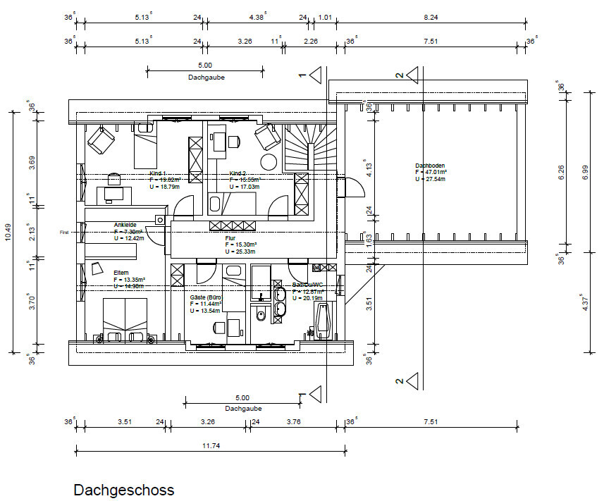

Südwesten-Ansicht eines Hauses mit Treppe; Dachgeschoss-Grundriss darunter.

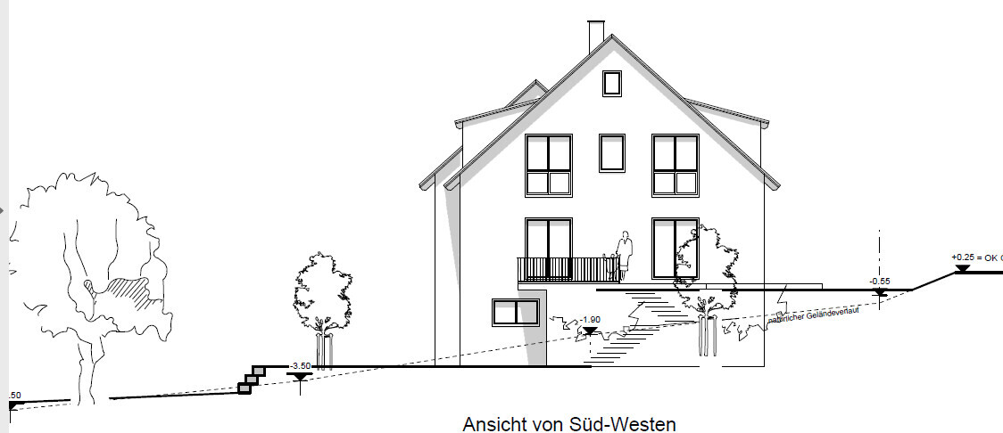

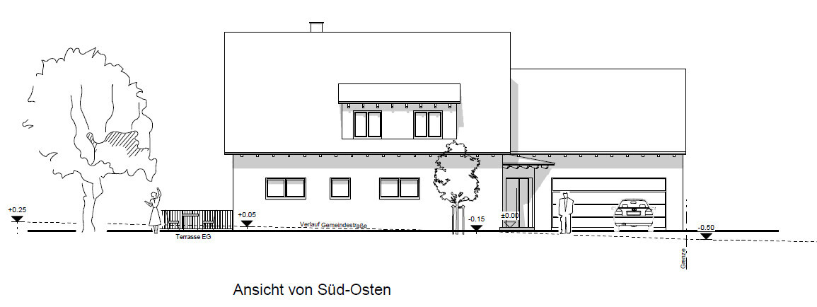

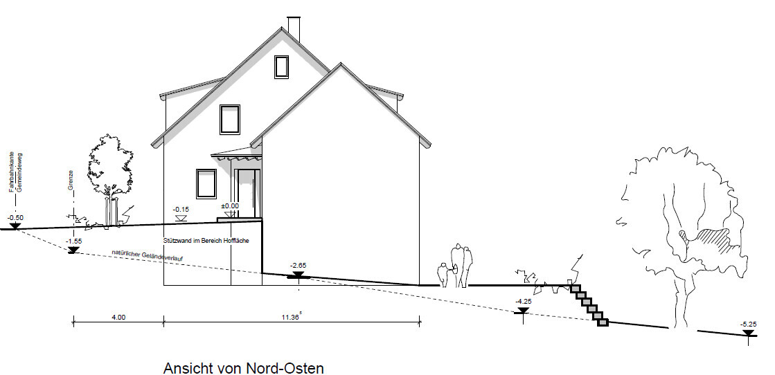

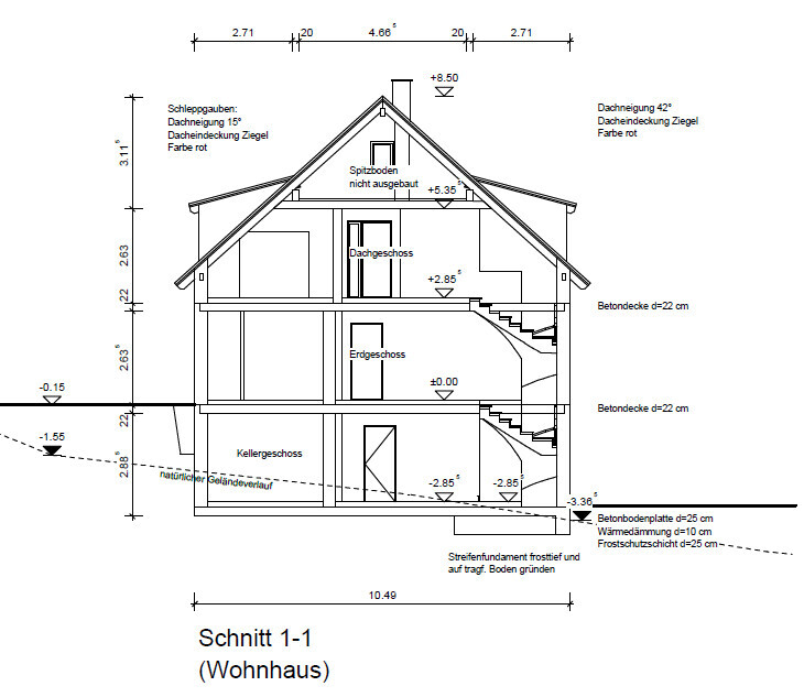

Andreas94
24 Mar 2021 07:49
Yesterday we received our revised plan.
All our requested changes have been incorporated, so we are very satisfied with the plan.
Our main question concerns the floor plan design. Should / can / must anything still be improved?

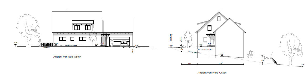

Zwei Wohnhaus-Ansichten von Südost und Nordost mit Garage und Bäumen.
Architekturzeichnung eines zweigeschossigen Hauses mit Garage, Terrasse und Garten; NW-/SW-Ansichten.
Architekturplan: Grundriss Erdgeschoss mit Garage und Seiten-/Schnittansicht eines Wohnhauses
Architekturpläne eines Hauses: Grundrisse Kellergeschoss (links) und Dachgeschoss (rechts) mit Maßen.

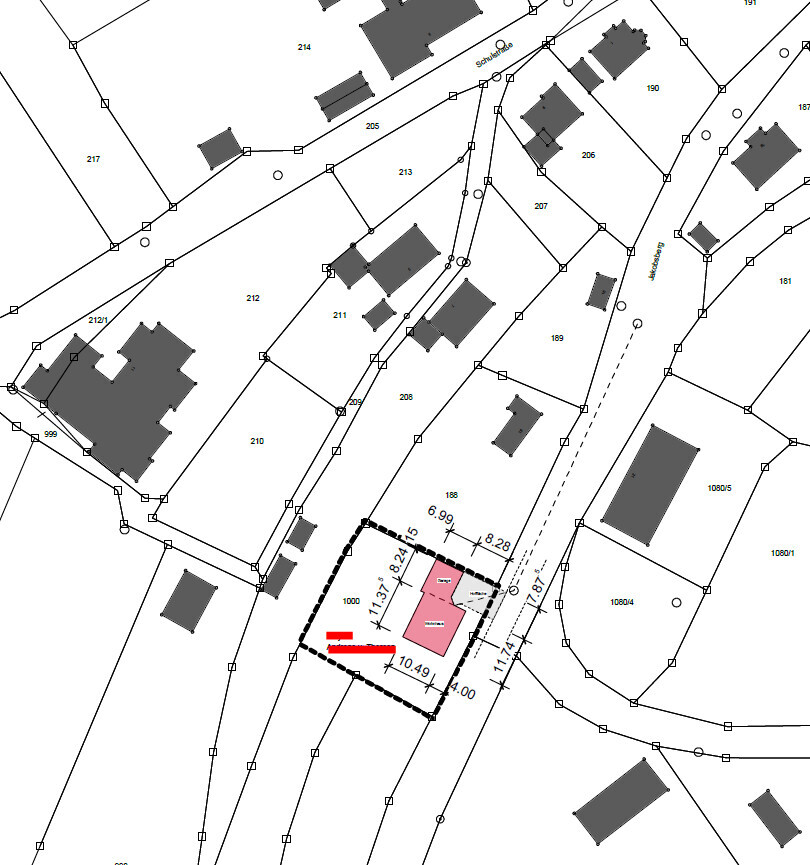

Katastrale Karte: Parzelle mit pinkem Gebäude, schwarze Umrandung und Maßangaben.

View from the northeast: house on a slope with stairs, retaining wall, tree, and people.
Northwest view of a two-story house with roof, terrace, garage, stairs, and trees.
View from the southeast: modern two-story house with terrace, tree, people, and garage.
Two-story house on a slope with stairs, balcony, and trees; southwest view.
Attic floor plan with hallway, stairs, bathroom, master and children’s bedrooms, walk-in closet, guest/office room.
Ground floor plan with terrace, kitchen, dining and living area, bathroom, cloakroom, hallway, garage.

Site plan of a property showing outlined plot, pink building volume, and red marking.

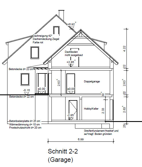

Section 2-2 (garage): cross-section of the house with double garage, hobby room/basement, attic, dimensions.

24 Mar 2021 09:20
Well, you and the planner are stuck on the same issue: now it’s a staircase that almost separates and strongly divides family life between the living and sleeping levels. A large hallway without cloakroom space for five people leaves a lot of room for scattered shoes or several sideboards lined up next to each other.
The criticism regarding the granny flat/practice has not been addressed – so it remains a valid critique. What new feedback are you expecting now?
11ant24 Mar 2021 13:51
A house doesn’t have to be mainstream trendy – but if it looks like it’s sixty years old with a poorly matched garage extension, that would make me think twice. Even in our Mennonite neighborhood, people build in a more modern style. I haven’t counted exactly, but at first glance, I’m not sure if the reconciliation of the square meters with the budget was successfully aimed for.
