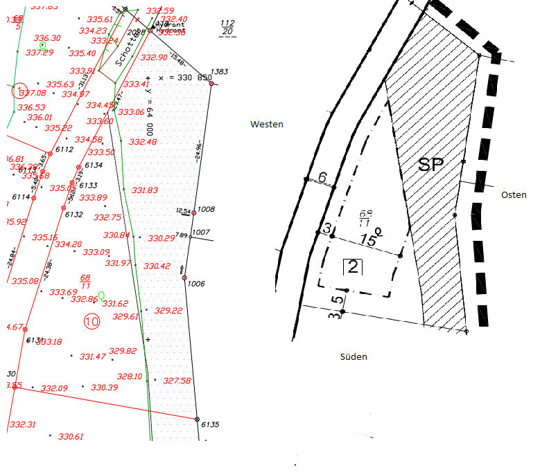

What is your budget for the house?
$350,000 including additional construction costs?
$300,000 for a house with a basement is not sufficient for your plan (L-shape, balconies).
Many plan for more living space than you actually have with 160sqm (1,722 sq ft). The living room often can hardly be used as living space.
What is the orientation of the plot?
Please clarify this—under a building line, I understand something different than an area, namely a line.
Draw a cross-section of the slope on graph paper! This will give a better impression, including how to use the basement and how to plan the ground floor. From this, the building shape will emerge.

First, draw a rectangle showing the plot of land including its orientation and the street, then a section with height details. Including neighboring buildings would be helpful, especially since privacy screening was mentioned in the initial post.

My husband prefers an L-shape since we are building in a residential area, although he would have preferred a more secluded location. With the L-shape, we hope to create the desired privacy. The building authority officer said that a basement is almost unavoidable because of the slope.
I have now uploaded the site plan with building setback lines (within which you may build) and the elevation plan. Currently, there are no neighbors; 3-4 houses will be built above us and 3-4 houses beside us. There is development in front of us, but since the neighbor is far below, you can hardly see them. SP is the grassland, which of course may not be built on.
Unfortunately, I have to completely change my plan now because I learned that you must not only step back 1.5 m (5 inches) at the front but also on the left and right sides (to keep the entire building slender). Only on the west side (towards the street) is stepping back not required. Annoying.
