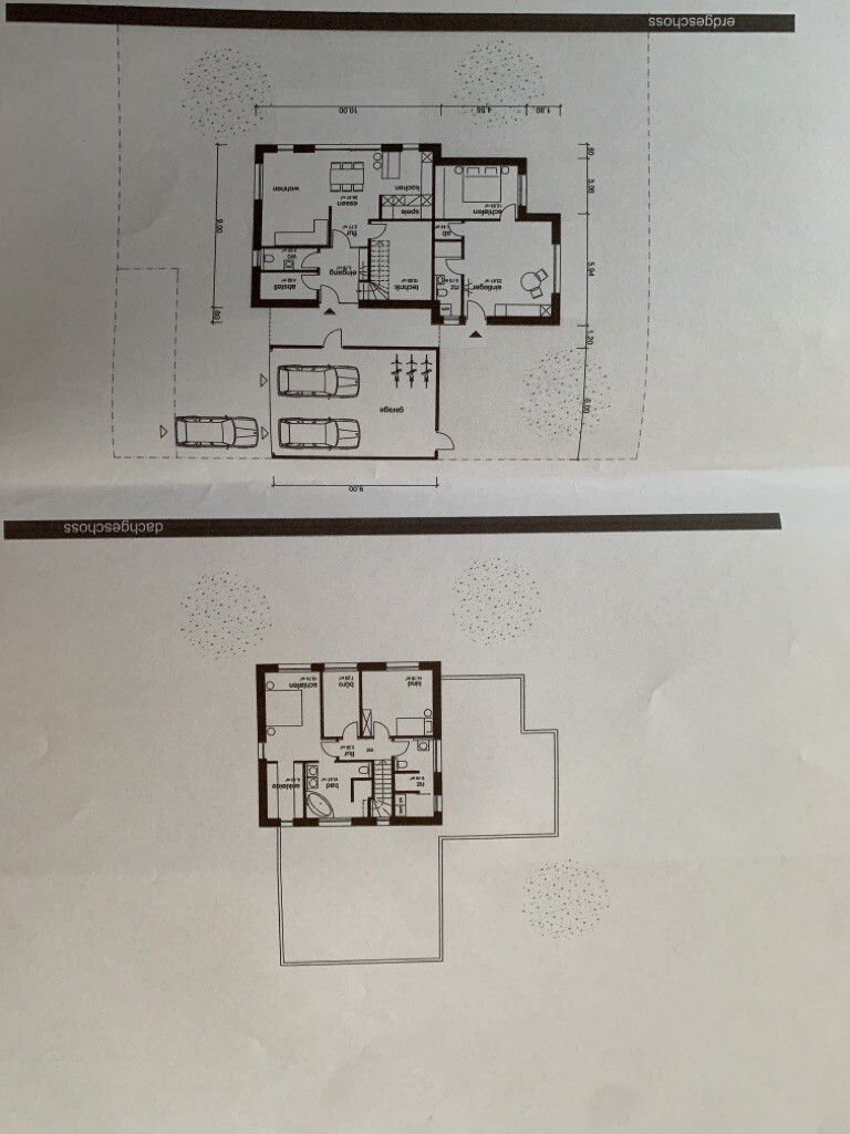

we are in the early stage of planning and would appreciate an open and honest opinion on our floor plan. Criticism and suggestions for improvement are welcome.

Why the granny flat
could you please provide all the details?
20 Apr 2021 21:57

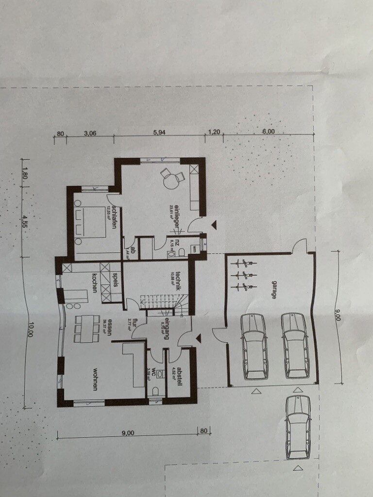

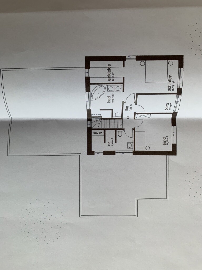

I find many things a bit... cramped, even though the house itself isn’t that small.
It starts with this narrow corridor between the house and the garage... don’t get me wrong, we have a similar passage, but not a two-story structure that blocks a lot of light and also dominates the space vertically.
Then the kitchen is quite small, and there is no dining area at all. The pantry isn’t even big enough to fit a freezer—what is the purpose of that room? The hallway on the upper floor feels oppressive as well... Three toilets for three people is a luxury.
The chill-out area is quite large again, and the master suite is also oversized. It seems the idea of a dream wellness oasis was planned there.
Who is going to live in the granny flat? Are you close with the residents, or is that why they are so close?
The occupant parks in front of the garage? 😎

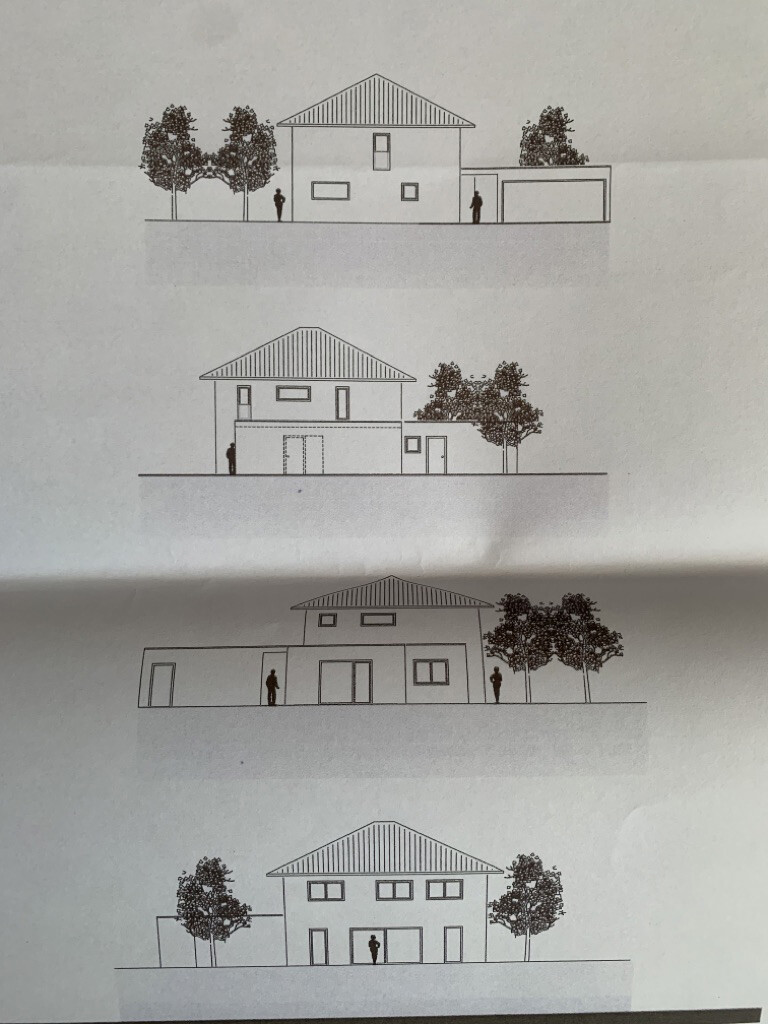

Visually, the roof is too tall.
11ant21 Apr 2021 00:40
Visually, the roof is too high.
The roof does not match the floor plan at all in terms of style.

This is not my floor plan. However, I would definitely eliminate this short wall near the sofa.
