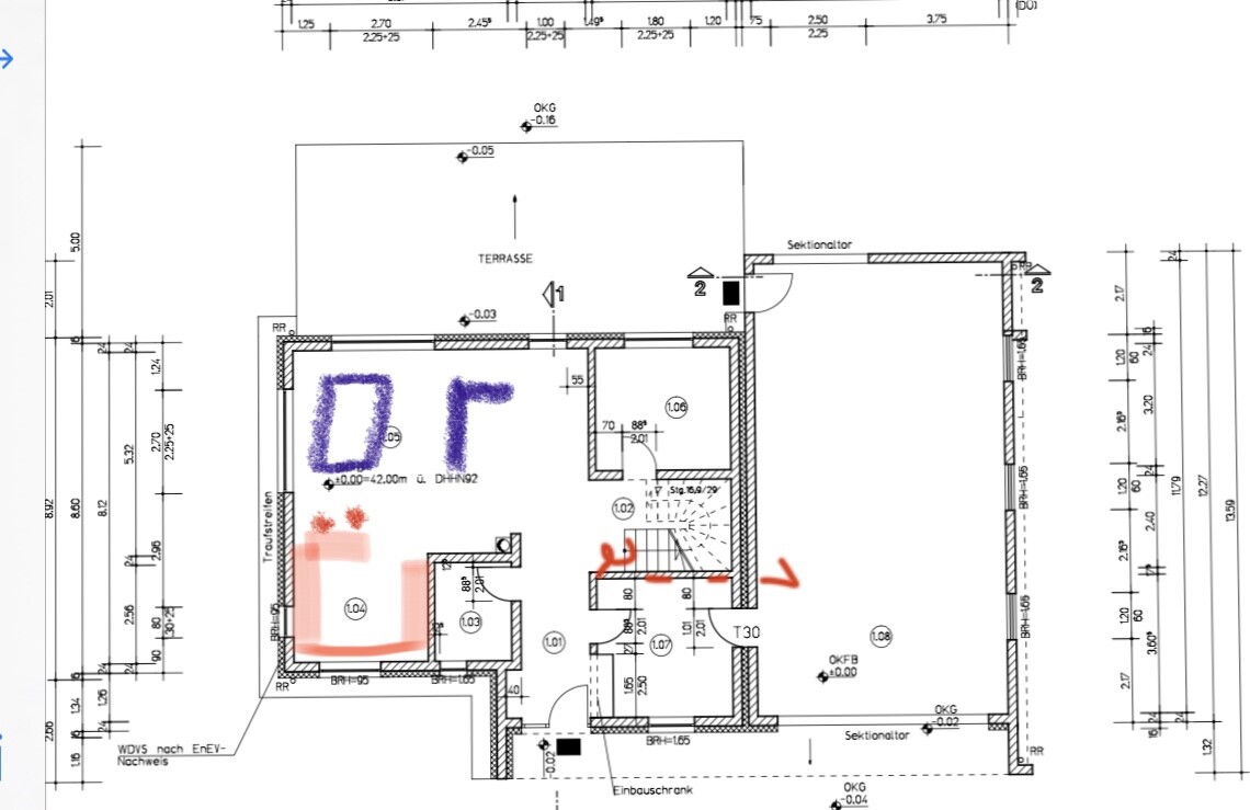

The ground floor is very similar.
Together, we have a total of 171m² (1,840 sq ft) for the three of us, which works really well for daily living.
I also added the kitchen layout (still not all the cabinets are filled with my wife’s stuff), including 2 bar stools, a table with 6 chairs, and a couch.
I would build the ground floor the same way again, except maybe increase the size of the north-facing window by the couch to over 1m (3.3 feet) so you can see the garden better from the couch.
Entry vestibules? For us, the air is usually still unless there is thunder or hail, but then the exterior doors generally stay closed. With a controlled ventilation system (mechanical ventilation with heat recovery), the windows are usually kept closed as well, so there’s no draft or door slamming.
For us, openness without doors was the priority.
I will skip the upper floor, as we only have one child and the second bedroom is used as an office. Oh, and the guest room or playroom is located downstairs in the northeast corner, since the child’s bedroom upstairs is always too far away to keep tidy.
