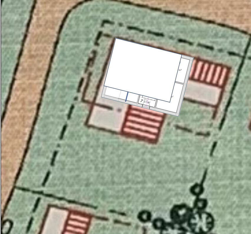

This is the maximum you can build according to your budget. This shows where you need to cut costs.
Site plan of a plot with a white building footprint overlaid, red areas visible.
11 by 8 meters (36 by 26 feet) with 2 full floors. Over 8 meters (26 feet) you only have a 0.8 meter (0.8 yard) slope. A true hillside house or split-level doesn’t make sense with such a gentle slope.

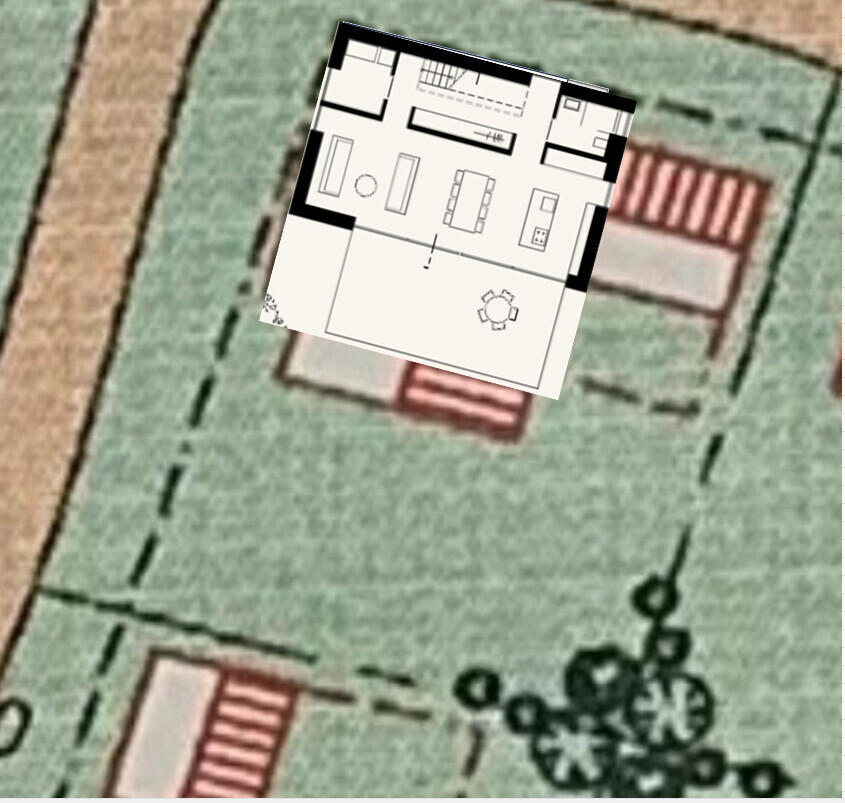

An example from the web with 135m2 (1453 sq ft)
Satellite image with house floor plan placed at an angle over garden area and terrace.
