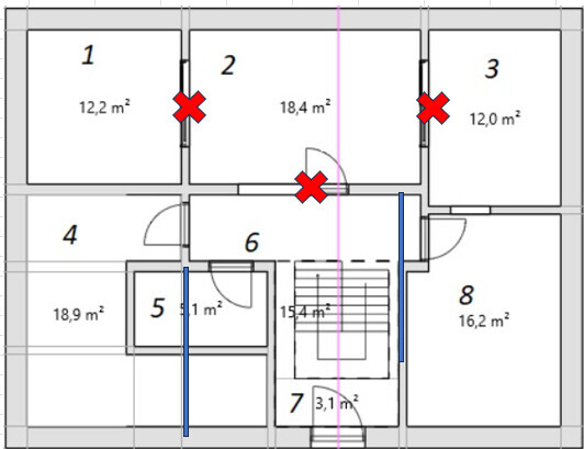

2D floor plan of a house with eight rooms, dimensions, and stairs
Floor plan of a house with six rooms (No. 9-14) and area indications in sqm
The following rooms are planned:
1: Living room with sliding door to dining area
2: Dining area
3: Kitchen with sliding door to dining area
4: Utility room
5: Guest WC/shower
6: Corridor
7: Landing staircase with enlarged landing
8: Storage room
9: Bathroom
10: Child I
11: Child II
12: Parents’ bedroom, possibly with a partition wall so you enter the bedroom through a small dressing room
13: Corridor (the landing staircase is not shown here)
14: Office / Child III
I look forward to your feedback!

A somewhat more straightforward and open layout is also possible. The staircase would then be placed closer to a wall.
Floor plan of a building with eight rooms (1–8) and area details in m².
However, the design definitely needs to be scaled back. Maximum 130–150m² (1400–1615 sq ft).

Is there a reason why room 5, the guest toilet, awkwardly leads into the utility room (room 4), so that the guest toilet has no window and the utility room ends up with a lot of walking space instead of usable area?
I wonder the same. The toilet could have been arranged parallel to the staircase instead of perpendicular, which doesn’t seem justified to me.

I was prepared for many changes, but I didn’t expect it to turn out such a disaster.
Gerddieter schrieb:
I think the floor plan is a disaster. What’s this supposed to be – a 1970s apartment? Does your house even have windows? And you don’t like the popular “open concept” living area either?
GD
I actually haven’t drawn in the windows yet. Regarding the open concept in the living/dining/kitchen area, I have placed sliding doors between each space. We want to be able to close off all three rooms when guests come.
To bring light into the hallway, we planned a window on the north side in the stairwell. The door to the dining area is also glass to allow light into the lower hallway.
Is there a reason why room 5, the guest toilet, leads so awkwardly into the utility room (room 4), causing the guest toilet to have no window and the utility room to have a lot of circulation space rather than usable area?
Also, where do you park the stroller, meaning where is the cloakroom, the hallway where one is welcomed, takes off shoes, and hangs jackets?
Bathrooms are not stacked, which is not a big deal, but a bathroom above the living room is not ideal. On the ground floor, the layout feels more like an apartment than a single-family home.
240 sqm (2580 sq ft) would cost around 520,000€ in a standard build, excluding additional construction costs and without a split level. Split levels don’t cost a fortune but do add extra cost.
The idea was to have some space under the landing in the utility room for the underfloor heating manifold.
I just noticed a door is missing. I had planned an exterior door in the utility room to provide direct ground-level access from outside, for example for groceries or the stroller.
Why do you consider a bathroom above the living room as not ideal?
I had planned a built-in cloakroom on the left side of the landing, integrated into the wall towards the utility room. This would reduce some space in the utility room at landing height, but that wouldn’t bother me.

We put up walls here because we like the idea that if guests are in the dining area, someone else can be in the kitchen or living room in peace. However, I did include sliding walls to keep it somewhat open.
There is no plot plan yet; this was just a discussion about the ideas he had.
which would also have been welcomed here: https://www.hausbau-forum.de/threads/sued-hang-grundstueck-700qm-einfamilienhaus-ca-150qm-ideen-input.49143/page-7
Designing beats erasing.
Haha. That’s almost false advertising.
I wonder the same. The WC could have been oriented parallel to the stairs instead of perpendicular, for which I see no reason.
It would be interesting to see their version before the “Verdoityourselfing.”
The living room being smaller than the dining room probably means that by “living” they really mean “watching TV,” right?
Sorry, I didn’t know, I thought a separate thread would be better.
The idea here was to have optimal access under the landing; alternatively, access could be via the storage room and the WC rotated 90°.

You don’t have a third level, at least it’s not visible.
And you have planned 100sqm (1076 sq ft) too much.
Hanger1 schrieb:
The idea was to have some space below the platform from the utility room for the underfloor heating manifold.
Huh? Your platform serves a different purpose and is located on another level.
Better leave the technical installations to a professional.
Hanger1 schrieb:
I had planned a wardrobe on the left side of the platform, but built into the wall towards the utility room. That way I would lose some space in the utility room at the height of the platform, but that wouldn’t bother me.
Give up a window because of poor planning?
Your house is a two-story building with the front door offset between levels. An entirely crazy effort that doesn’t benefit anyone here and isn’t reasonable.

Hello, I think you need to decide on the concept you want to build. Right now, it seems like you want a bit of everything without a clear direction.
A split-level staircase without the corresponding floors,
a living area that is somewhat enclosed but also partially open with sliding doors.
Also, you are approaching the DIY planning the wrong way. You are lining up rooms and moving walls without having a clear idea of where the windows should be for sightlines and the façade – that leads to poor results. First, consider how it should be, then plan everything together with all the components.
It’s like not throwing eggs, flour, and milk into a bowl and mixing first, then deciding what kind of cake you want to bake afterward...
