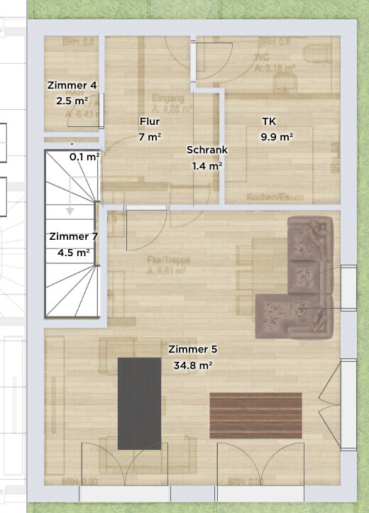

Princi16211 Jun 2024 13:44ypg schrieb:
yes, I know the design.
The problem is that many things no longer work properly. First of all, the staircase, which affects everything: it is below standard, so it is very difficult to use and therefore risky. If you look here:
https://www.hausbau-forum.de/threads/grundriss-planung-unbedingt-vor-beitrag-erstellung-lesen.11714/
at the very bottom, you will find the minimum target dimensions. And yes, if someone is tall and willing to accept it, they can build with 200 x 220cm (79 x 87 inches), but you are compressing the staircase to 189 x 175cm (74 x 69 inches). That’s simply too steep, with narrow steps… and since these are tapered, it’s quite dangerous. You would regret it every day. I’m not even sure if it still counts as an emergency escape route. Because there is supposed to be a utility room underneath, you will have to enclose the staircase with walls. That means it will be almost impossible to get furniture or even a ladder upstairs. You’re right, I already suspected that the staircase is planned too steep and narrow. But does that also apply to the original floor plan design? Basically, we could also imagine just separating the staircase slightly with a wall on the side, if that makes sense!? Simply not as open as it is currently…
Your kitchen is not functional. Your tall cabinets are not 60cm (24 inches) wide. For two tall cabinets for fridge and oven/pantry, you have to plan 130cm (51 inches), for three, 190cm (75 inches). A kitchen island should be 90cm (35 inches) deep so that splashing grease stays on the surface and doesn’t drip onto the floor behind. Yes, that seems correct… so far the kitchen was just included as a placeholder with the program’s preset dimensions. For detailed planning, these won’t work properly.
With 6 meters (20 feet) wide, trying to divide the open-plan living area into two main zones is simply a bad idea. Basically, hardly anything works on the ground floor except for guest WC, hallway, and utility room.
The upper floor is similar: the bathroom there works for one or two people sharing. The bedroom is so cramped that the door hits the wardrobe. You probably can’t place a 60cm (24 inches) cabinet near the door area because it would block the door hinge.
Furthermore, your dimensions don’t match? At least you are working with measurements that don’t align with the original plan. I’m very sorry about the dimensions – I meant to add that as well. I actually wasn’t able to include all the correct measurements…
Thanks also for the note about the bedroom; that is indeed unfortunate…
Basically, you can halve the WC since you won’t spend much time there. And you should forget about a 10 sqm (108 sq ft) hallway in a 115 sqm (1238 sq ft) semi-detached house. A nice niche or cabinet in the hallway, yes, but no large extra niche.
It is clear that you can’t expect miracles from the available space. But you should accept what you have and make the best of it. Positioning the staircase entrance in the hallway affects other things. Maybe it will still work out in the coming days (I will try), but it means the staircase has to start further toward the top of the plan and then the main room won’t zone well.
I would then put the kitchen along the long central wall. True, we probably have to give up on some ideas and try to make the best use of the existing space.
I get the impression that you are not open to the guidelines and comments and are clinging stubbornly to your design without realizing that it might not even be worth building?!
But you were aware when signing the contract that storage space is lacking, even without an attic? That might come across wrong… I am happy to consider suggestions on how to better divide or design the whole project.
And we haven’t signed anything yet; we are still in the initial coordination phase, and financing is not finalized either.
Thank you for your comments.

Princi16211 Jun 2024 13:48kbt09 schrieb:
The staircase immediately caught my attention as well. And again, the exterior door to the utility room—I would skip that here because it takes up floor space in the utility room. Otherwise, Yvonne has already mentioned almost everything else I would have noticed.

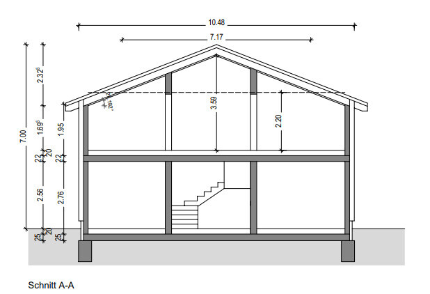

One more question: what knee wall height is planned for the upper floor? It looks like about 135 to 150 cm (53 to 59 inches).Okay, let’s think about it. We had only considered it as potentially practical, so we wouldn’t have to walk through the living area with muddy clothes, especially for our child. But we will reconsider it.
The knee wall height is 1.69 meters (5 feet 7 inches). Here is the cross-section through the house.

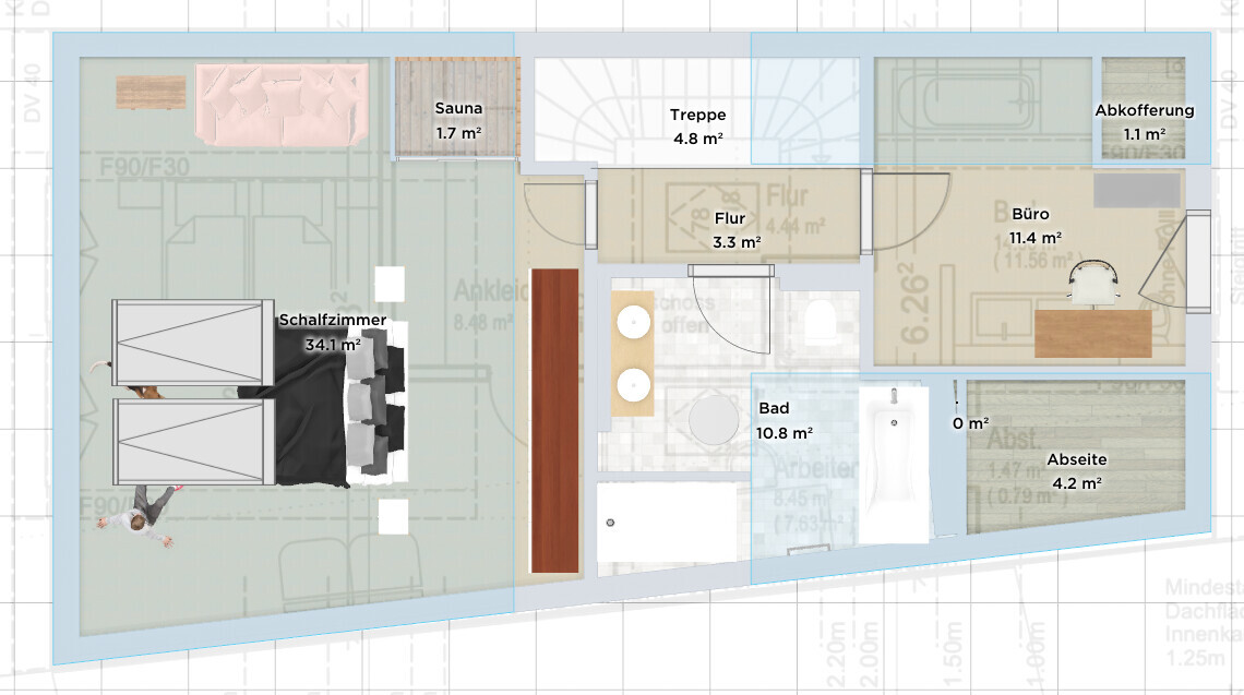

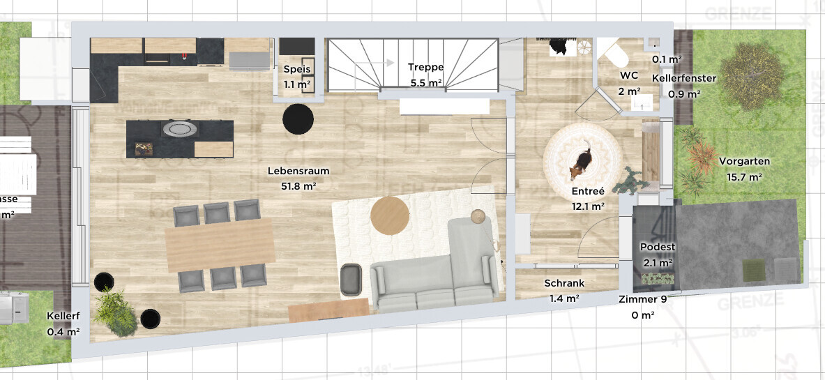

So, I have been experimenting with this for several days now. The goal is always to have a small but functional hallway on the ground floor and to maximize open-plan living space. The ongoing issue, no matter what I do, is the roof pitch/knee wall in the upper floor. The positioning of the shower and bathtub makes sense here. Moving the shower would take up too much space elsewhere, while the bathtub’s location allows good use of the sloped ceiling.
I’m attaching a screenshot of the ground floor with an alternative staircase, but the upper floor still doesn’t work, as well as a planned row house that was actually built like this (4 floors and 13 meters [42 feet] long). The reason for this: the clients wanted a master bathroom in the attic despite a minimal knee wall and shallow roof pitch. We managed this by placing the bathroom in the center and putting the office under the sloped ceiling.
