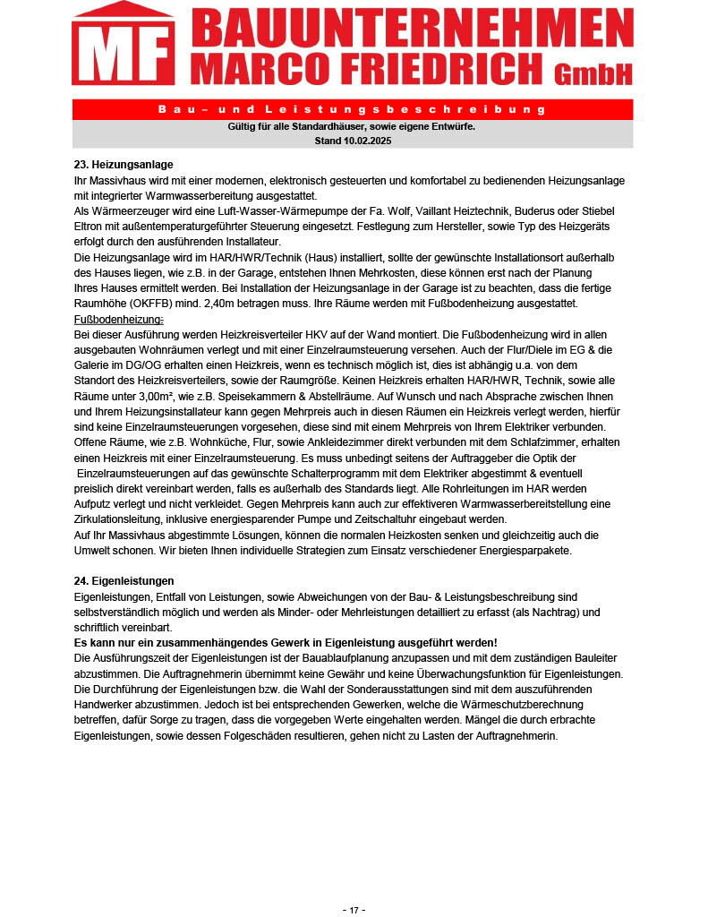

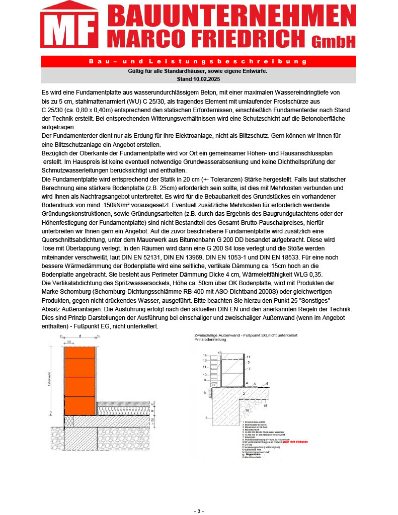

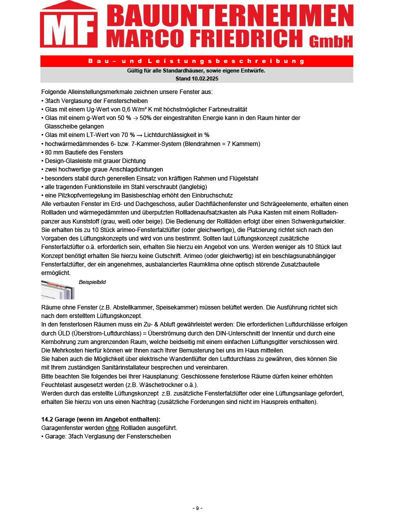

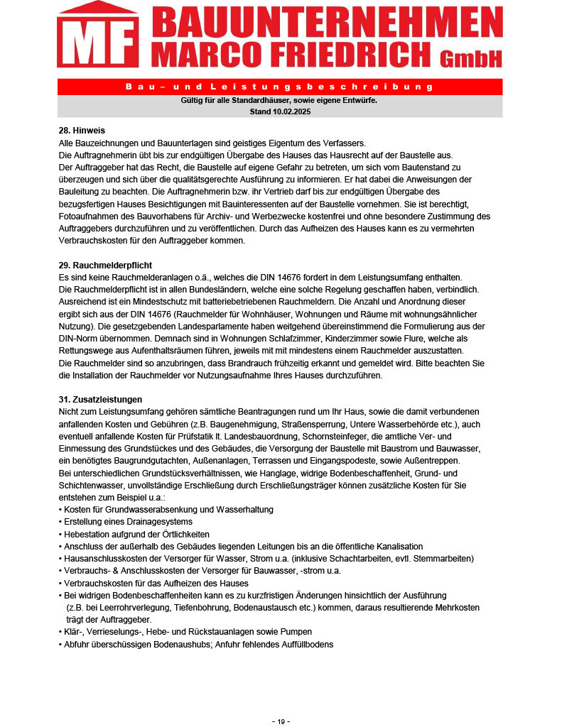

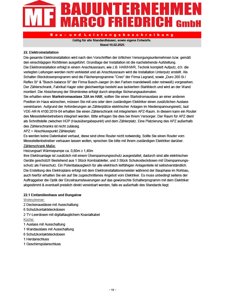

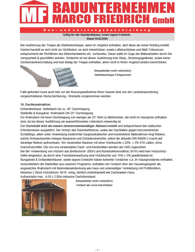

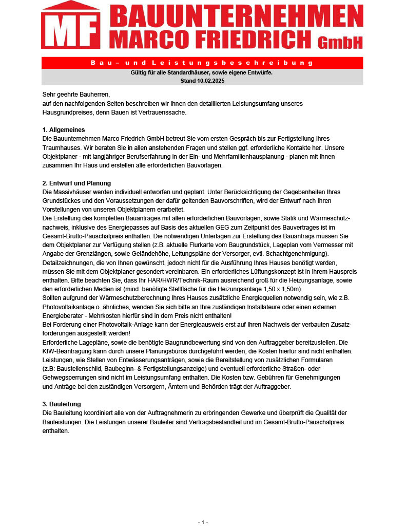

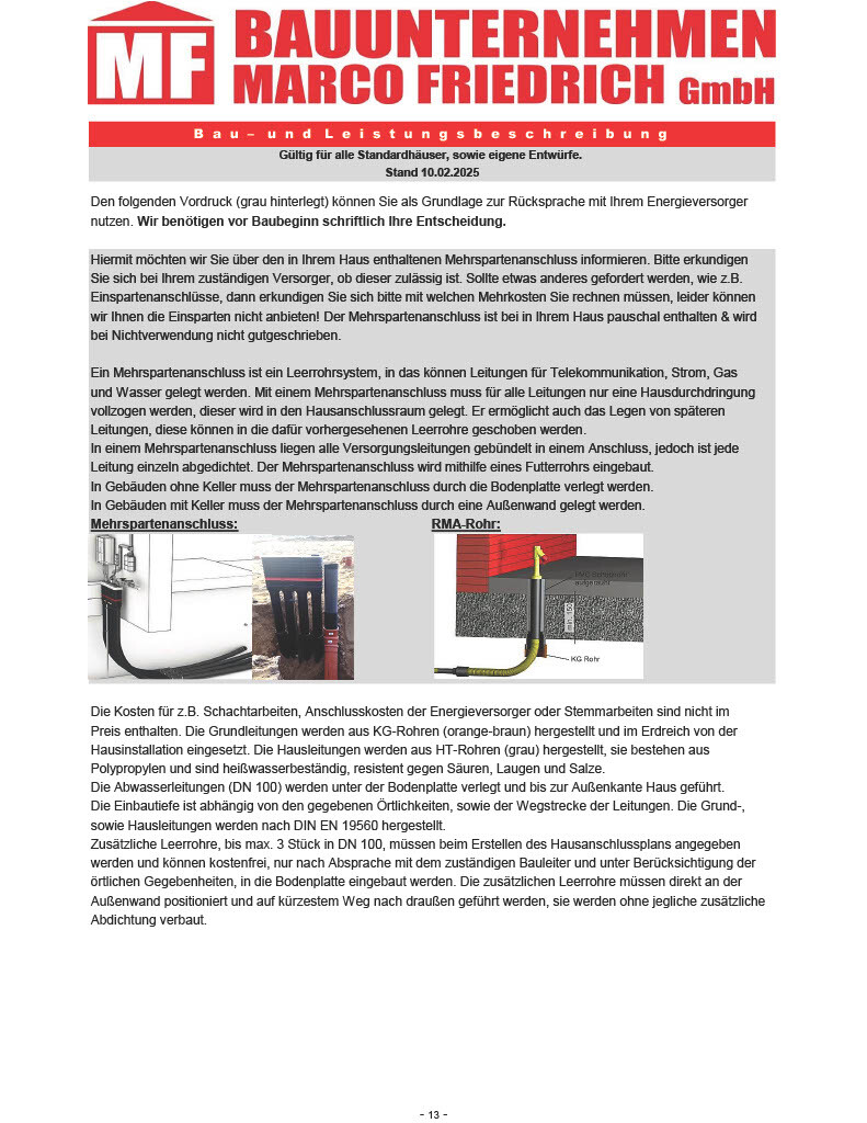

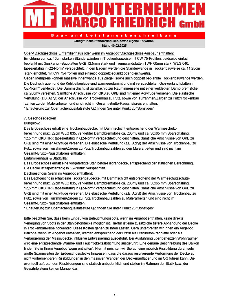

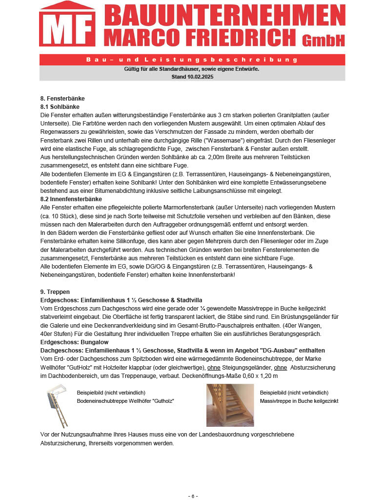

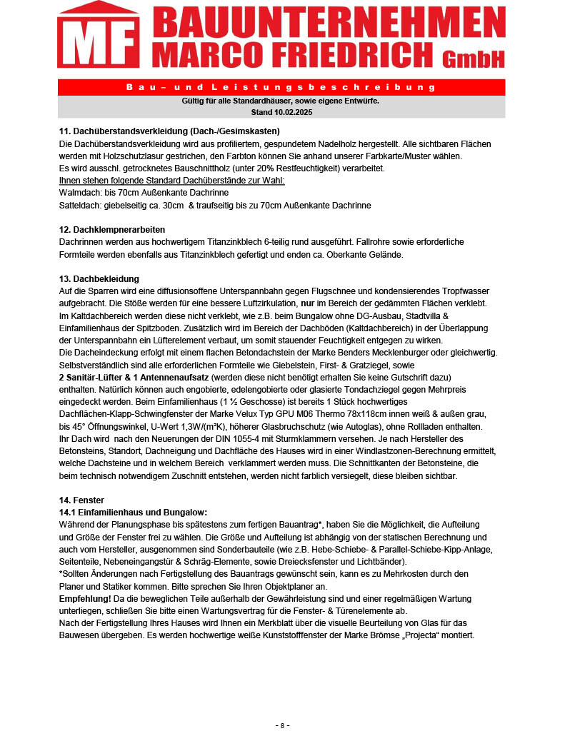

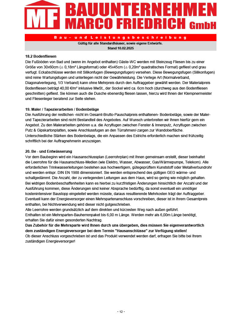

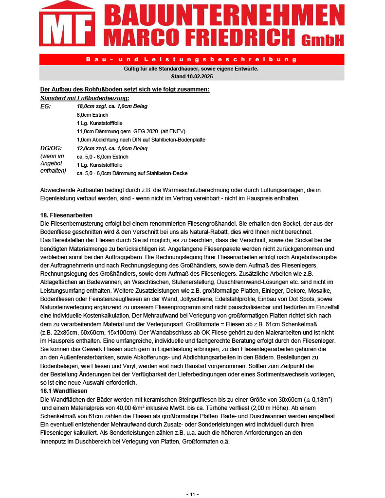

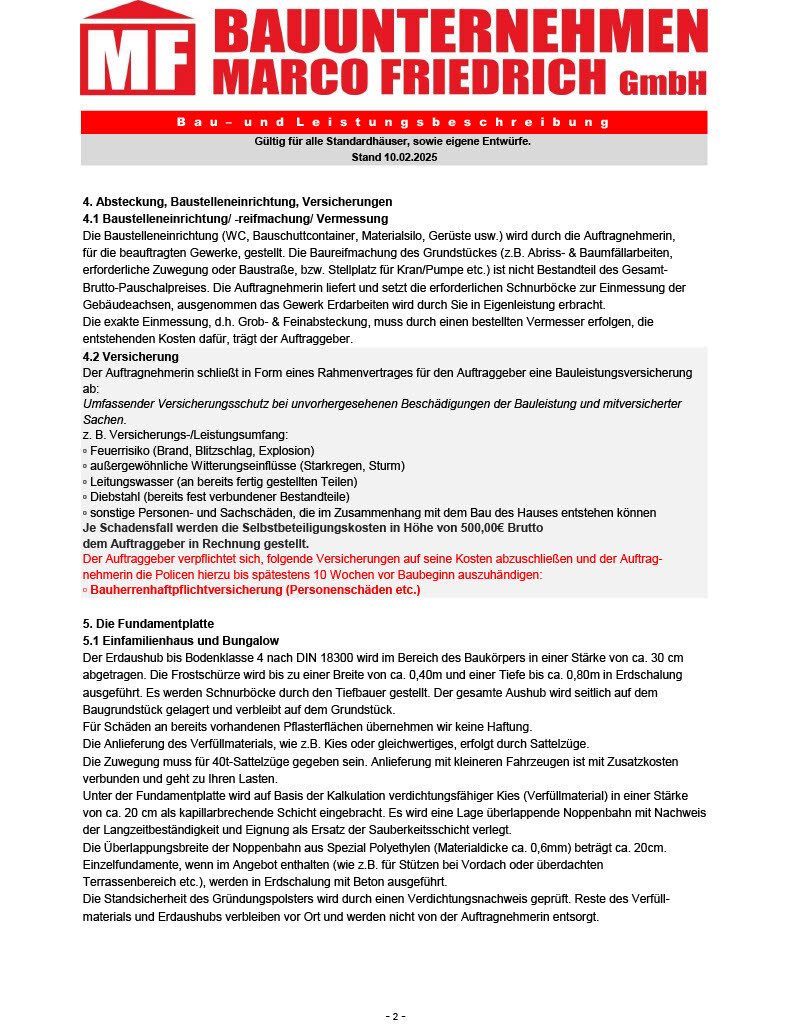

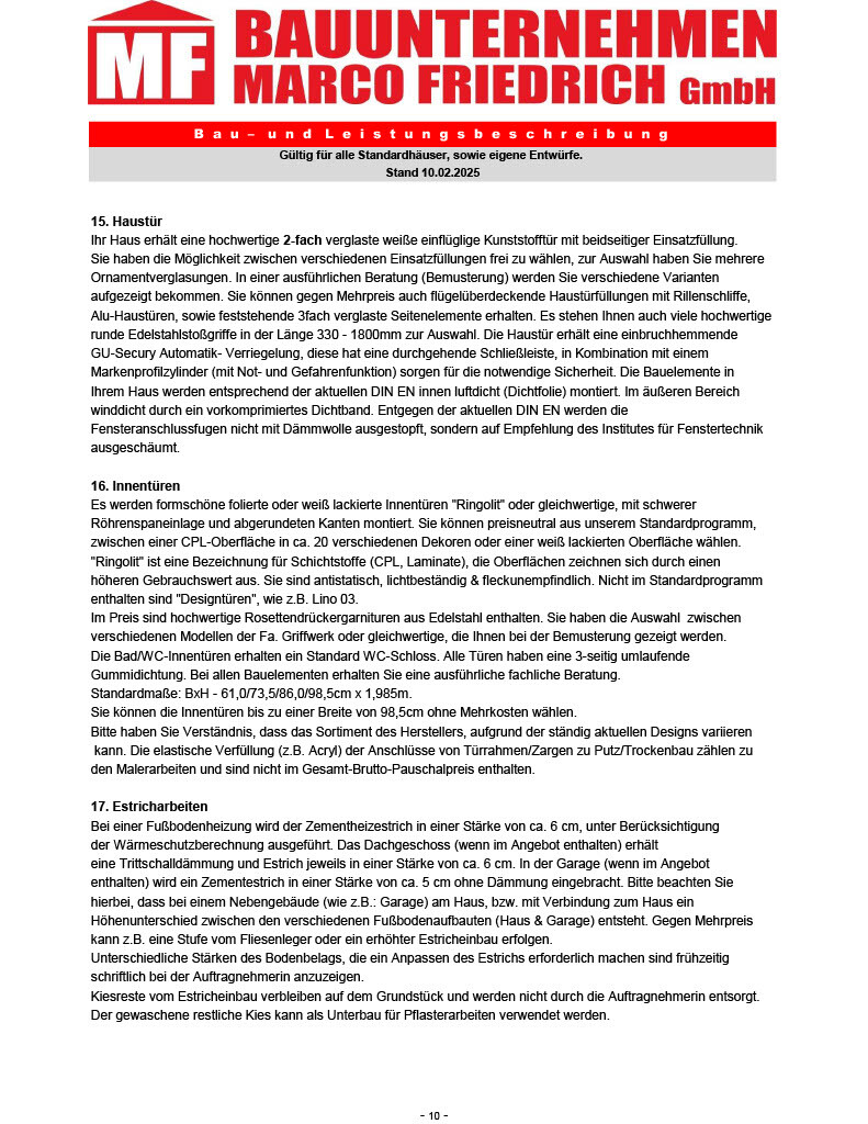

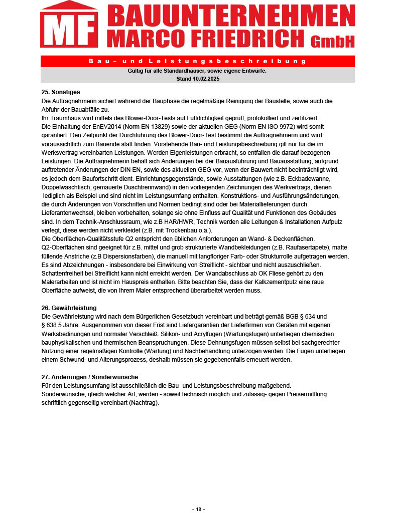

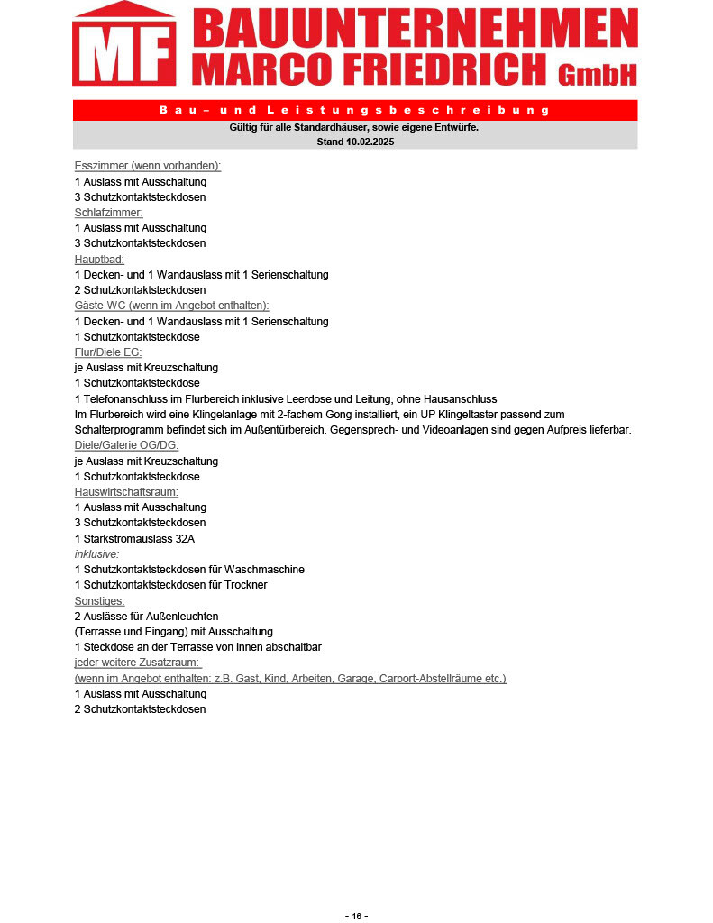

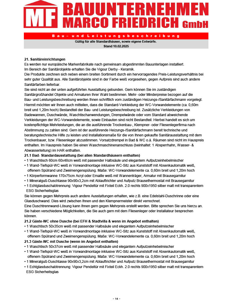

Der-Dachs29 Nov 2025 23:36I just wanted to upload the construction specification, but unfortunately PDF files are not supported. Or am I missing this feature here?
Der-Dachs schrieb:
I just wanted to upload the scope of work, but unfortunately PDF files are not supported. Or am I overlooking this function? No idea. Seems like quite a few people have this issue here and then convert their pages into JPGs.
Der-Dachs schrieb:
I certainly didn’t cover all the points, and I’m sorry about that. No need to apologize. We’re not asking anything from you and respond voluntarily.
I just feel a bit sorry that you’re sugarcoating the draft. Your requests (bright office, pantry, etc.) could be achieved with better planning, but apparently not with this building company.
Der-Dachs30 Nov 2025 00:21D
Der-Dachs30 Nov 2025 00:22Der-Dachs schrieb:
The contract fixed the size of the foundation slab at 95.0625 square meters (1,023 square feet), which corresponds to external dimensions of 9.75 x 9.75 meters (32 x 32 feet). However, the external dimensions can be adjusted.
According to the construction company and the bank, the house can become larger but not smaller. (The bank won’t agree to that) Which reasonable bank would have an issue with keeping the house size moderate?
By the way, square floor plans are inefficient; it is generally not recommended to aim for proportions closer to 1:1 than 5:4.
