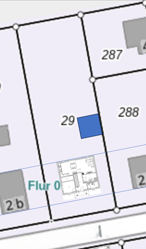

28 Nov 2025 14:44
Is this what you meant? Are there any dimensions of the plot?
Site plan of a plot with parcel 29, blue marking of the building site, corridor 0
