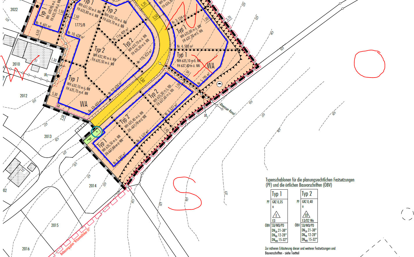

Development Plan/Restrictions
Plot size: 795 sqm (8,560 sq ft)
Slope: yes, approximately 5 m (16 ft) drop from the street side to the back of the plot, see development plan
Site coverage ratio: 0.35
Floor area ratio
Edge development
Number of parking spaces: 2 per residential unit
Number of storeys
Roof type: gable roof, shed roof, hip roof
Architectural style
Orientation
Maximum heights/limits: Wall height 635.10 m (2,083 ft) above sea level, ridge height 637.40 m (2,092 ft) above sea level
Further specifications

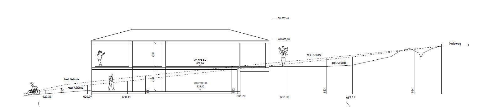

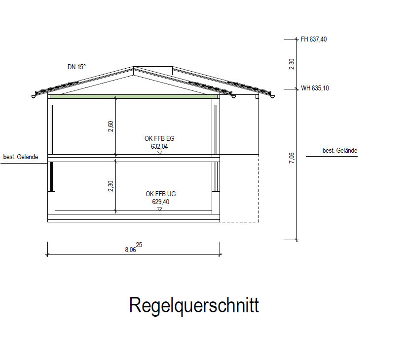

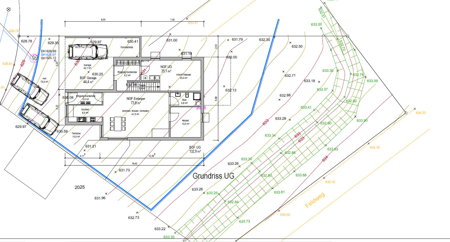

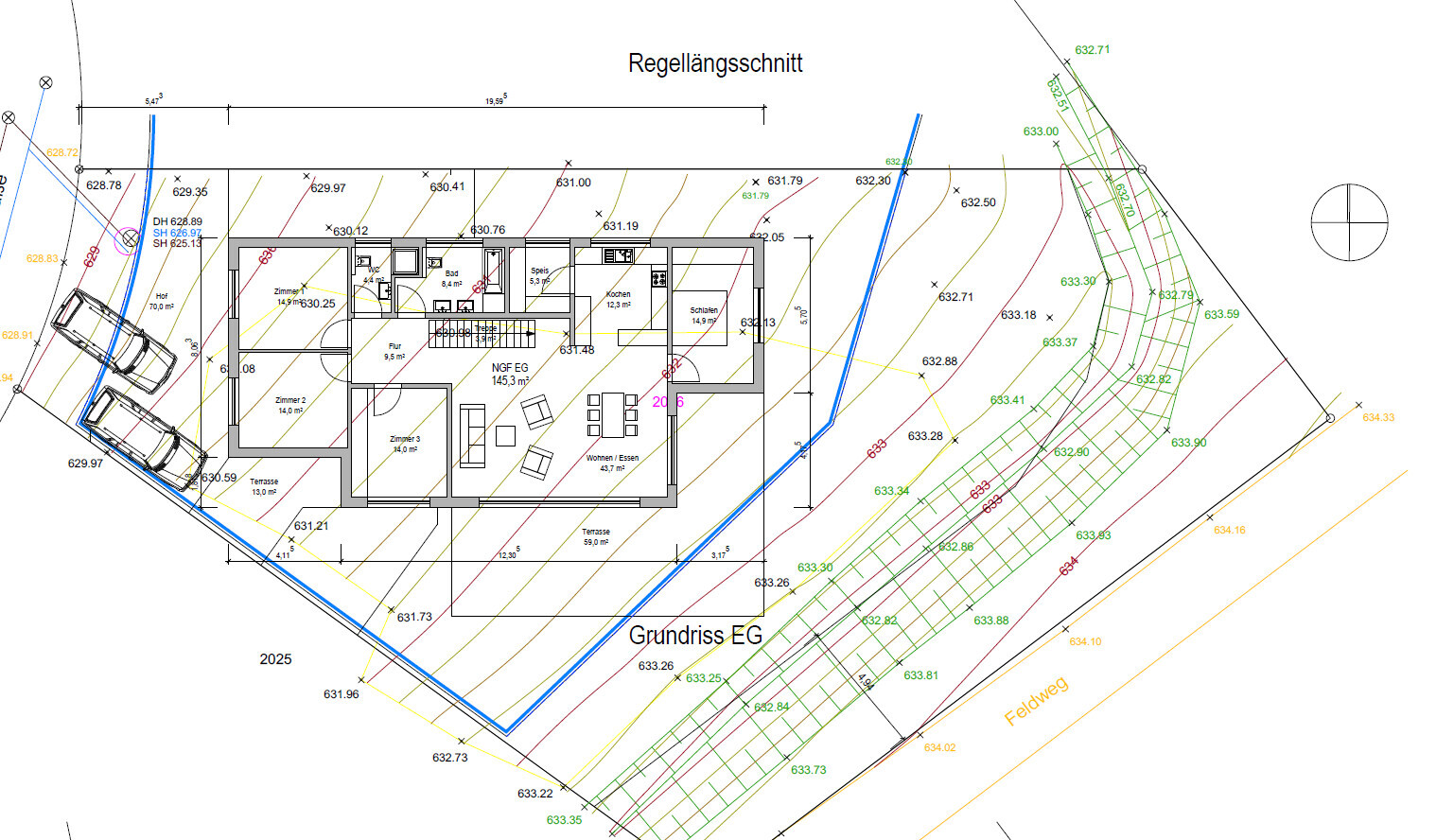

Hello everyone, I would be interested in your opinion about our floor plan. What could possibly be improved?
Especially regarding the separate apartment, how do you find the layout? Does it make sense to plan an additional room?
The purpose of the separate apartment is to help reduce our monthly expenses.

What bothers me about your plan is the entrance through the basement.
Due to the topography of our plot, we have been able to design both the additional living space and the bungalow to be accessible / barrier-free, or will do so once construction starts.
However, our additional living space faces north.

I find both apartments terrible.
The granny flat might be spacious enough for a single person, but it is absolutely insufficient for an elderly couple. You shouldn’t try to justify it by saying the bedroom windows can be adjusted or something like that. The living area, which is also intended for sleeping, ends up being very dark. While a slope often leads to living space in the basement, which I also usually prefer, here you are basically entering a cellar room because the terrace of the granny flat on the ground floor takes away a lot of living quality.
I have seen many much better basement apartments with granny flats or living spaces.
Regarding the main apartment:
I am a fan of few walls and open-plan living. For that, floor plans can be quite unconventional. As someone without children, I can afford a freer style of living since I only have to consider my partner.
But here, there is absolutely no privacy for the parents. Where does the partner go during a card game, football match, or girls’ night? Yes, one could build a wall, which at least creates a TV wall. But it would also create a huge hallway. The way to the bathroom always passes through the kitchen. Great if you’re not feeling well or want to take care of personal hygiene, but the kids are entertaining guests and occupying the dining table.
For the granny flat, you sacrifice a nice, conventional, and spacious floor plan. Instead of an optimum, you plan two living units full of compromises.
My advice: instead of planning four parking spaces, build only two, go smaller, and give the kids a nice children’s floor in the basement. When they move out, you can still have one or two seniors living with you.
