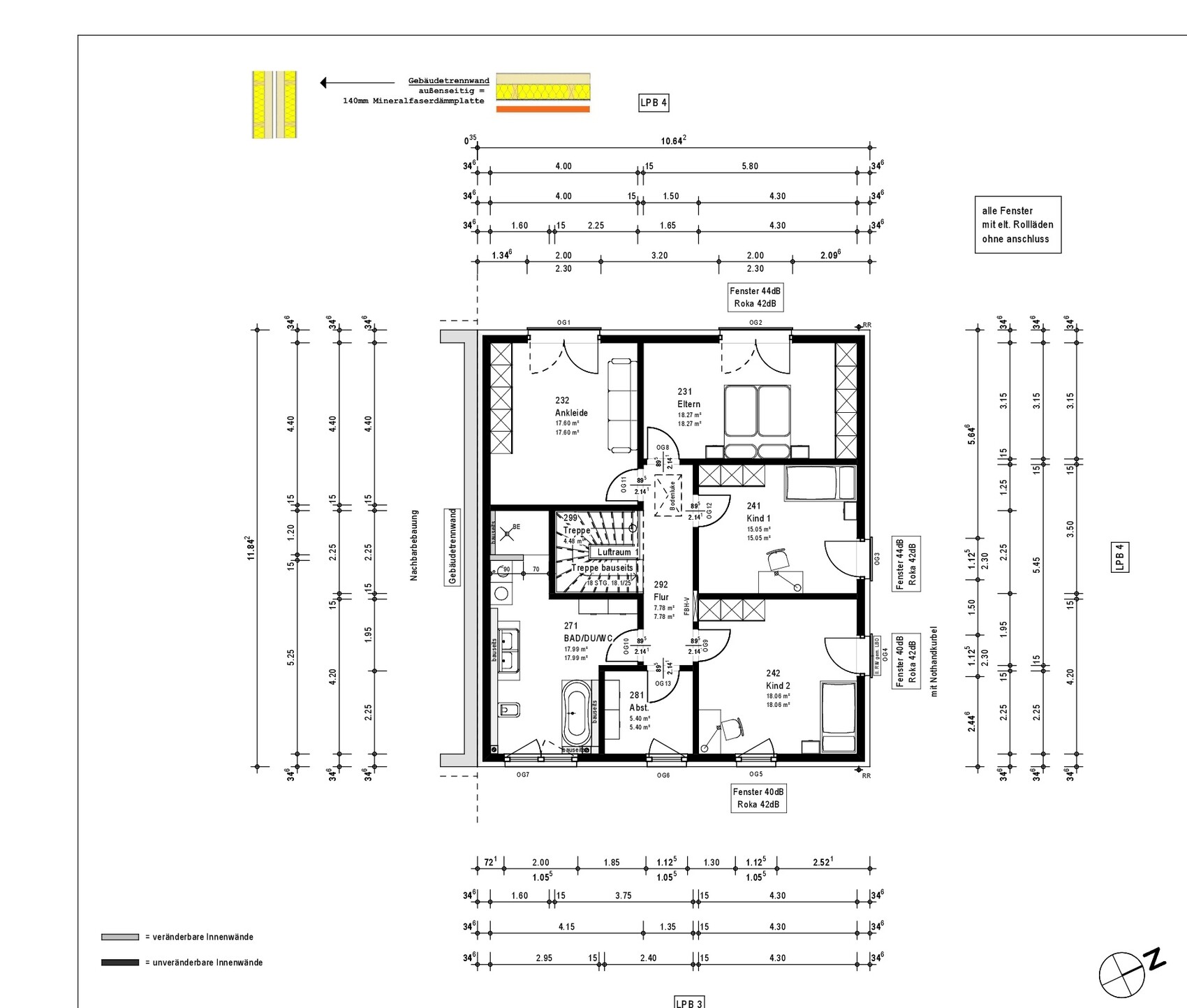

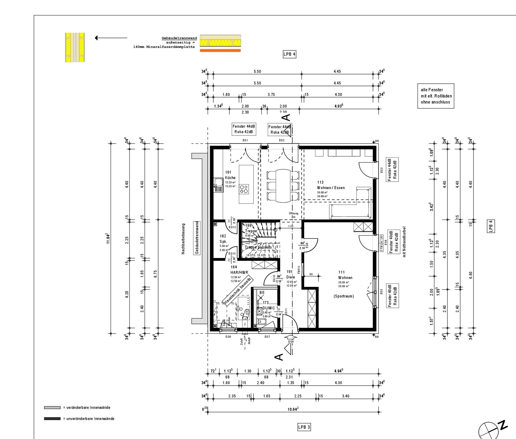

Space requirements on ground floor and upper floor:
Ground floor – living room, kitchen, pantry, utility room, guest toilet, fitness room
Upper floor – bedroom, child 1, child 2, home office, bathroom, storage room
Attic –
Office: home office
Overnight guests per year: 2
Open or closed layout: open
Traditional or modern construction: modern
Number of dining seats: 4–6
Fireplace: no
Music / stereo wall: no
Garage, carport: yes
Additional wishes / special features / daily routine, also reasons for preferences or exclusions
Planner: do-it-yourself
What do you particularly like? Why?: The space behind the stairs is used as a pantry / storage room.
What do you not like? Why?:
The living room feels cramped because of the fitness room; overall somewhat dissatisfied with the layout but not sure what is missing.
Hallway possibly too narrow? Especially in the entrance area.
Price estimate according to architect/planner: 430,000
Personal price limit for the house, including equipment:
Preferred heating system: underfloor heating
If you have to give up, which details / extensions
- can you do without:
- can you not do without:
Because we are building a house attached on the left side, no windows can be placed there, but of course we would like to have windows in all rooms. We can do without windows in storage rooms and pantry.
The staircase is meant to allow continuous access from ground floor to attic without taking up much space. In general, we would like to use as little space as possible for corridors.
The biggest issue is that we cannot place windows on the left side of the house, which limits room distribution.
We are also unsure if the staircase is the right choice for saving space. We tried to position it so the attic exit is relatively central.

Over 200 sqm (over 2,150 sq ft) for 2 people? That is already quite a lot for 4 people. And whether it will indeed be 4 is something you can never really know or plan for in advance. You also don’t seem to be among the wealthy who can just afford it without worries (considering a lot of self-work). I would advise you to build a house that you can afford and use efficiently, not one based on what you wish for. These two things are often very different….
I still don’t fully understand many of the basic conditions: how fixed is the unusual plot division (I don’t see any specification for single-family/semi-detached in the development plan or its excerpts, although the remaining plot next to you is only developable for single-family homes) # what are official building envelopes and what are the house positions envisioned by the land developer, this is not clearly distinguishable here # where do the 7.0 or 7.6 m (23.0 or 24.9 ft) building setbacks come from ...?
Basically, I advise against planning a semi-detached house separately (the Goakeeper thread should really be required reading pinned on the homepage!) and here I miss even the slightest indication of coordinating the house profiles. For two-and-a-half stories, a floor area ratio of 0.6 corresponds approximately to a site coverage ratio of 0.24 (not fixed, but something to consider). But I mention this only for completeness, the budget alone will brutally resize the house, and everyone except the original poster is probably convinced of that. I won’t go into more detail here, but not only the thin walls give me the impression that the self-planner still lacks a proper sense of scale.

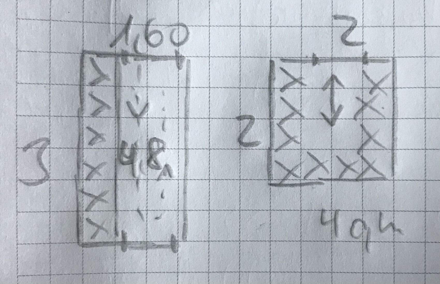

EddyDeluxe schrieb:
I don’t see why you would need a lot of space for a pantry or storage room?I certainly do know how to plan it better (I didn’t write what you mentioned, I was referring to corridors/space), especially if you want to stack bags or boxes somewhere without them being in the way. A simple example:
Your example shows 3 meters (10 feet) of storage space next to 5 meters (16 feet), even though the room is smaller. If you skip the cabinet at the bottom of the plan, you would have 4 meters (13 feet) of continuous space plus storage options for boxes or bags. What matters even more is the upper floor – there is hardly any spot to put down a suitcase, garden chair, ladder, or similar items because there’s no available space.
