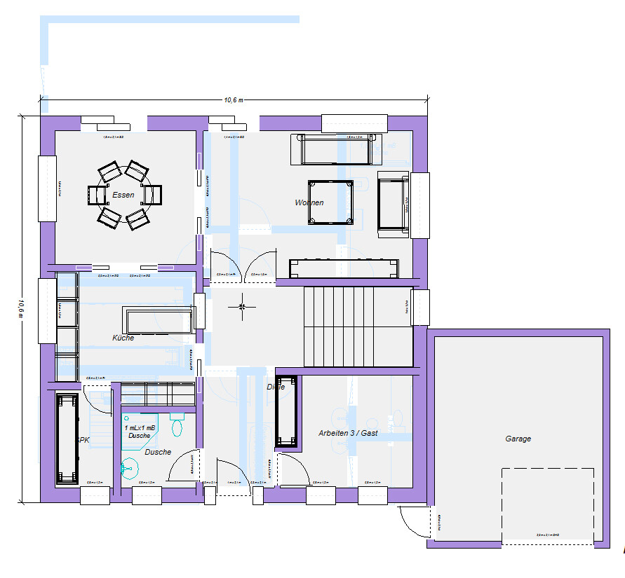

We have already made good progress with the floor plan for a single-family house (see image of the ground floor).
A friend of ours mentioned that the corridor leading to the kitchen/living area on the ground floor, with rough construction dimensions of 1.07 and 1.16 meters (3.5 and 3.8 feet), seems too narrow from his point of view. He suggested that we should make the house at least 25 centimeters (10 inches) wider to allow more space here. However, we would prefer to avoid this with regard to costs, as the house, measuring about 9.0 x 12.5 meters (30 x 41 feet), is already quite large and fully covers our desired room layout.
Do you see any significant reason to consider that the corridor width in the hallway is too narrow and that we should revise the plan?

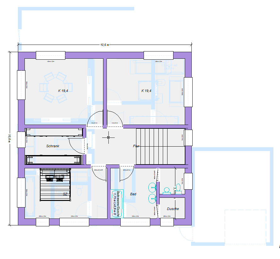

I don’t think the original floor plan is that bad given the conditions. However, the staircase is really awkwardly placed right at the edge. Since it forces the ceiling height to be 2.50m (8 ft 2 in), it’s actually too short, and the space still isn’t sufficient.
You might have better luck with a straight staircase. Here’s a sketch. You could also swap the bedroom and bathroom depending on your preferences. (How important is this T-junction?) However, if you do that, the hallway window upstairs will be lost—unless you significantly reduce the size of the dressing room.

The platform staircase requires more depth. The plot and house would actually fit well, leaning more toward a square shape. Just a little experiment with two nice large children's rooms. The floor area remains the same—so the price is neutral.
