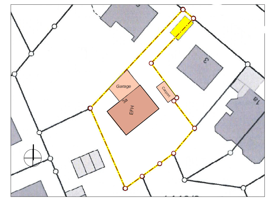

At first glance, I would position the house like this to have a nice, large garden. The entrance would then be more from the side. Would this lead too far into rethinking the entire ground floor?
I would leave it as is. But certainly, the site should determine the orientation here.
Rotating the staircase with this house size is also impractical, as it would reduce a lot of usable living space, which would be unfortunate. Maybe simply swapping the kitchen and living room would work. Since the kitchen is to be separated, open up the dining area opposite the staircase, rotate the table to create a great line of sight. Then place the living room where the kitchen was...
What bothers me a lot here is that when you stand in the hallway, you don’t really feel welcomed by the house. There are shelves in the hallway, a small window for peeking, and the staircase turns away. Behind the staircase, there is another hallway section, which I’m not sure where it leads. I would probably end up in the office for orientation.

kaho67427 Jul 2019 11:07
I would advise against it. But certainly, the orientation should be determined by the site conditions here.
Also, the question is whether neighbor No. 3 has a view from their terrace into your garden? The original poster would need to clarify their preferences on that.
