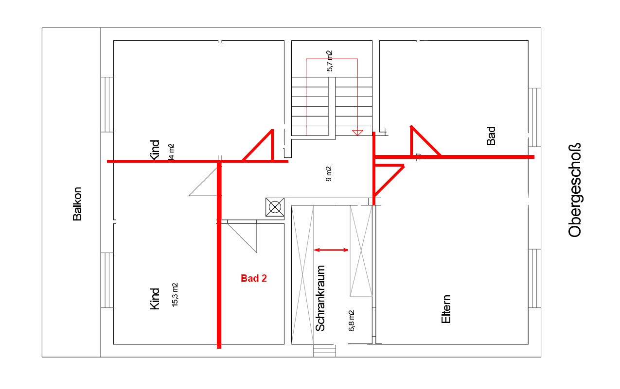

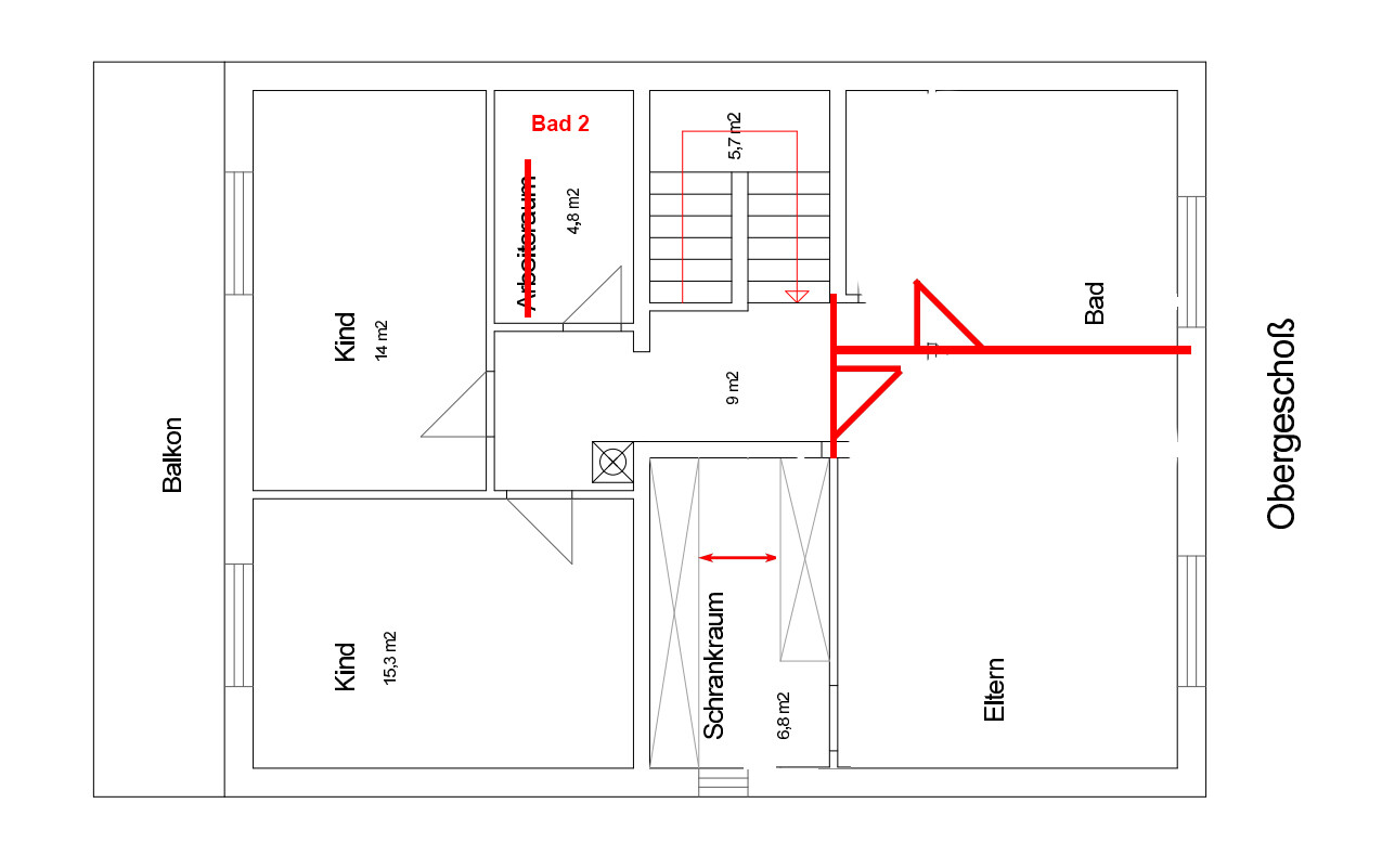

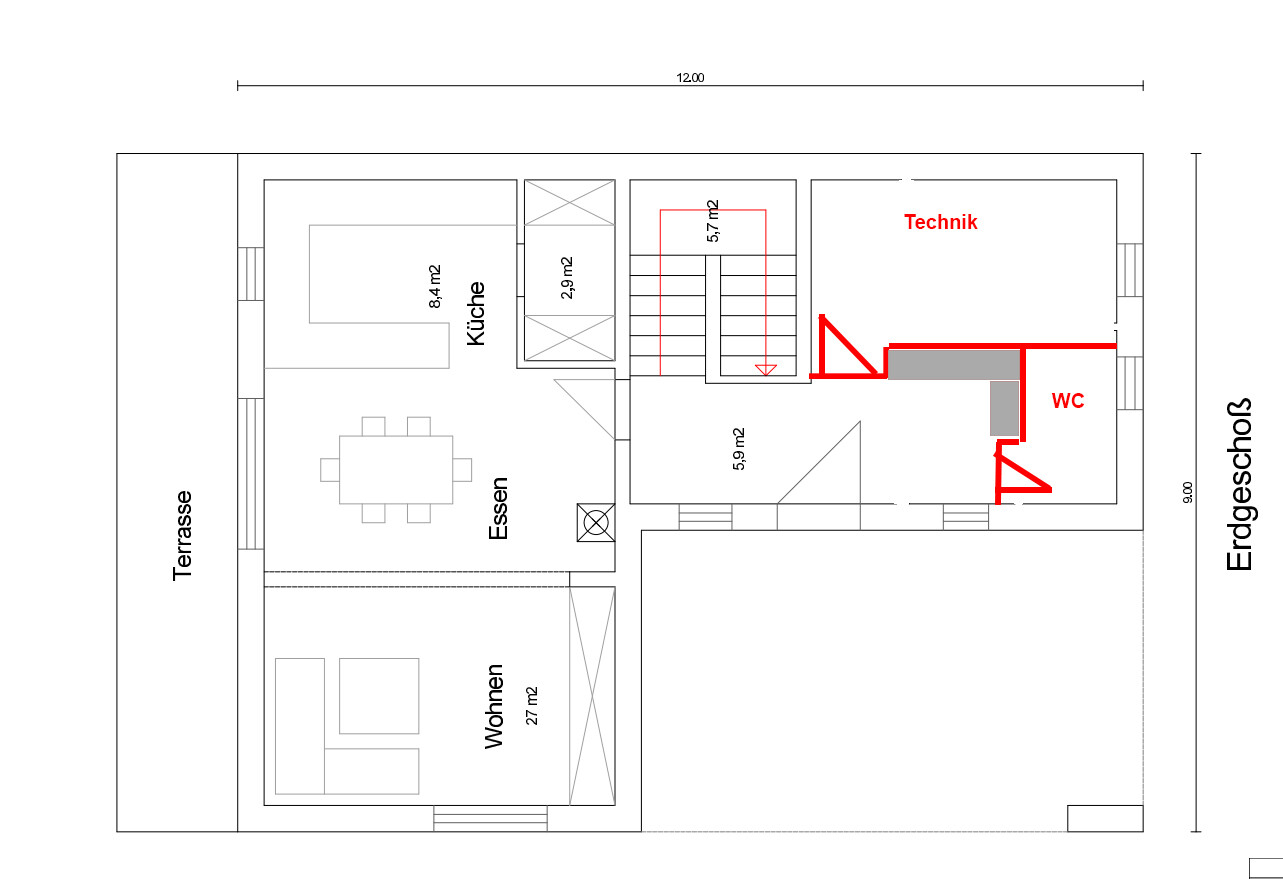

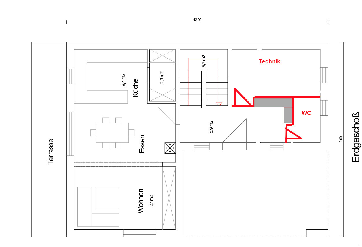

Remove the bathroom downstairs and instead place the utility room and house service room (HAR) there. Convert the upstairs workspace into a childrenâs bathroom. Integrate the toilets into the bathrooms and connect the master bathroom directly to the bedroom.
Oops, then bathroom 2 has no window â sorry, I briefly forgot that. My mistake.
