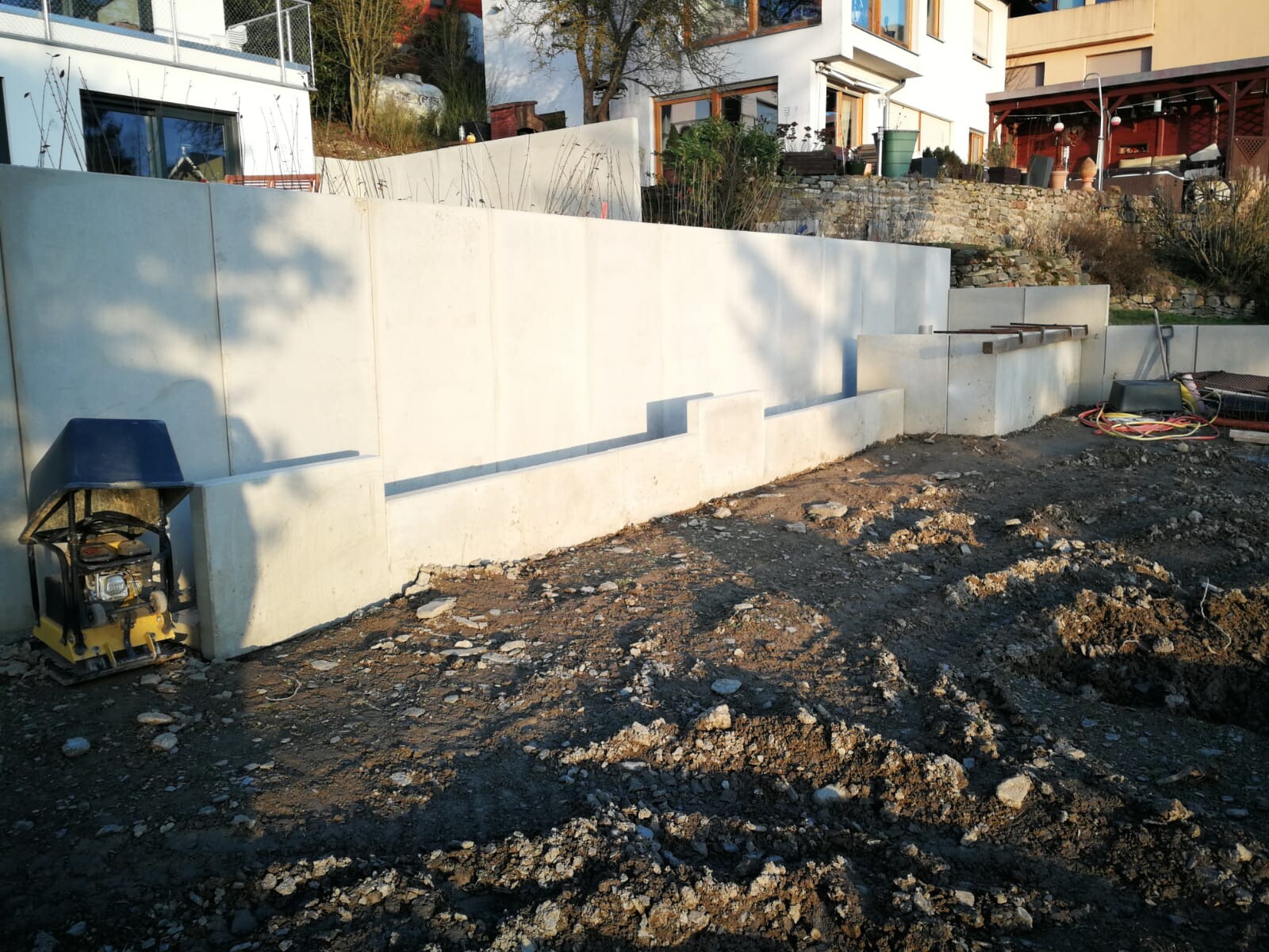

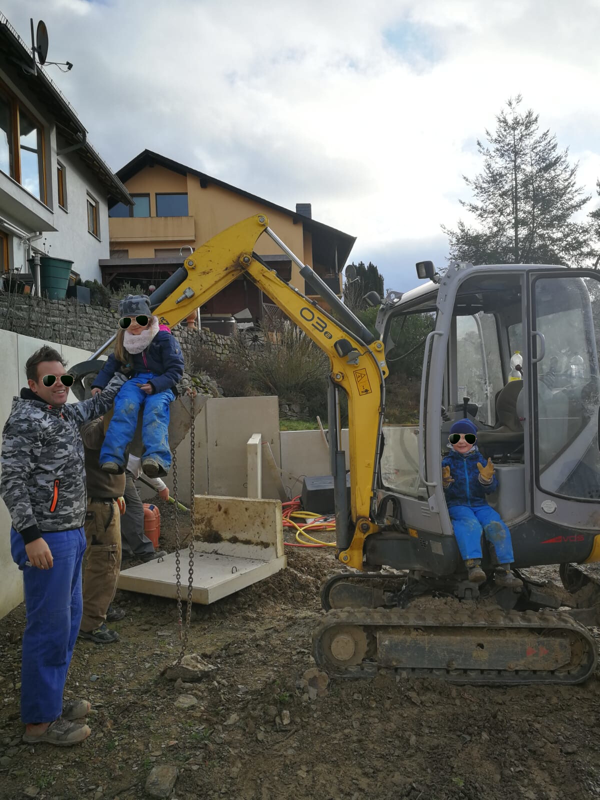

We've been working with L-shaped retaining blocks again. Gradually, I'm becoming quite confident with the excavator, and the helpers trust me as well. Wooden slats for sitting and lying down will be placed on the lower areas, and some plants in the higher sections. We'll see how it turns out.
Overall, we already feel very much at home, and especially the children still enjoy the natural surroundings. Even at 9 a.m. during breakfast, you can watch deer nearby. A squirrel often greets the children in the mornings on the stairs.

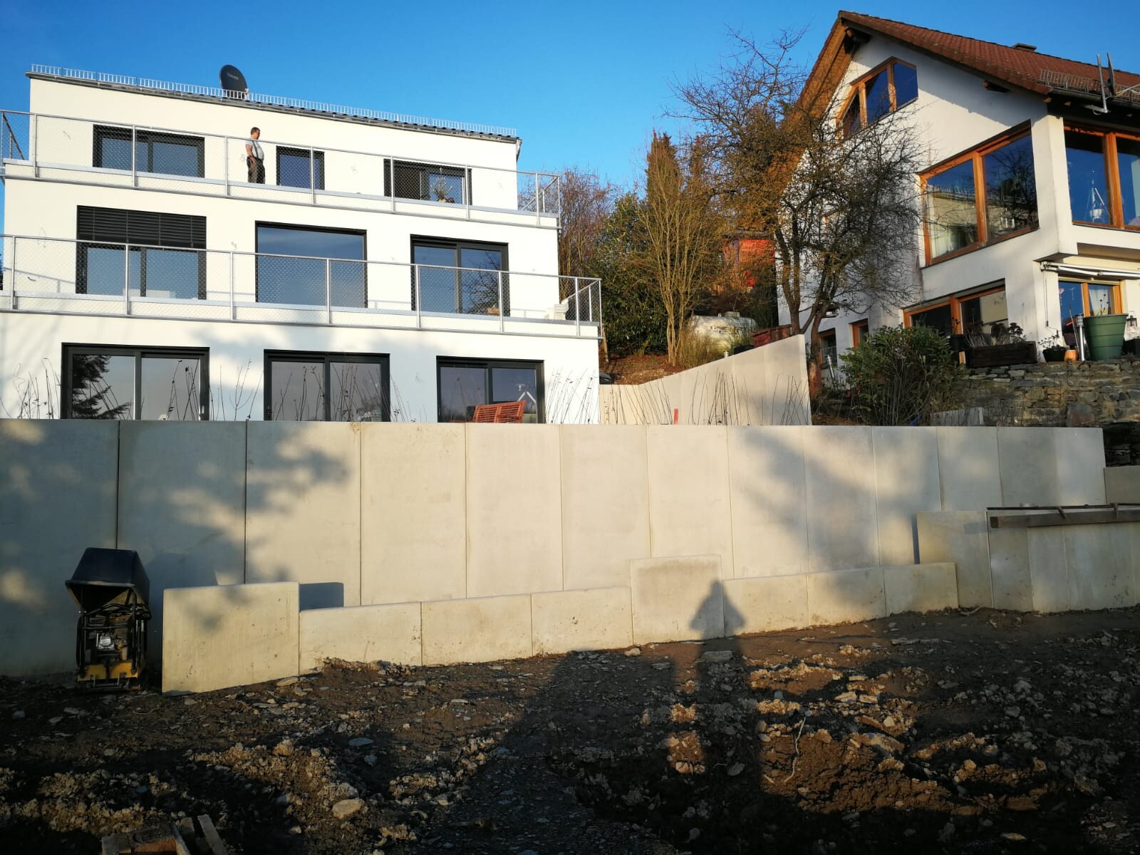

Luckily, the buckets were still hanging. Water is dripping again through the lamp cable openings in the ceiling—specifically the front openings located under the balconies. Interestingly, the leaks run from the attic to the ground floor and from the ground floor to the basement "only" sideways, meaning where the sliding doors are. In the middle of the attic, there is a regular balcony door, and in the middle of the ground floor, a fixed-pane window.

During heavy rain, water is leaking through cable drill holes in the ceilings from the basement and ground floor into the living area. Those present suspect that water can run under the vapor barrier on the exterior side in the area of the lift-and-slide door systems. In a test, approximately 200 ml (7 fl oz) of water was injected with a syringe into the inner corner between the vertical window frame and the horizontal aluminum profile at the bottom. The water immediately disappeared and shortly afterward flowed through a ceiling light outlet in the floor below. About 13% of the injected water ran directly from the ceiling....
