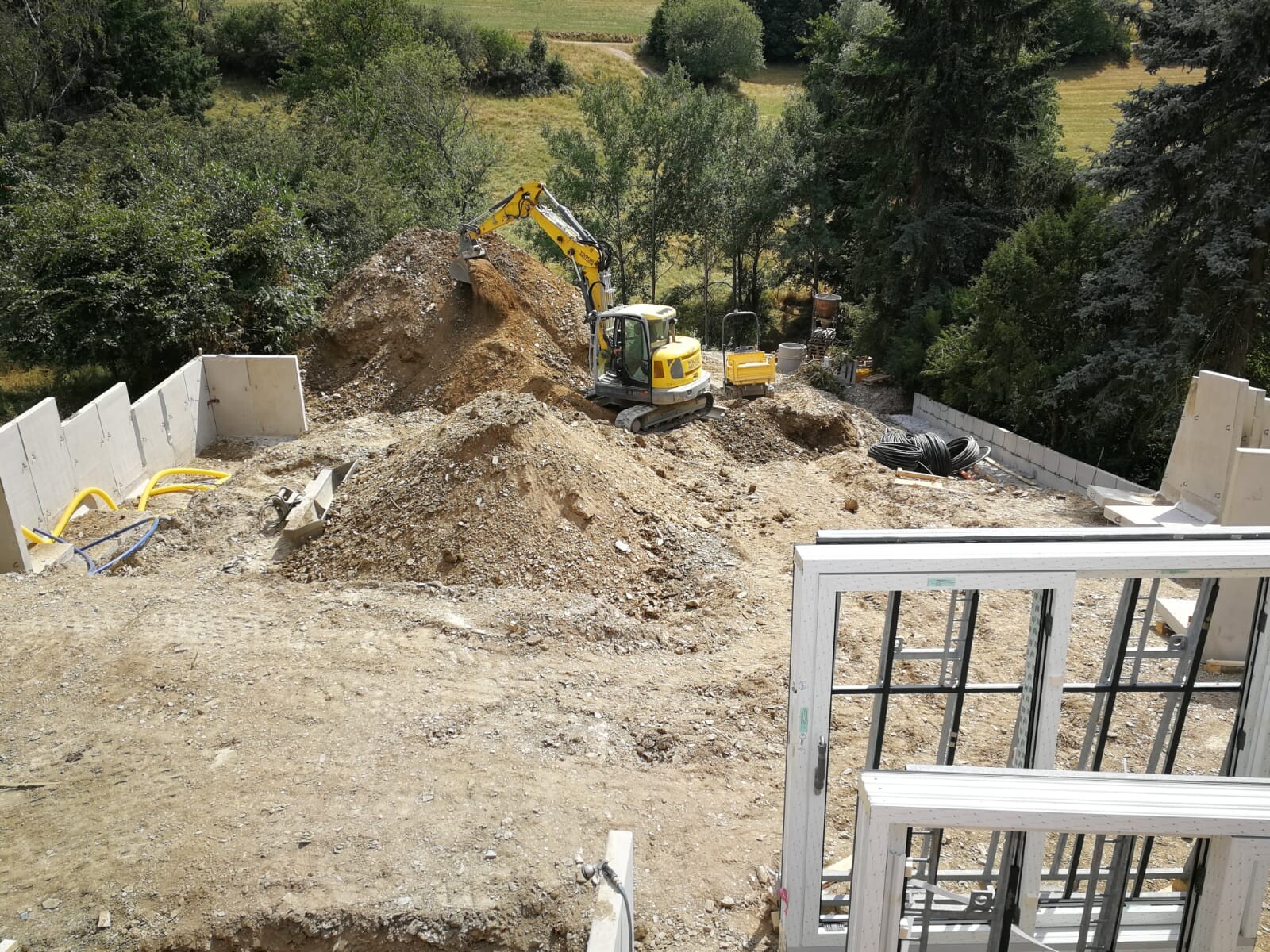

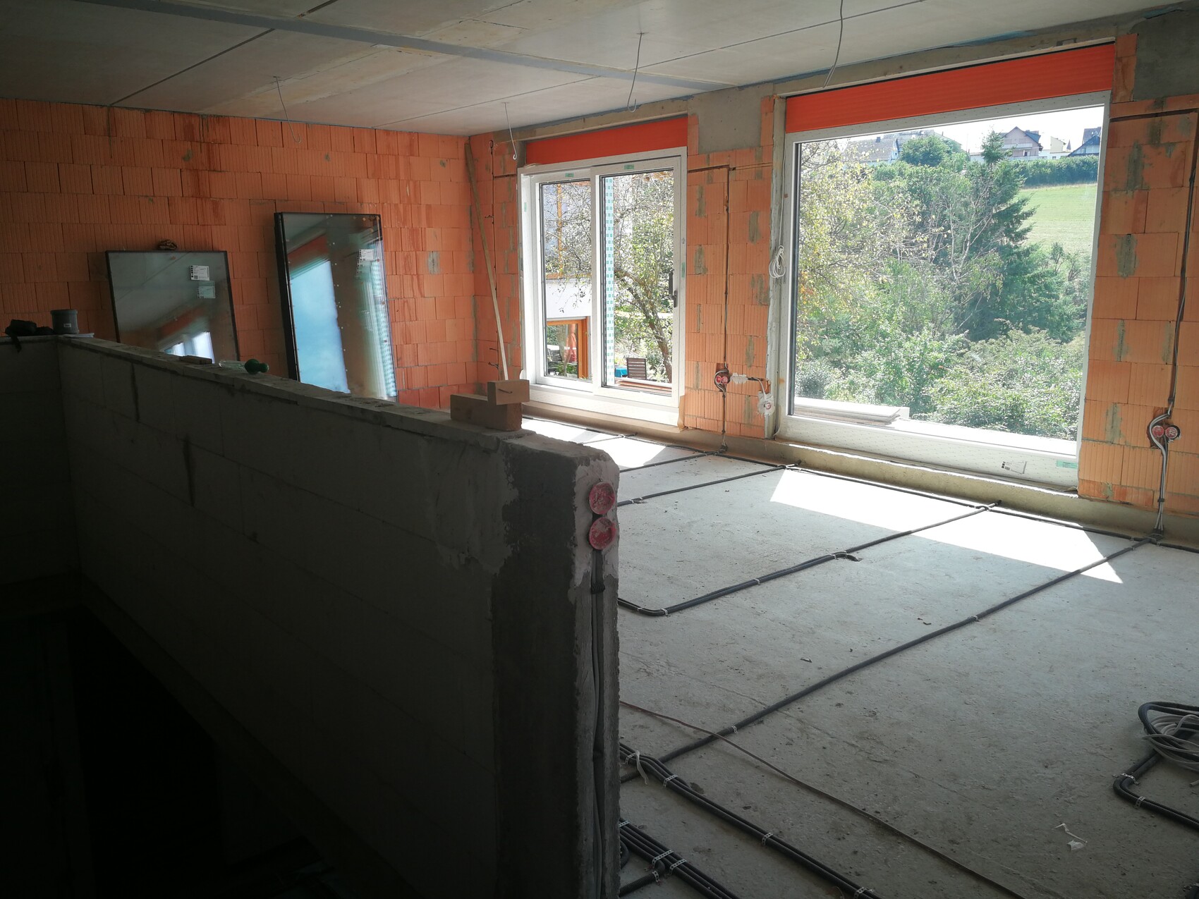

Four of the seven sliding doors need to be re-delivered. It should take about six weeks. We accepted three of them as a goodwill gesture. These are the ones on the lowest floor for the children's rooms. The passage height is only 2.05m (6 ft 9 in), but should be sufficient. For any others, we would have insisted on replacing all the windows. We don’t gain any advantage from this. It would have been possible to continue with the interior work on the lowest floor separately from the two upper floors, but now everything has come to a complete "stop."

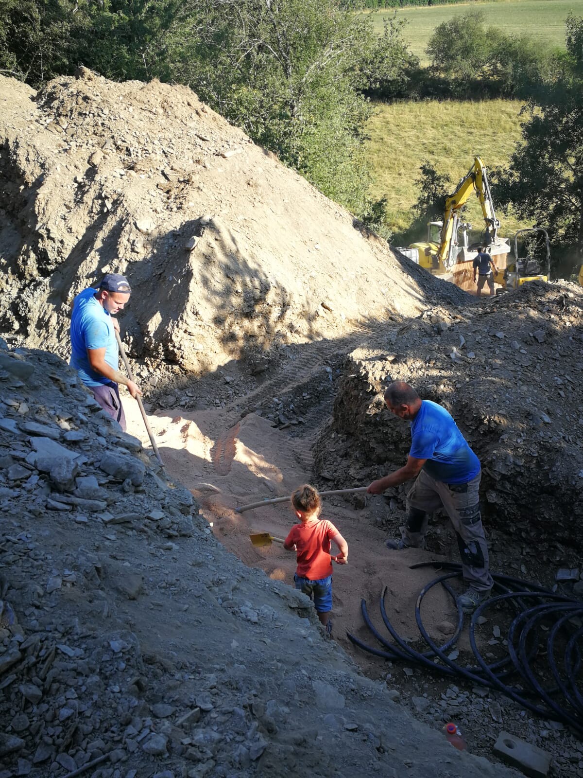

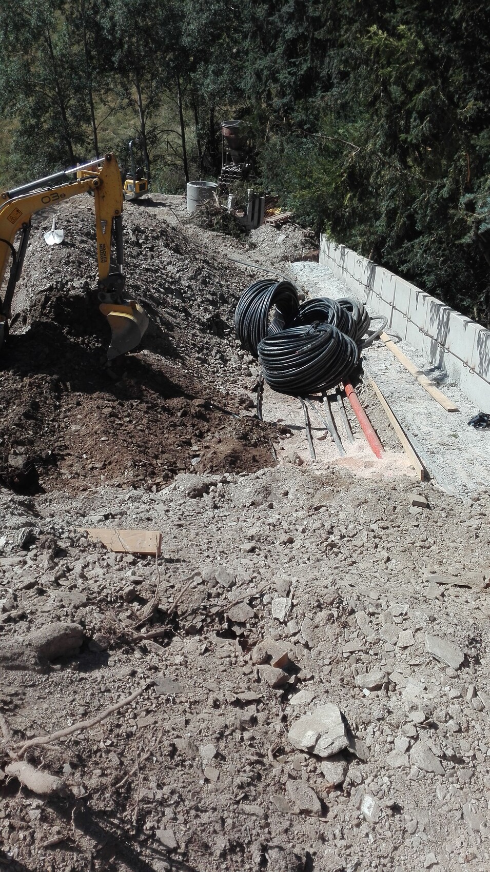

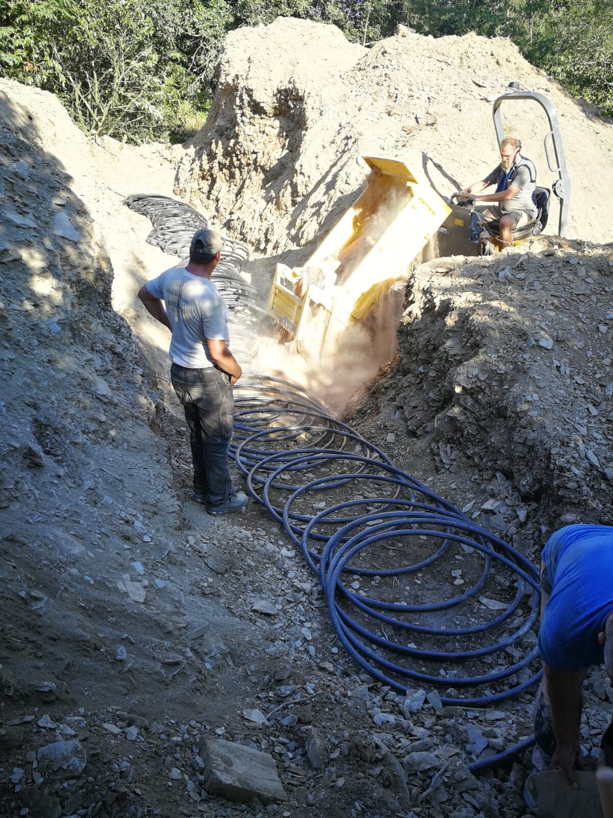

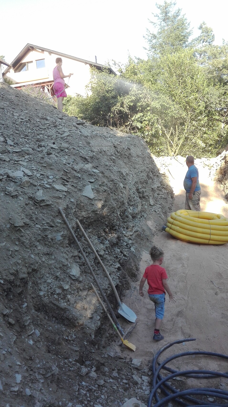

The four ground collectors, each 300m (980 ft) long, were also buried and connected to the manifold. So almost no more earth will be moved in the garden. It was quite annoying because only one trench could be dug at a time for each collector, and the excavated soil was basically piled on the next trench. The trenches couldn’t be opened simultaneously. That meant every pile of soil was moved at least five times.

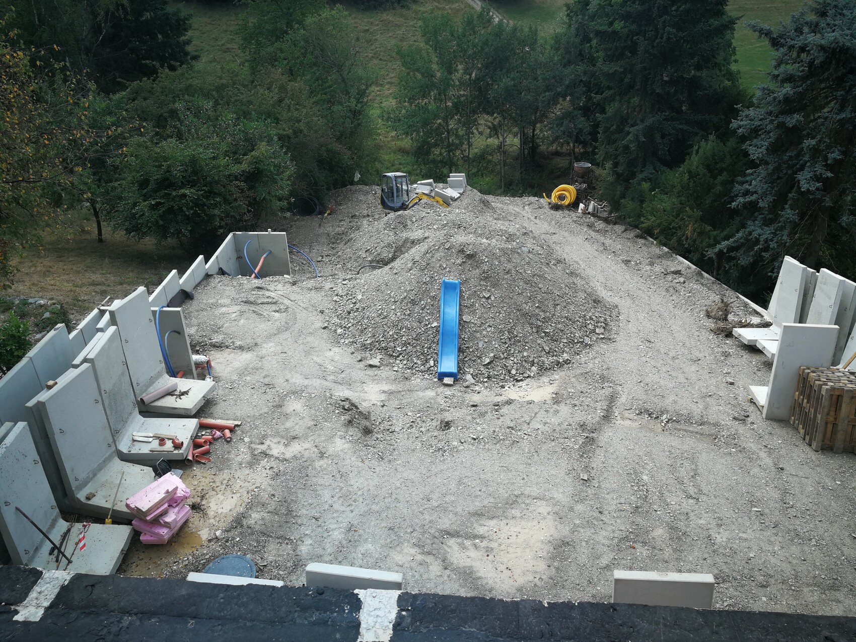

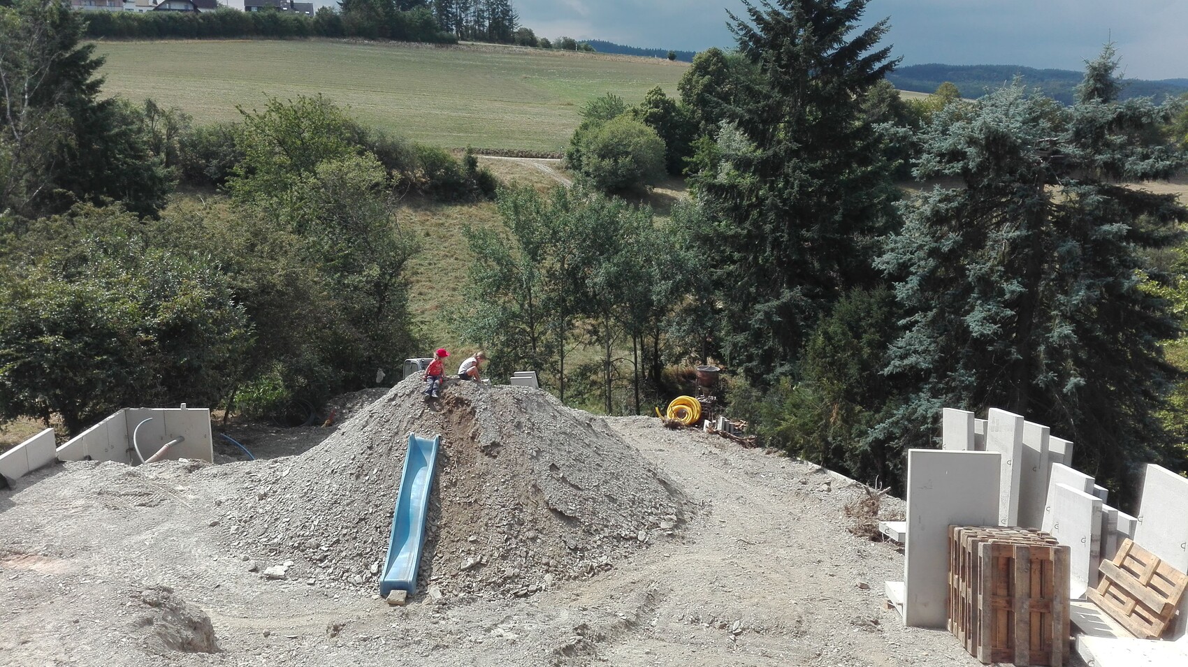

sichtbeton826 Aug 2019 14:46And true to the saying "when things go wrong, they go really wrong," we had to find out that L-shaped concrete blocks were spray-painted with old-fashioned symbols. Fortunately, none were on our property. However, some blocks had to be stored outside in a field. This was agreed upon with the landowner, who also received 3-4 truckloads of free excavation material. Luckily, most of the L-blocks were placed with the front side against the ground, but those that were standing upright were vandalized...

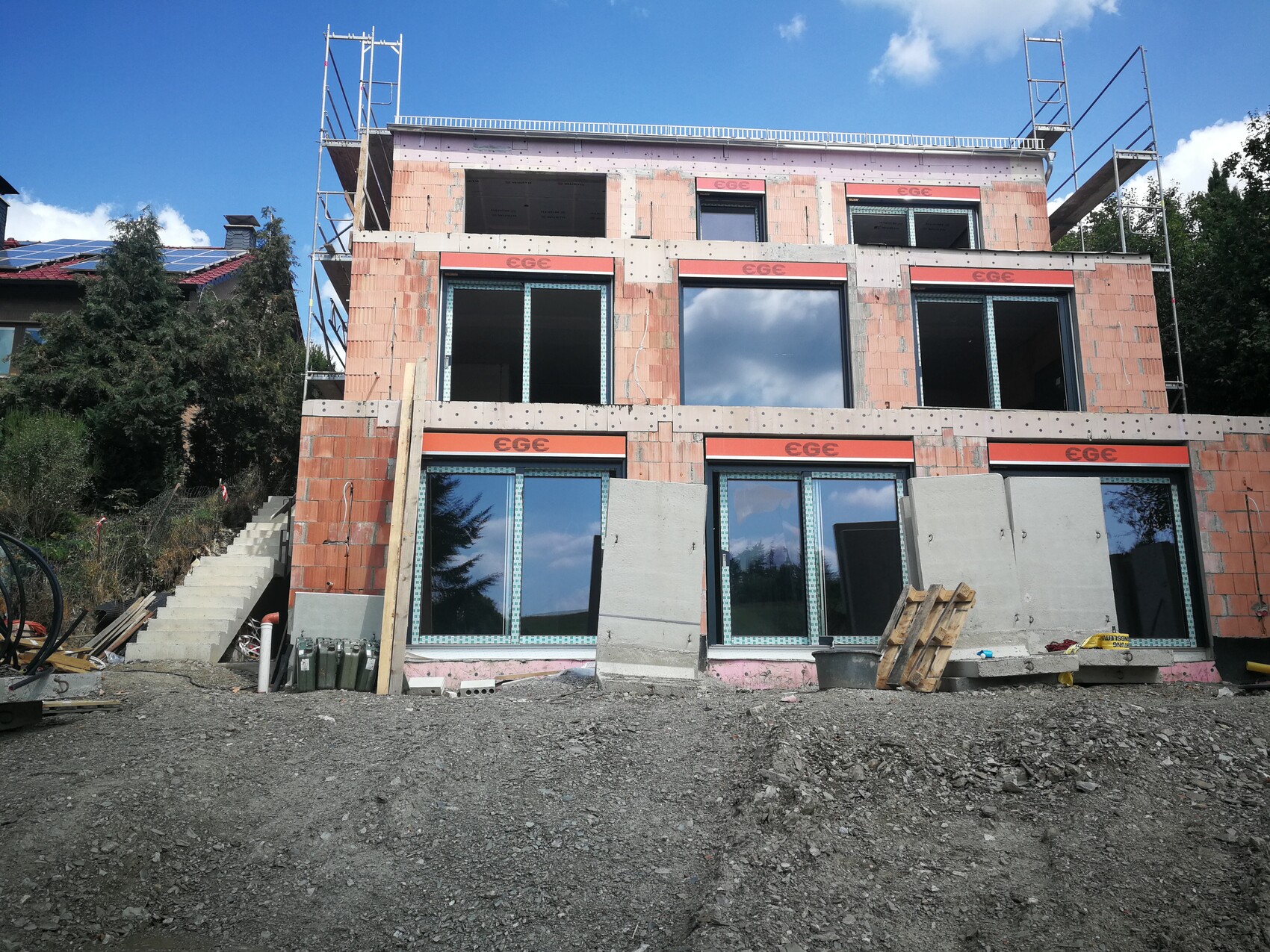

sichtbeton825 Sep 2019 11:23Almost exactly one month of standstill since the last post. Not much has happened on the construction site. Today and/or tomorrow, the four (too shallow) lift-and-slide doors will be removed, and the new ones will be installed on Monday. Then interior and exterior plastering, drywall, and screed work can finally continue.
