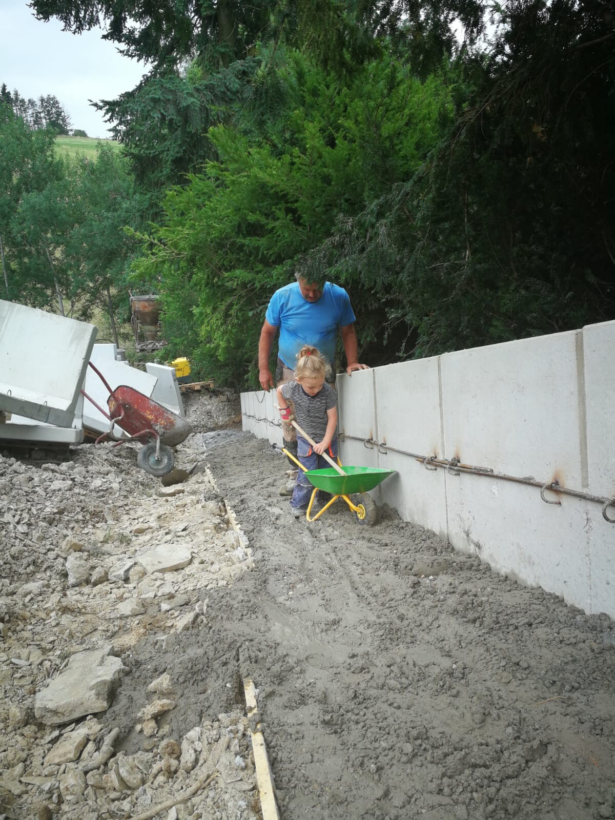

sichtbeton8217 Jul 2019 09:03Not shifted that much. They were supposed to come today, but now it will be next Monday. However, the crane company will come on Friday first to check if the windows can even be lifted over the house. If that’s not possible, we have a plan B. I really want to have the windows installed finally so that the screed can be done.

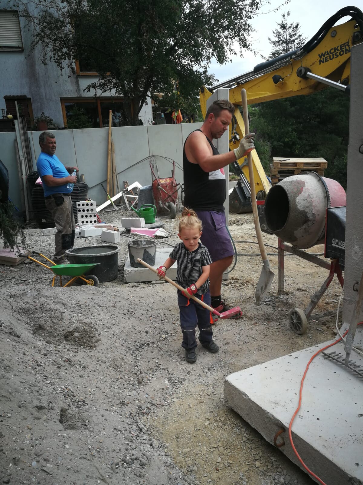

sichtbeton8219 Jul 2019 07:44Utility connections for multiple services are now also being installed in public areas. The water line is definitely frost-protected, buried 3m (10 feet) below the asphalt. This is what happens when the street level is raised afterward.
Otherwise, not much new except mixing, mixing, mixing. At least we’re getting a nice tan and enjoying the fresh air together.
sichtbeton8224 Jul 2019 23:08Hooray, the windows are installed!
... but the wrong ones. Well, everything was going too smoothly until now. A turning point had to happen eventually.
We installed three windows ourselves (as assistants) in the extreme heat, but then we realized something was off. The windows fit perfectly into the structural opening, but not with the floor construction. The sliding doors (three in the basement, two on the ground floor—middle section fixed glazing—and two on the attic floor—middle section balcony door) have a threshold that is 5cm (2 inches) above the finished floor level. However, we wanted threshold-free doors. The bottom of the window, which should be embedded in the screed, is therefore 5cm (2 inches) too high, making the clear passage height 5cm (2 inches) too low. This issue could now lead to a construction halt of 8 weeks.
