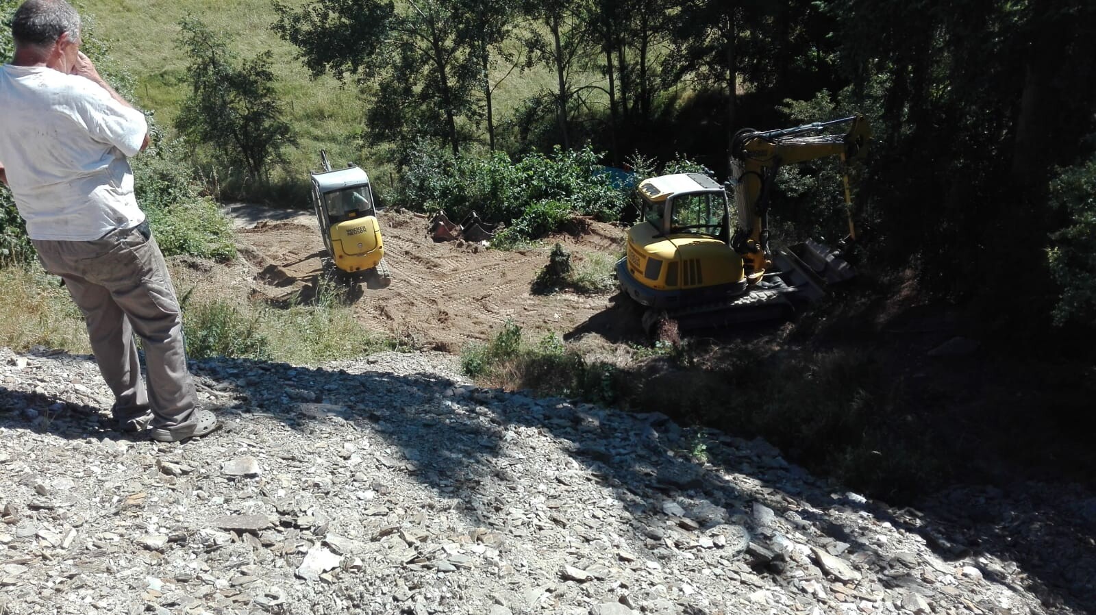

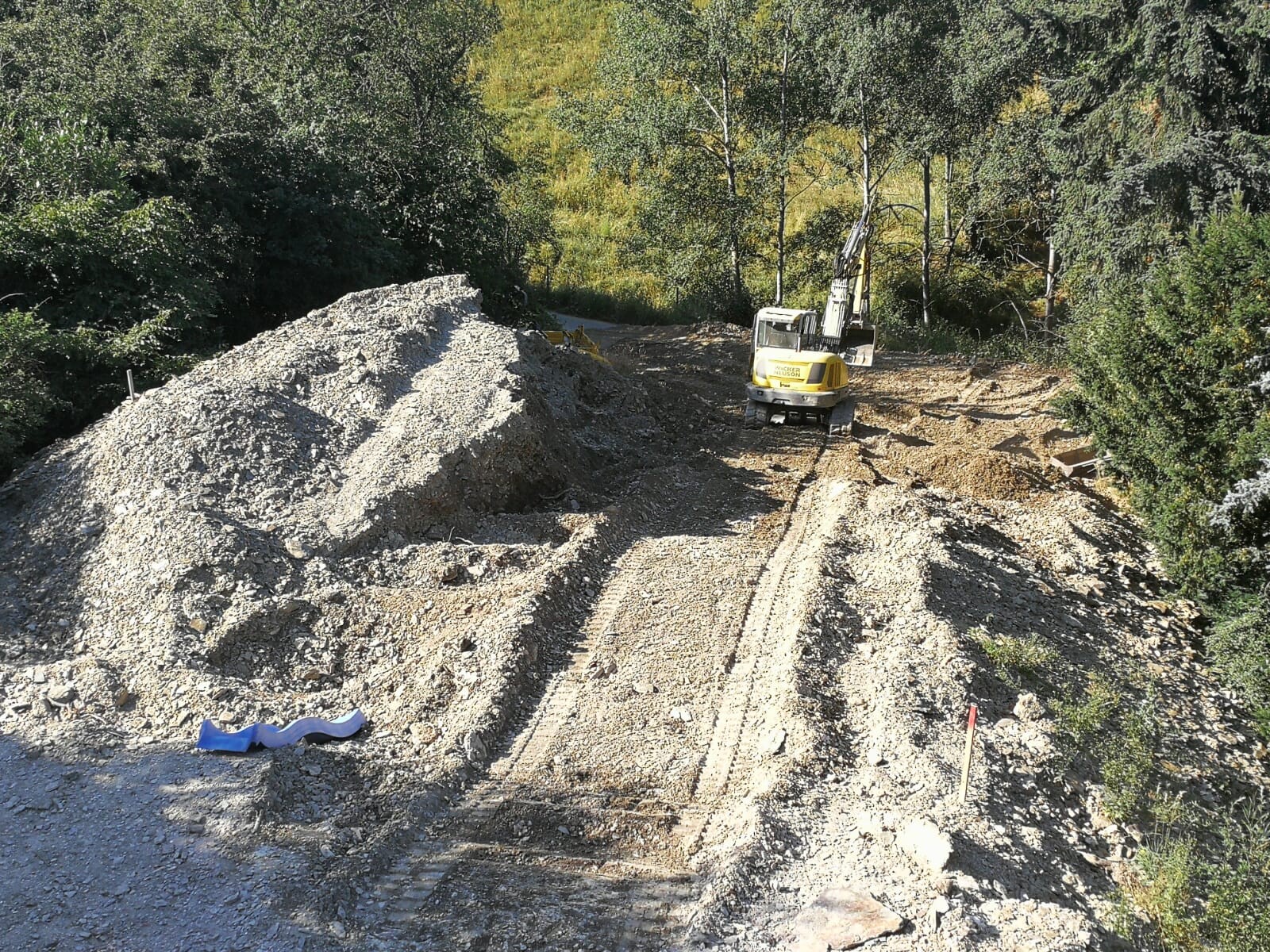

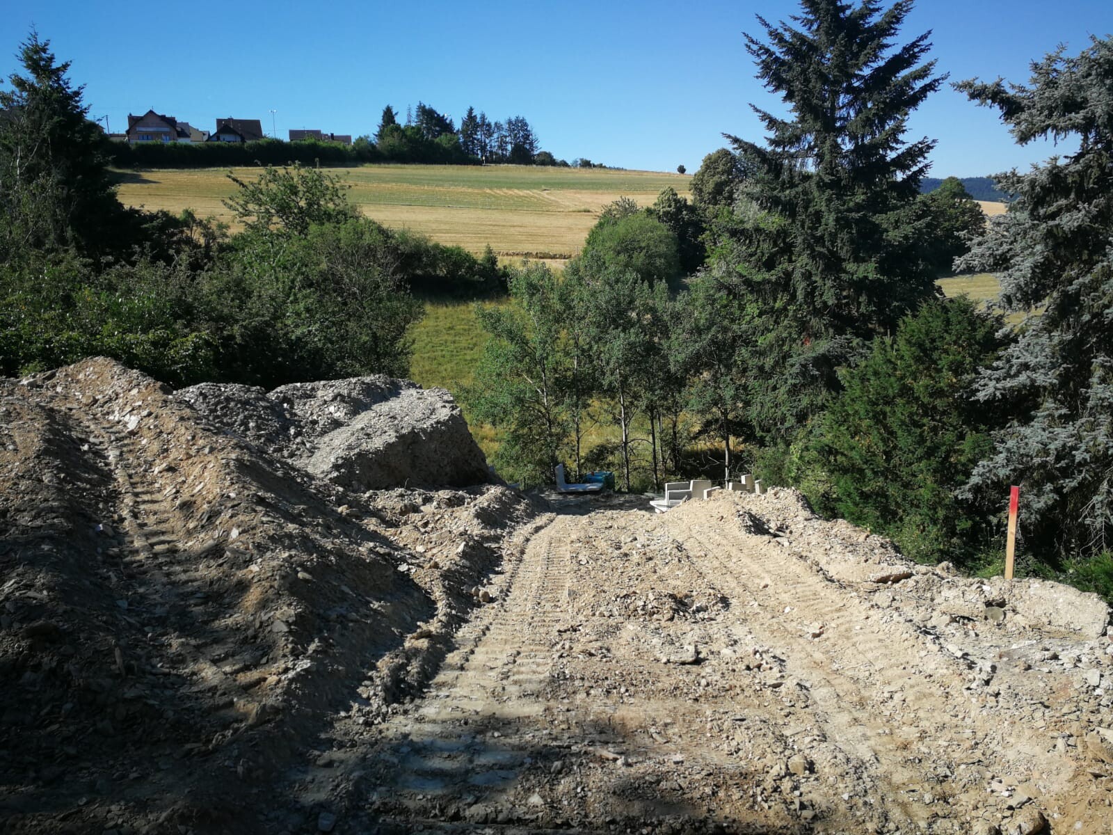

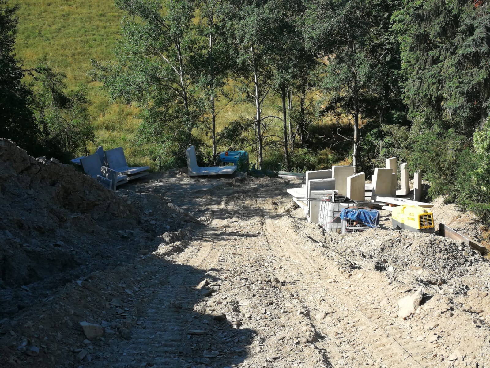

sichtbeton821 Jul 2019 11:50Many thanks for your feedback! The pool is now planned for Terrace 2. The landscape gardener has arrived and is working from the lower side (the valley side). We reached an agreement with a (non-adjacent) neighbor. We want to get rid of about 300m³ (390 cubic yards) of rubble, and he can make use of it...

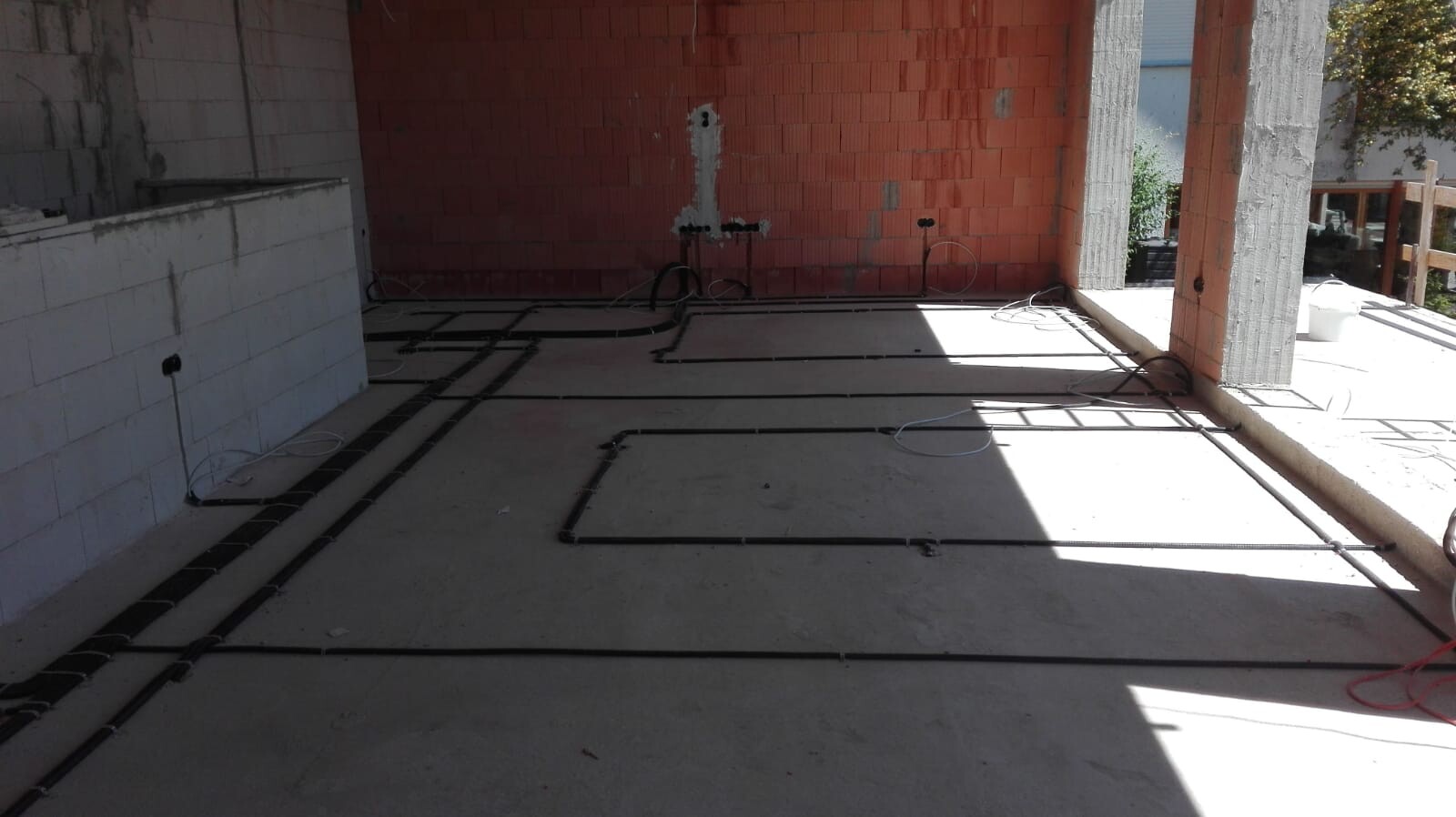

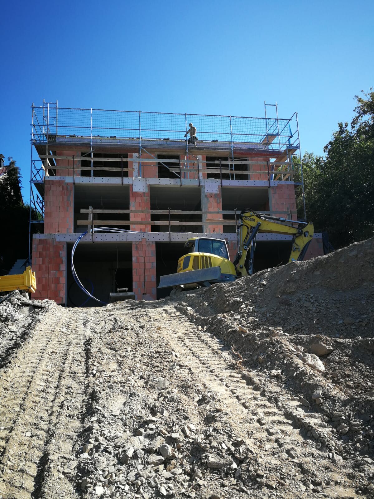

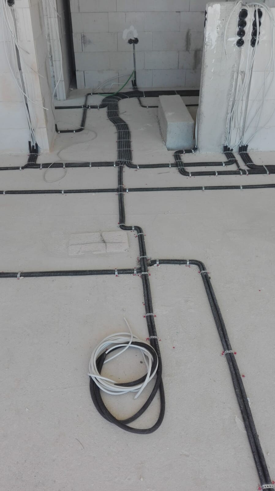

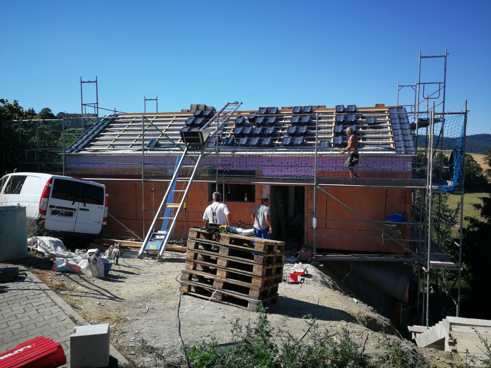

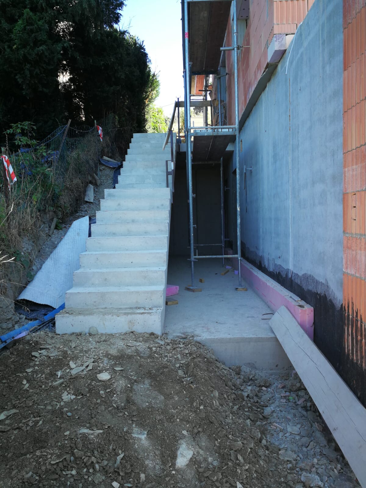

Since the last posts in mid-May, not much has happened, partly due to the holidays. The structural builder has completed the backfilling in front of the house and the exterior stairs. The roof frame is now finished, the tiles were delivered today, and the roof will be covered by the end of this week. The electrician has started work, plumbing begins tomorrow, and the small windows and doors will arrive this week. The large south-facing windows are expected in two weeks.
The shell construction has also been inspected. There were only a few items on the punch list. They have really done an excellent job!

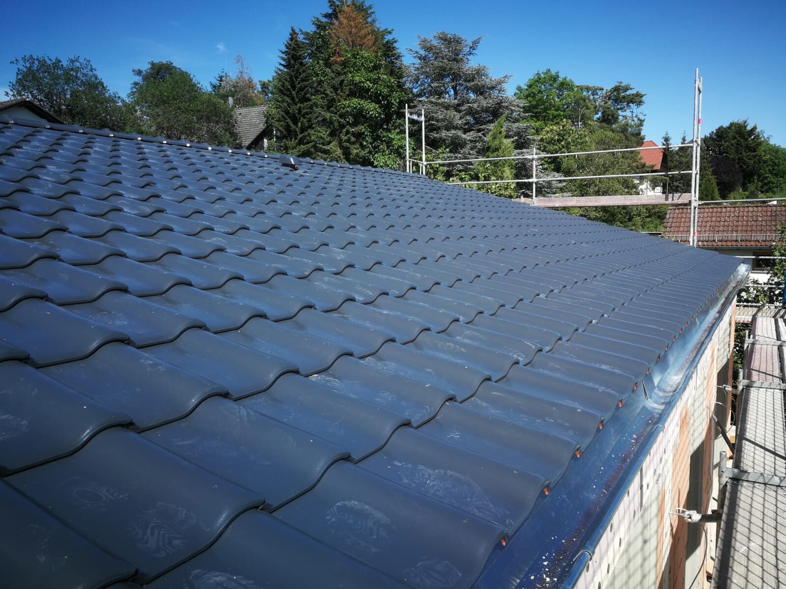

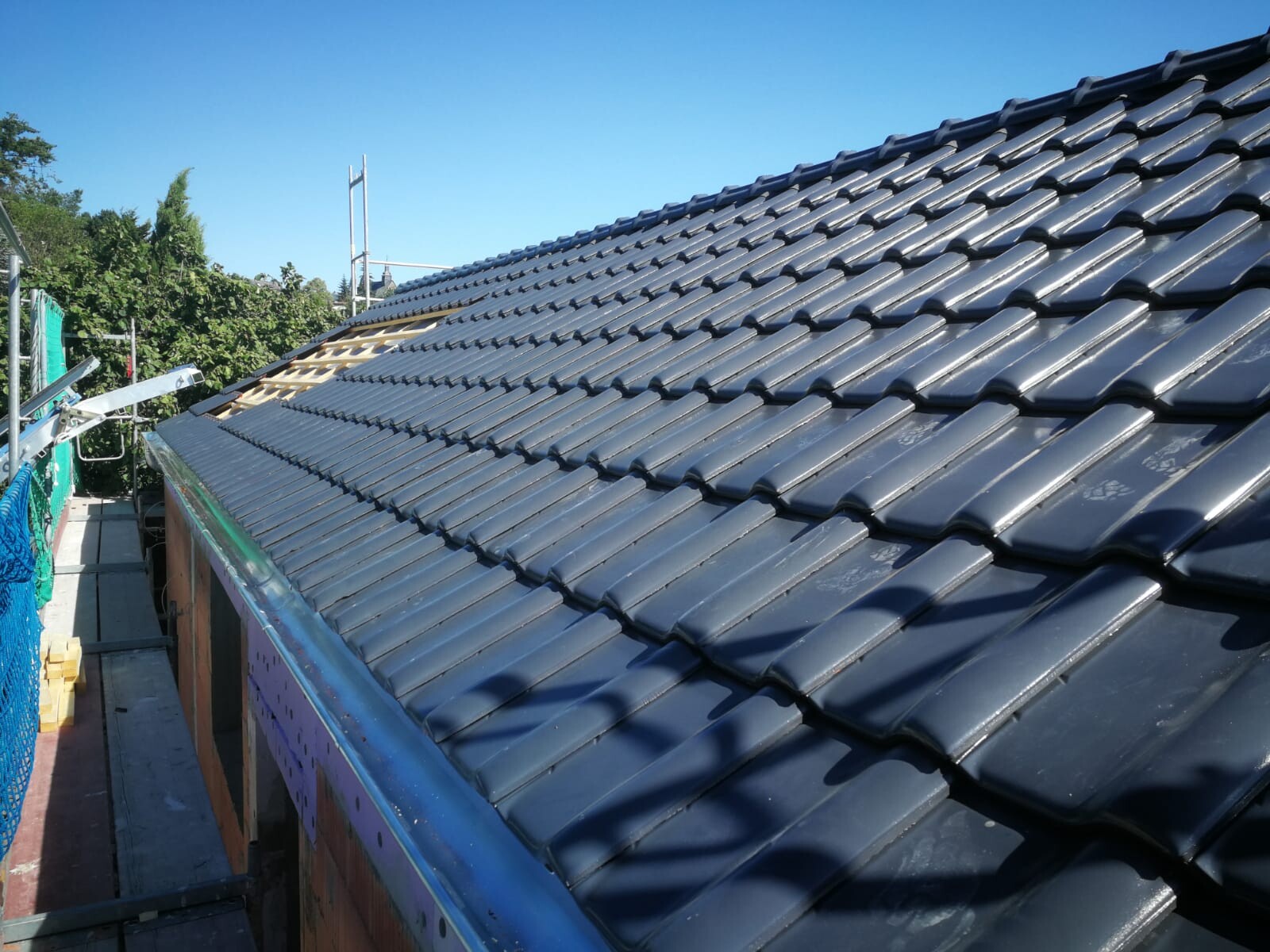

sichtbeton825 Jul 2019 06:45The roof is now mostly covered. The tiles for the snow guards were missing. These will be replaced later, and the opening will be closed. The next step will be the flat roof waterproofing (for the balconies and terrace). This is a critical task that will hopefully be closely monitored by many attentive eyes. However, part of the scaffolding must be removed first.
