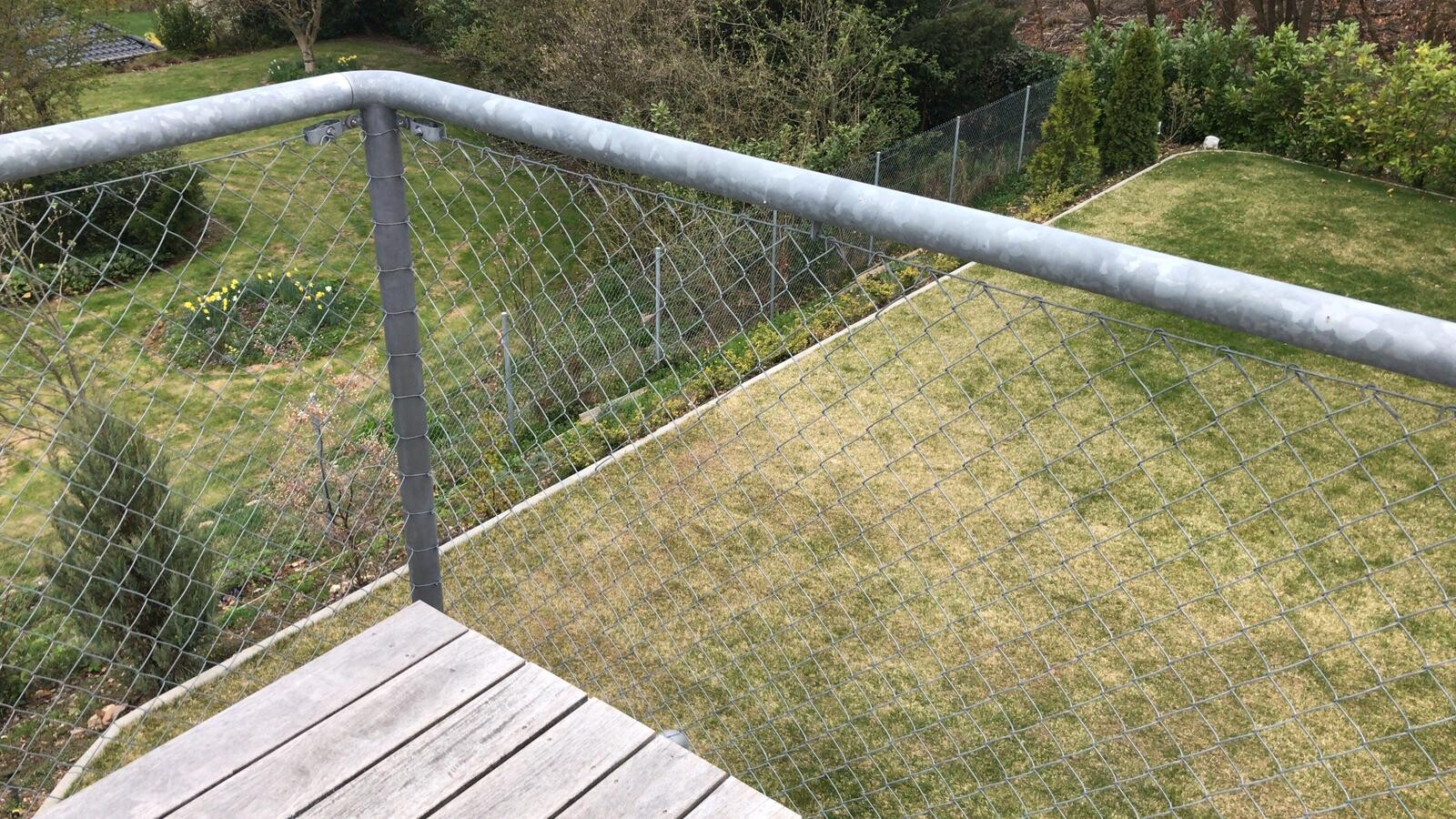

sichtbeton8214 May 2019 06:45Thank you! Like almost everything in the house (except for the dimensions), this will be more of a low-budget project. Therefore, we plan to use a balcony railing with a handrail made of round aluminum tubing about 1 meter (3 feet 3 inches) high above the finished floor level. Approximately every 1.5 meters (5 feet) the aluminum tubing will also serve as posts extending downward. Between these posts, there will be a galvanized wire mesh fence. However, the exact execution is not yet decided. The wire mesh could either be placed only between the sections using additional side fasteners, or it could be twisted into the posts. Hopefully, you were able to understand this, Mensch Meier.
sichtbeton8214 May 2019 14:38Top priority besides low costs is an open and airy feeling, including good visibility. We are basing this on a fence from friends who built their house three years ago. Although their overall project was not low-budget, the fence was this simple solution. I’ll try to remember to take a picture during my next visit.

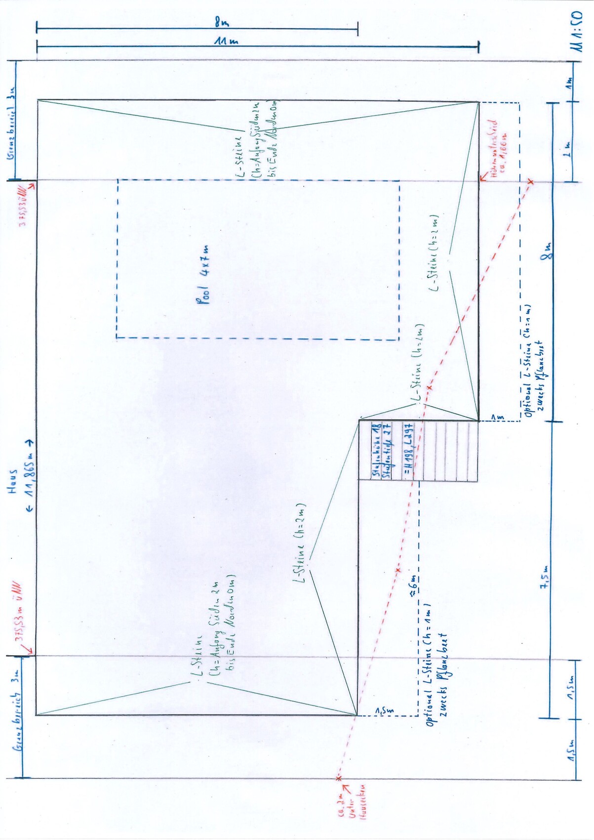

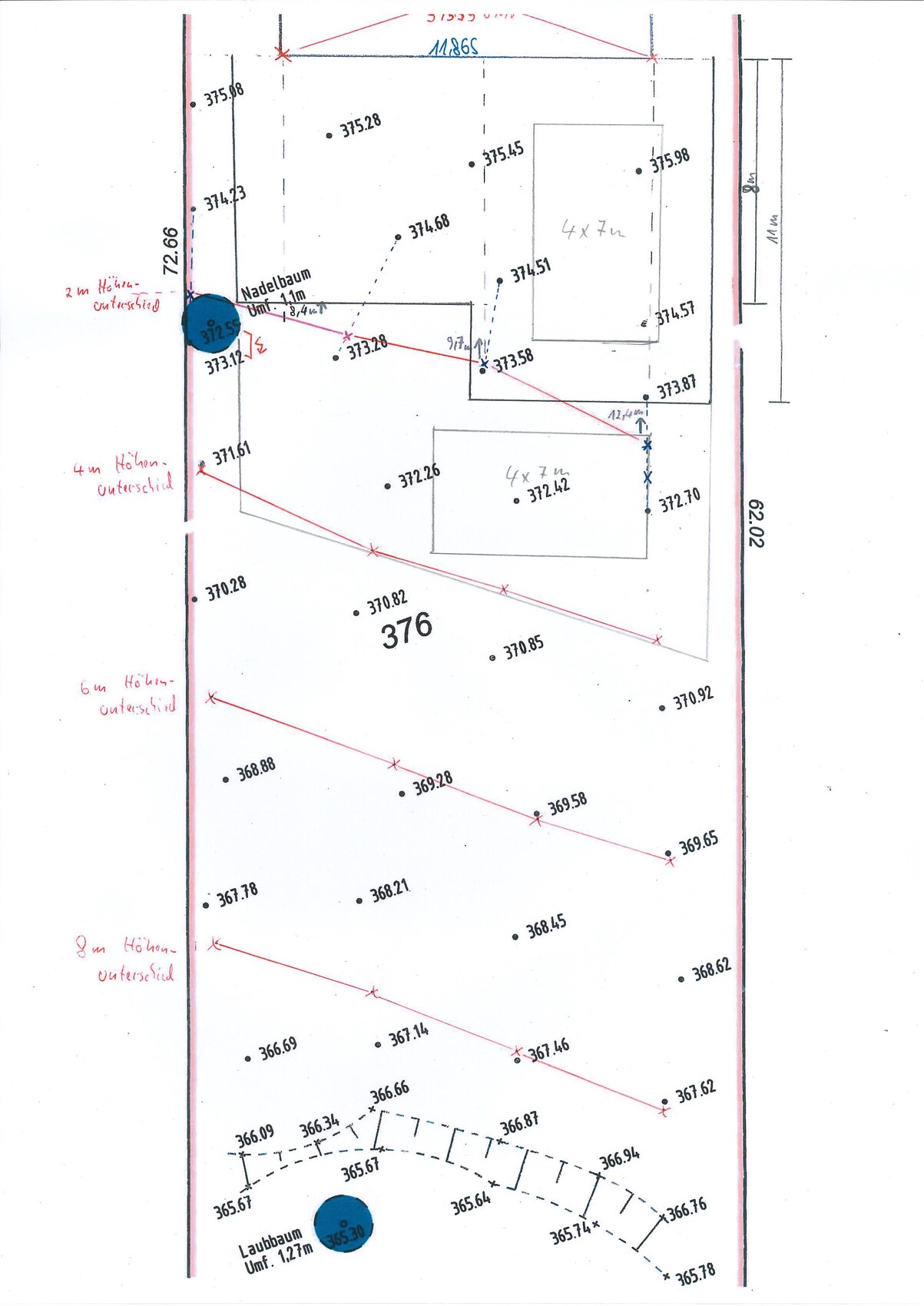

sichtbeton8217 May 2019 07:35Further thoughts on terracing. A nice challenge on a slope.
Just a quick recap so you don’t have to scroll back too much. Almost a south-facing slope, children’s rooms (ages 4, 3, and 0) in the basement (level terrace), living room/kitchen on the ground floor. For the terracing, I followed the 2-meter (6.6 feet) contour lines. As you can see, the slope is not just downward but also tilted sideways. Initially, only the first two terraces are planned. The earthworks contractor will soon install 2-meter (6.6 feet) L-shaped retaining walls.
We want the edge of the first terrace to be straight, while the second one will follow the contour line more closely.
If there’s any budget left over, we are considering a pool, roughly 4 by 7 meters (13 by 23 feet). Would you place it rather on terrace 1 (the highest) or on terrace 2? I am deliberately not listing our criteria yet.
Hello @sichtbeton82. First of all, congratulations on your beautiful project. I really enjoy following the progress.
My personal opinion regarding the pool is that I would prefer terrace 2. One reason is that, in my view, it makes the area in front of the house feel a bit more open. I think that if terraces 1 and 2 are well connected, there shouldn’t be any problem quickly running into the house if, for example, a towel is forgotten.
