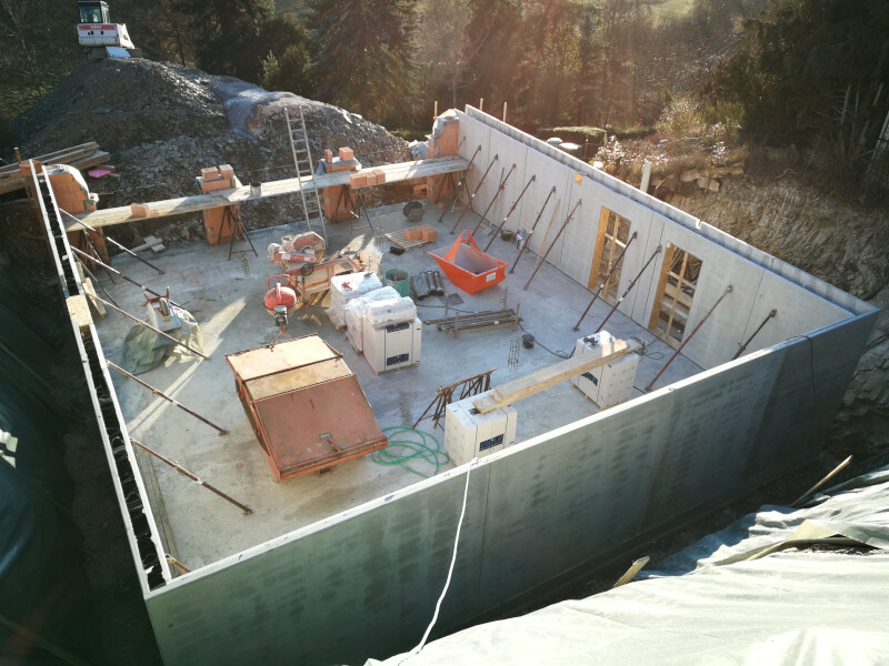

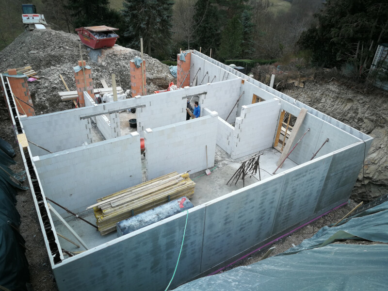

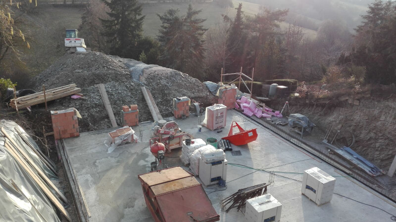

sichtbeton8220 Feb 2019 07:30I always get a bit nervous when I’m over 1 meter (3 feet) high. Climbing down a ladder takes a lot of courage from me. Even ten horses wouldn’t be able to get me into the excavator.
The concrete walls have been installed. It’s a pity that these are load-bearing walls. Otherwise, we would have left the concrete surface as is (without plaster, wallpaper, or anything else).
Will insulation be added on top?
Our concrete wall on the hillside side was insulated from the inside.
That sounds familiar. I don’t think I would have gone down into the excavation pit.
The plasterers specifically installed a mobile staircase for me, otherwise I wouldn’t have been able to ventilate during the screed drying process. I can’t reach another floor using a ladder.
sichtbeton8222 Feb 2019 06:44Insulation will be added later! First, for example, a black primer layer to adhere the insulation. For the exterior insulation, 120mm (5 inches) extruded polystyrene rigid foam boards.
