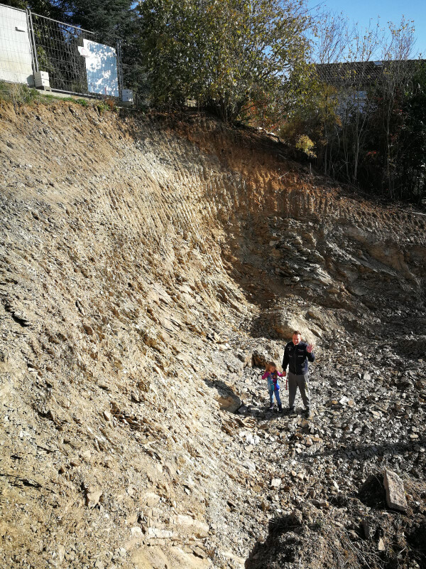

Attached is a status update from last Saturday. The small excavator and its operator are doing a great job. Considering that work is not continuous and only takes place in relatively short time windows, it’s a top performance!
About 1.1 m (3.6 ft) still need to be dug deeper. It is getting rockier now. Additionally, there is a "water source."
