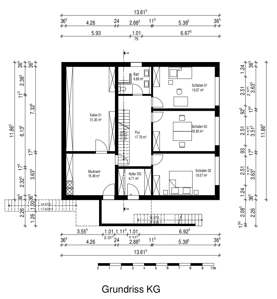

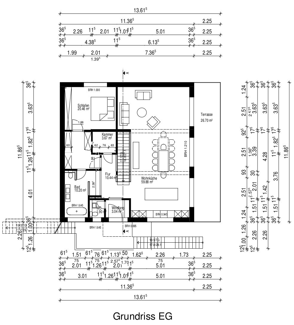

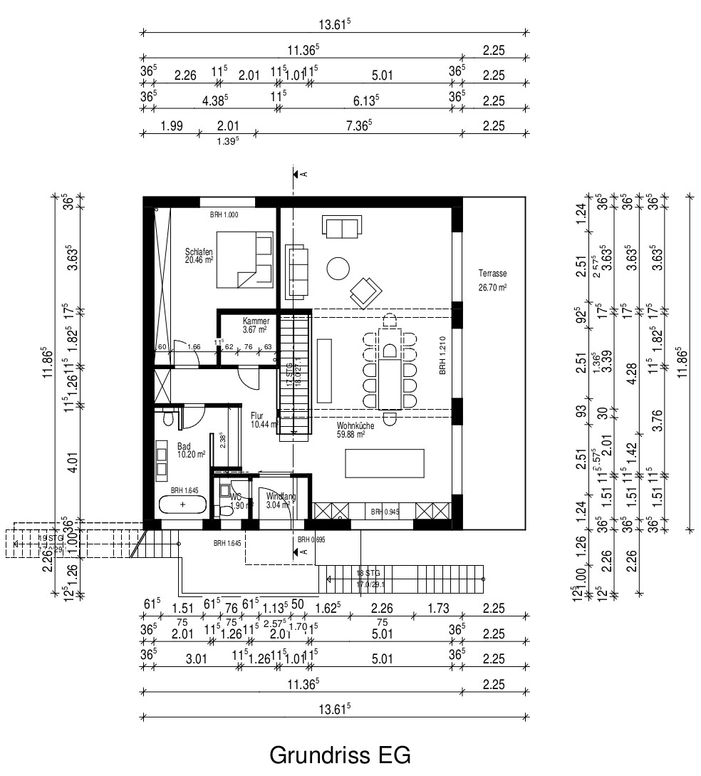

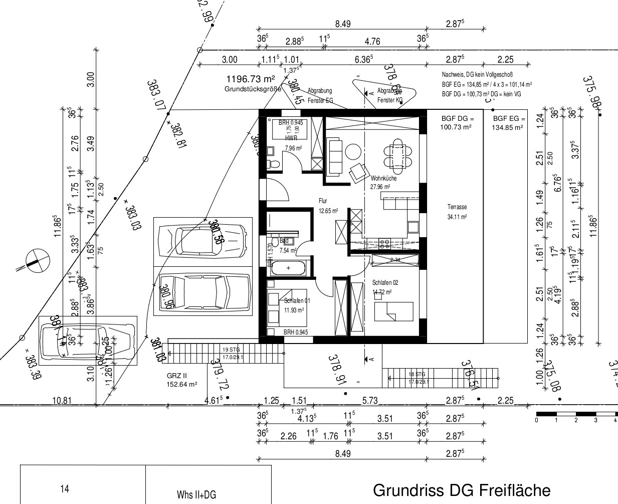

Attached are the current floor plans and elevations/section.

I still don’t understand why there is such a strong reluctance to separate the parents’ area?!
Guests will hardly use the main bathroom since there is a guest toilet, but children might still go in. The advantage would be a certain level of privacy.
I’m only thinking about the scenario where the husband is playing cards with friends at the dining table, and the wife is already in bed in the bedroom wearing her nightgown. If she needs to use the bathroom, she can only get there through the small, useless corridor, where she is basically on display.
With very minor changes, a walk-in closet could be added without any disadvantages...
Also, I would connect the shower screen to the upper wall of the plan. As it is now, the wet corner is right at the bathroom entrance, where you step out of the shower. This is an unavoidable obstacle for anyone wearing socks.
Where do you plan to have a wardrobe? With two small children (soon three), I imagine the small entrance area feels quite cramped.
sichtbeton8213 Jul 2018 12:25Thank you very much for your suggestions. We will discuss the redesign of the dressing room once again. Regarding the shower, it is clearer. I always based my measurements on the marked 2.38 m (7 ft 10 in). I thought the wall would be about 1.80 m (5 ft 11 in) long, but it is only 1.20 m (3 ft 11 in). This will very likely be corrected according to your suggestion. Thanks!

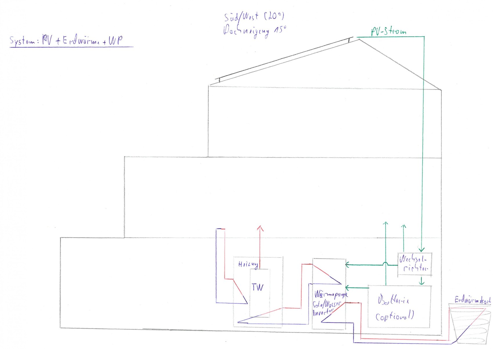

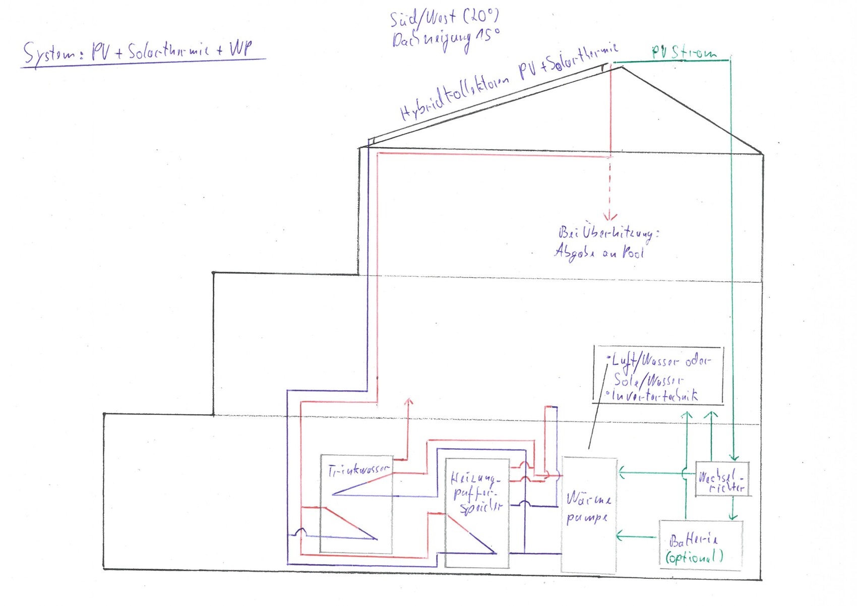

At the moment, the "energy concept" is still on my mind. Unfortunately, no data such as heating load or prices are available yet. For me, the following three options are available (but it is very difficult to decide, as there are currently many possibilities).
a) Heat pump supported/operated by both photovoltaics and solar thermal energy
b) Heat pump supported/operated by photovoltaics and geothermal energy
c) Heat pump operated solely by photovoltaics
From the perspective of incorporating as much renewable energy as possible, I find options a) and b) good. However, option c) is significantly simpler and, I fear, not less economical.
Congratulations on obtaining the building permit!
I would definitely support changing the matte finish immediately.
What really bothers me, however, is the narrowness at the entrance. You almost stumble down the stairs when you come in.
If it were my house, I would remove the straight staircase and the storage room. Part of the basement could be sacrificed for a half-turned staircase. But of course, this is a matter of personal taste—especially since the storage room would then be missing, whatever it was intended for.
I find the vestibule too small, and the cloakroom correspondingly so. The skylight above the shower is a great idea, but a functional cloakroom would probably be more important to me in that location.
