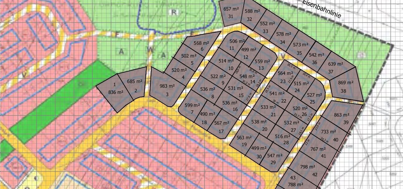

We want to build in a newly developed neighborhood that is not yet fully serviced. We have not yet chosen a plot (currently not for sale).
So I’m looking for advice both on the floor plan and choosing a suitable plot. Any of the shown plots are possible except those in the area with the city villas (for some I have entered approximate size and lengths). I initially selected a plot where the garden faces roughly west to catch the evening sun. The current floor plan would also fit the other green-marked plots.
I would seek input even without owning a plot of land. Just visit the nearest model home village. Look at the houses. It gives you a sense of room sizes and provides initial talking points: what you like and what you don’t. Some salespeople or advisors take the time to give you input, for example, by customizing a model home to your needs. Not everyone does this. Some just deliver a 15-minute monologue about how great they are and how bad their competitors are.
It’s better to avoid a corner lot because you’ll have to clear a lot of pathways in winter.
I would choose a lot directly opposite yours: access from the northwest, garden in the southeast, terrace then wrapping around from southeast to southwest. So one of the three with a length of 30 meters (98 feet).
If the sun is still out in the evening, you can comfortably sit on the side of the house on the west side or enjoy the evening sun in the courtyard, possibly even have a party under the carport 😉
Nanny Ogg21 Dec 2017 16:36@11ant:
All lots are still available since they are not currently on the market. Only the white lots on the right have been sold and are being/will be developed with single-family homes.
I have renumbered all the potential lots and added approximate sizes. Please note that all size measurements are rough estimates, as I measured them from a low-resolution draft. You can also still see the blue building zones faintly.
Nanny Ogg schrieb:
I have renumbered all potential plots So, if all of them are equally suitable (not some rows having only semi-detached houses or only flat roofs, for example), then my favorites are numbers 6, 11 to 13, and 23 to 25. If you place a lot of importance on Yvonne’s argument about snow removal responsibility, then specifically 12 and 24—but these would have more neighbors sharing fence lines for the areas with less sweeping.
It’s better not to choose a corner lot because you have to clear a lot more pathways in winter.That was always my thought as well as my wife’s. Certainly a valid point, but it doesn’t necessarily mean there has to be a sidewalk everywhere, so that somewhat balances out.
An advantage of a corner lot, depending on its orientation, can be related to setback requirements, since you often share public space up to the middle of the street. This means you may have a bit more flexibility or more usable land, especially if the plot is rather small.
Regarding whether to consult an architect with or without a plot: we didn’t do it, but I can only recommend doing so. Sometimes (often) a plot that looks challenging to a layperson offers more design freedom and more interesting possibilities than a plot that seems perfect to non-experts.
The only potential difficulty is finding an architect during the current building boom who is willing to work proactively without a specific plot yet...
ruppsn schrieb:
Regarding hiring an architect with or without owning the land: we didn’t do it, but I can definitely recommend it. Sometimes (often) a plot of land that looks complicated to a layperson offers more design flexibility and more interesting possibilities than a plot that seems perfect to a layperson. Does that mean you let a princess slip away because, in laypeople’s eyes, she looked like Cinderella?
