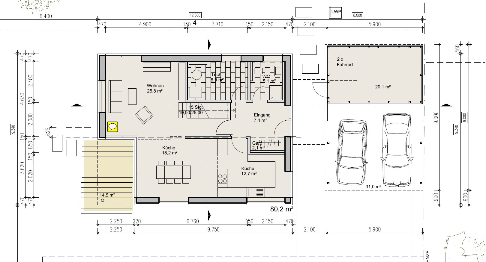

We have made significant progress with our planning and would like to share our new floor plan. On the lower floor, we no longer have an extra room, and the staircase has been repositioned. The kitchen shown in the floor plan is just a placeholder. If anyone has good ideas for this space, please feel free to share.

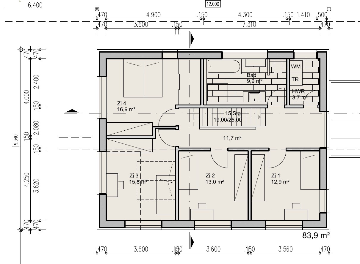

On the upper floor, we don’t like that you enter directly facing the toilet in the bathroom; otherwise, we are basically quite satisfied with the layout. Have we overlooked anything important?
Do you already have children? I would rotate the staircase. I don’t find an open living area very practical for a family with small children or even teenagers. Also, the staircase needs to work well the other way around, ideally without having to pass through a mudroom area when going upstairs. aumen:
I also don’t like the layout of the bathroom on the upper floor. You are standing with your back to the light at the washbasin... not very practical. Is the window fixed?
