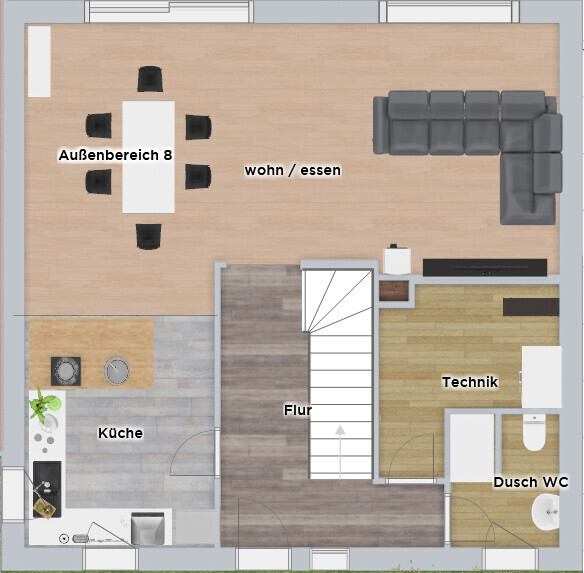

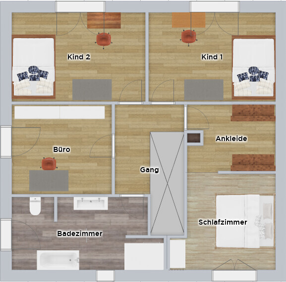

Hello House Building Forum,
What do you think about the floor plan (see attachment)? This is a first draft, and I am open to any feedback!
Thank you in advance!

- The maximum width of the house of 10.2 m (33 ft) is based on the plot width of 16.5 m (54 ft). 6.3 m (20 ft) is allocated for the double garage. The house depth is therefore 10 m (33 ft) (hipped roof: square floor plan is advantageous + if deeper than 10 m, the floor space index would be exceeded + hardly any garden space would remain)
- The office on the ground floor could be used as a third children’s room if needed (not currently planned) and later as a care room
- Bedroom is not adjacent to the children’s rooms
- Both children’s rooms have access to the roof terrace on the garage
- Direct access from the garage to the house
- Open living and dining area
- Large children’s rooms (approx. 17 sqm (183 sq ft))
- Is the straight staircase suitable for a 10 x 10 m layout, or are there better options?
- Is the space sufficient for 4 people, or would you recommend a basement?
- Open to all comments
BauFamily schrieb:
What exactly is wrong with the proposed floor plan here featuring the straight staircase? I don’t see anything wrong with it. However, especially for a terraced house, it might be worth putting more thought into the design rather than just drawing inspiration from an urban villa.
For example, the entrance could be placed at the corner near the garage, recessed and covered. And yes: I would rather opt for a double half-turn staircase, not because the house is only 10 x 10 meters (33 x 33 feet), but so that both children’s bedrooms face the garden, the master bedroom faces east, and a storage room doesn’t take up valuable window space.
I don’t see anything wrong with that. But especially for a terraced house, it might be worth putting more thought into the design rather than just taking inspiration from a detached urban villa.
For example, you could position the entrance at the corner of the garage, recessed with a canopy, and yes: I would also lean toward a double half-turn staircase, not because the house is only 10 x 10 meters (33 x 33 feet), but so that the children’s rooms both face the garden, the bedroom faces east, and a storage room doesn’t waste valuable window space. Good idea to have the entrance at the garage corner; definitely worth a closer look.

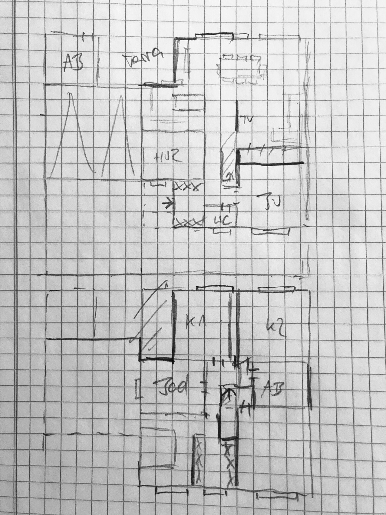

So far, I haven’t been able to come up with anything better than the draft from the first post. Crixton schrieb:
Who created the design: Do-it-Yourself, but using some floor plans as a template Do you notice anything?
You browse the internet and find that among 10 x 10 floor plans there are only simple city villas... Planning a house isn’t really your strong suit.
The area actually offers you a lot. A straight wall between the garage and the house is always flat. With a double garage, a storage room of 3 x 3 meters (10 x 10 feet) is also possible. You can extend the gained 3 meters (10 feet) on the ground floor and design it as a protected terrace with corner windows, for example.
However, I must admit that when sketching, I was thinking more of a Bauhaus style 😉
BauFamily schrieb:
Why specifically 12? [...] It seems that the corridor is 2.50 meters (8 feet 2 inches) wide, which is more than sufficient. There are practical guidelines regarding at which dimensions one can consider the staircase design in addition to the space requirements, without compromising the overall result. I did not criticize the corridor for being too narrow.
Do you notice something?
When you browse the web for 10 x 10 floor plans, you mostly find simple city villas... Planning a house is clearly not your strong suit.
The space actually offers you quite a lot. A straight wall between the garage and the house always stays level. With a double garage, a storage room of 3 x 3 meters (10 x 10 feet) is also possible. You can continue the extra 3 meters (10 feet) on the ground floor as a covered terrace with corner windows, for example.
However, I must admit that when sketching, I was thinking more of a Bauhaus style 😉 Thanks, your suggestion really appeals to me at first glance!
