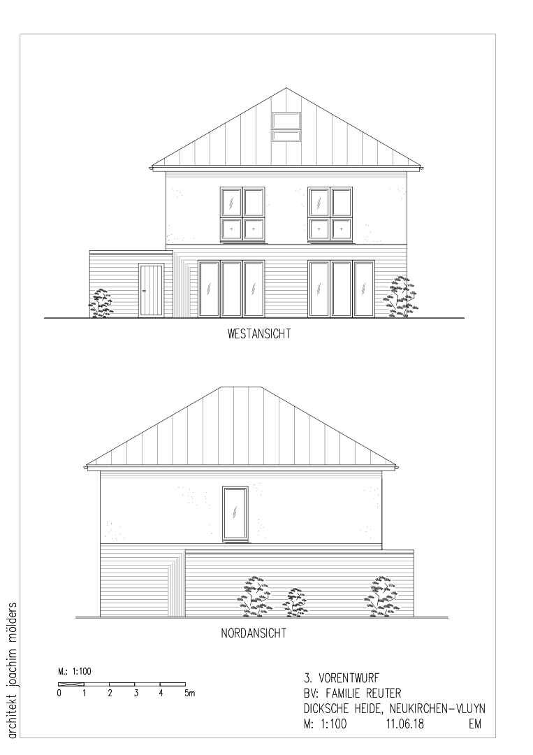

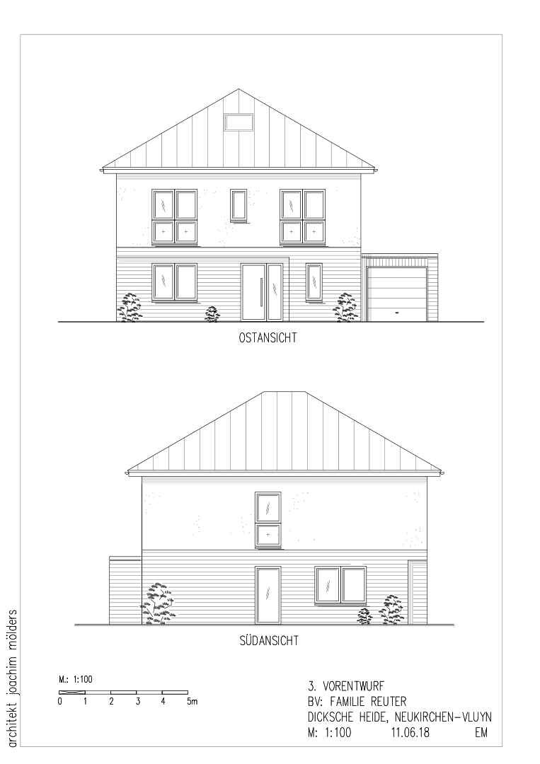

Here are the JPEGs
East and south view of a two-story house with garage and windows
Architectural drawing: two-story house with gable roof, west and north view.

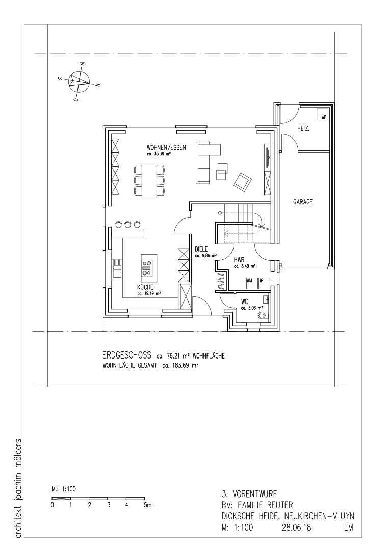

Ground floor plan: living/dining area, kitchen, hallway, utility room, WC, garage; scale 1:100

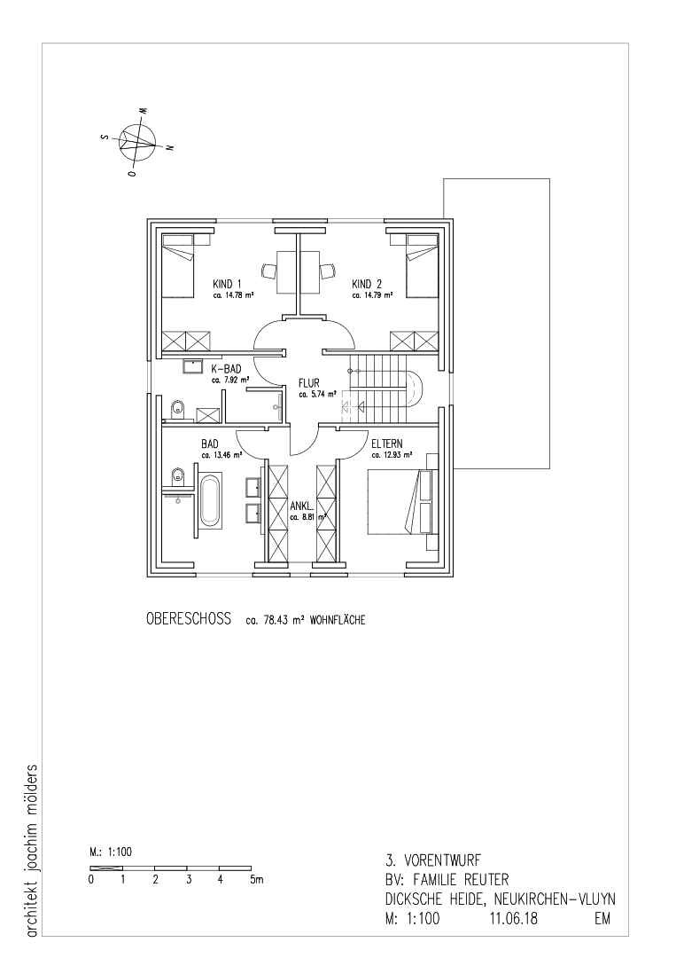

Upper floor plan: corridor, child’s bedroom 1, child’s bedroom 2, master bedroom, bathroom, dressing room.

Basically solid. A 20m² (215 sq ft) kitchen—but it should be used for frequent and extensive cooking.
The hallway feels too long and narrow for my taste—simply not inviting, especially since it ends with a wall.
The living room seems small compared to the kitchen. Access through the dining area, with the sofa acting as a room divider, immediately makes me uncomfortable.
In the bathroom, the distance between the sink and the bathtub feels too tight. The space between the cabinets in the dressing room is also annoyingly narrow. If it were mine, I would remove the T-shaped element in the bathroom and reduce the bathroom width by at least 20cm (8 inches) to gain space for the dressing room.

Hmm... since the heating system needs to be within the building’s thermal envelope, I'm a bit surprised by the location of the boiler room. Not only does this mean the garage must also be included within the thermal envelope, but the boiler room is placed in the farthest corner of the building, resulting in long pipe runs.
For us, it wouldn’t be possible at all to pour a slab over the pipes leading to the property.
Regarding the floor plan: I would place more windows, or the patio doors, on the south side of the house.
In winter, otherwise, the ground floor becomes too dark because the sun doesn’t reach the west side.
Conversely, I wouldn’t place full-height windows facing the street... see the recent weekend thread about full-height windows...
kaho674 schrieb:
If it were mine, I would remove the T-shaped wall in the bathroom, and make the bathroom at least 20cm narrower in favor of the walk-in closet.
I always argue that you need space to step back in the walk-in closet in order to view all your clothes across its width. Also, you’re not always alone in the closet... if it’s too narrow, it becomes a storage hazard.

kaho674 schrieb:
The living room feels cramped compared to the kitchen. Access through the dining area plus the sofa acting as a room divider immediately makes me uncomfortable.
I guess it depends on what you want to do in the living room.... we only watch TV there and otherwise sit at the dining table.... so our living room is small....
Placing the sofa in the middle of the room is quite common, as is putting it in front of floor-to-ceiling windows these days. I don’t like that either, but how else could it work? Where else would you squeeze the TV?
