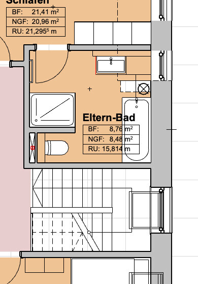

Myrna_Loy3 Jan 2022 22:06In my experience, having a bathtub (with shower) in the children’s bathroom is more practical than having only a shower there and a bathtub only in the parents’ bathroom. My boys still prefer baths over showers. Older children can easily step into the bathtub to shower. The boys use the bathtub almost daily. As parents, we shower every day, and I personally use the bathtub 2–3 times a month during winter or when I have back pain.
We also have two “family bathrooms.” One with a shower, and one with a bathtub and shower. And why should the parents have the spa while the children only have a wet room?
house4family3 Jan 2022 22:10Myrna_Loy schrieb:
only one bathtub in the master bathroom- Shower in the master bathroom: The shower is there, but it was unfortunately covered by the room label, so I missed it.Thanks for the note.
Myrna_Loy3 Jan 2022 22:16This is really tight.
How tight exactly is hard to say, but what about the clearance between the shower and washbasin? The distance between the washbasin and bathtub?
house4family3 Jan 2022 22:19Myrna_Loy schrieb:
That is really tight.
How tight exactly, of course, can only be estimated, but what about the distance between shower and washbasin? And the distance from washbasin to bathtub? About 75 - 80cm (30 - 31.5 inches), which isn’t much at all. I will take another look at that. Thanks.
Myrna_Loy3 Jan 2022 22:25The window also seems too small for me. I would rather plan in the categories of full bathroom with a bathtub and a shower bathroom instead of labeling them as parents' and children's bathrooms. After all, you wouldn't cover the children's bathroom with playful designs and then expect the children to do the cleaning to the point that adults would not want to bathe there.
house4family3 Jan 2022 22:32Myrna_Loy schrieb:
The window seems too small to me as well. I would rather plan in the categories of full bathrooms and shower rooms, instead of labeling them as parents’ and children’s bathrooms. After all, you wouldn’t want to decorate the children’s bathroom with playful motifs and leave the cleaning to the kids, so that adults don’t want to use it for bathing. Well, I actually find that independence in children, especially regarding taking responsibility for cleaning, quite desirable. I would like to keep that somewhat separate since puberty will eventually come, and the house will also be more heavily used for a while then ;-)
