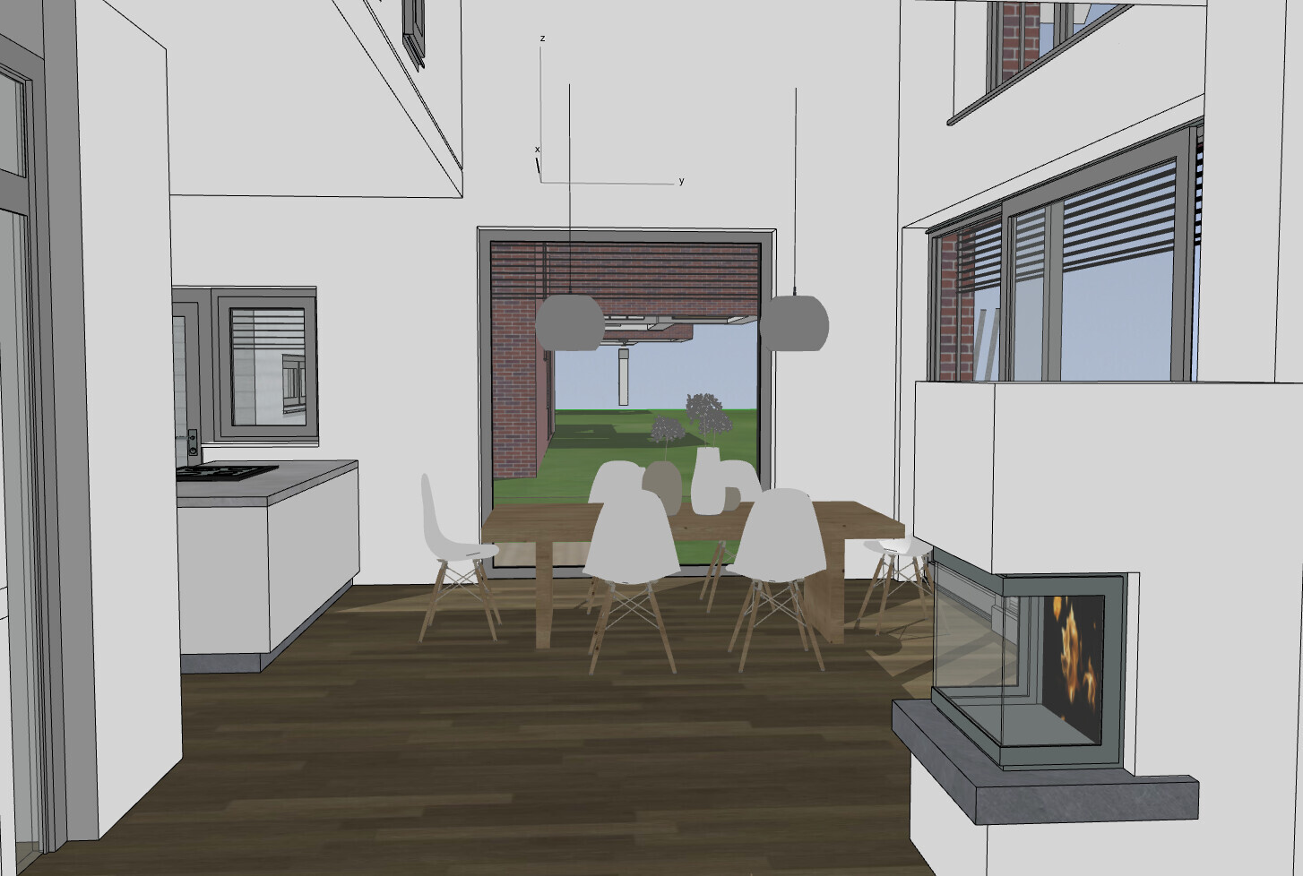

Creating an open space for a dining area by giving up a southwest-facing room on the upper floor really wouldn’t even cross my mind.
Myrna_Loy
3 Jan 2022 12:49
Placing the children's bedrooms facing northeast towards the street while giving yourself the master bedroom is quite a statement 😀
house4family
3 Jan 2022 13:22
Myrna_Loy schrieb:
Creating a double-height space for a dining area by giving up a southwest-facing room on the upper floor would never even occur to me.
- Indeed, it wasn’t an easy decision for us either, but the interior space makes up for it a bit.
Modern dining area with wooden table and white chairs, fireplace on the right, view towards the garden.
From our perspective, the double-height space made sense only above the dining area facing southwest, where there is (at least for now) open fields. Above the living area, it would feel too tall for us — on the long side, however, we would be offering the neighbors quite interesting views ;-)
- Children’s rooms: The main living area is on the ground floor, so although we don’t think the children’s rooms in the northeast are ideally located, it’s basically acceptable. Plus, both have good natural light and are almost equally sized.
Thanks for your comment.
What would be your idea for the layout?
