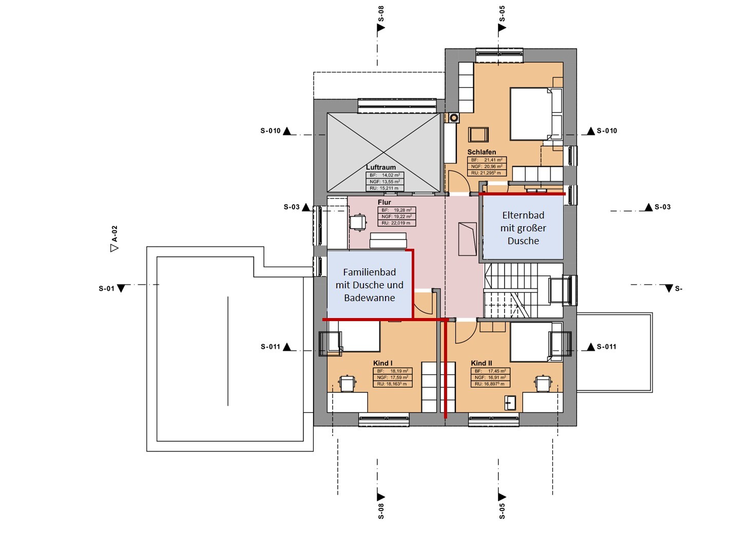

house4family3 Jan 2022 00:26Unfortunately, I was no longer able to edit my previous post, so here it is again, including the floor plans and with better image quality.

The floor plans lack dimensions. Looking up into the open space above the piano hallway reminds me of the view from the production hall to the supervisor’s office ;-)
Apart from the image format, which you first need to download, I have to say that I really like the floor plan for the ground floor.
I could definitely use this as inspiration for our own. It offers almost everything I want for the ground floor except a space for a buffet in the dining area.

Regarding the upper floor, two things stand out to me:
- Why have an open void when that space could be used for an additional room?
- No shower in the master bathroom? That would mean always having to use the kids’ bathroom for showering, which seems a bit impractical.

On the upper floor, what stands out to me are especially the many "botched corners" (for an explanation of this term, feel free to ask @11ant), which on paper increase the square meters in the rooms but are hardly usable in reality (for example, in the children's rooms). I would prefer a clearer layout on the upper floor.
P.S.: I don’t understand the windows from the piano room to the void space. Why windows? They probably don’t provide sufficient sound insulation. And why are they different sizes? If there has to be a void space, I’d rather have it open or possibly fully glazed, or just make it another nice room instead...
