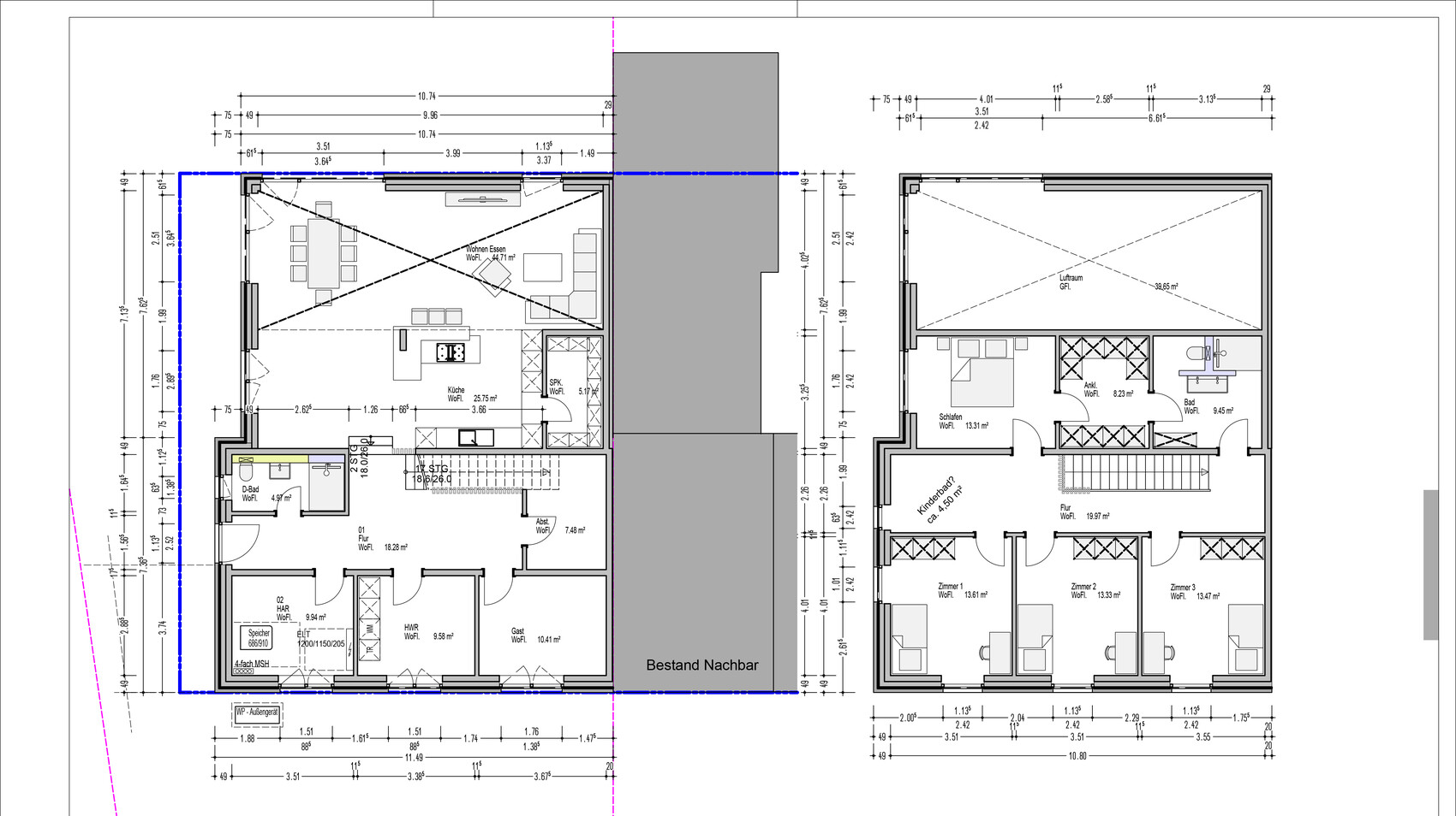

Is the attached picture sufficient? No, I actually meant a drawn site plan, like a sketch showing the building boundaries and the property with dimensions. Black lines on white paper.
I also read something about the garden facing southwest. But on the aerial photo, it looks more like northwest, doesn’t it?
I’m having trouble with the interior views. They confuse me as well. It’s fine to experiment, but you should also take a neutral look at whether it actually looks good or is practical.

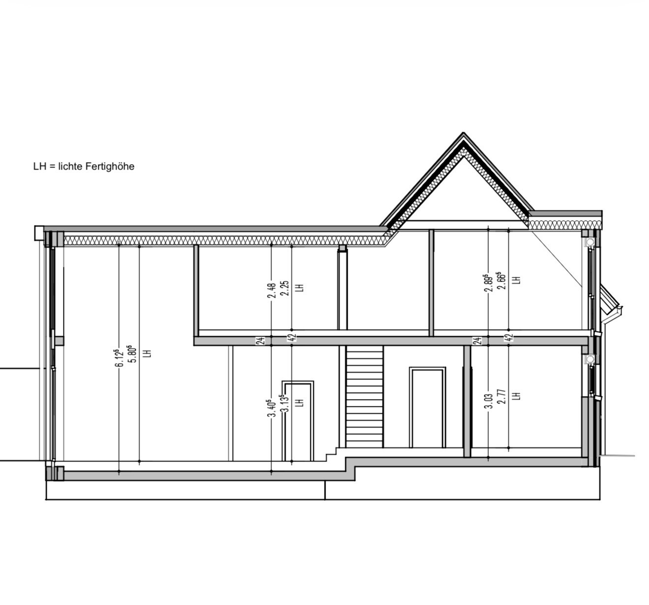

I see a shelf over 6 meters (20 feet) high. I know walls where shelves are 3 or 4 meters (10 to 13 feet) high, so ceiling-high. But there, you usually have a nice visual axis from the entrance of the open plan space, for example.
I doubt whether you want to implement that at 6 meters (20 feet), because you can’t really reach that height anymore to decorate or arrange furniture.
Then I see a couch right by the kitchen counter. Is that what you want? Is that what you’re spending money on? Just to have a gallery?
There are three kids’ rooms marked, and they are now in a fairly good orientation (I originally thought they would be more on the darker north side). I don’t consider them too small, but I get the impression that two different houses are being planned here. The neglected main house with unloved utility rooms and the three kids’ rooms—check and done—then a separate house (or extension), with a very high interior ceiling intended for a couple who wants a special ceiling height and to build their bedroom “nest” on a gallery or mezzanine. Have the children been born yet???
lucaskilam schrieb:
Ceiling height in the living area: approx. 6 m Is that fixed or still open to discussion? From your original post and another forum, I understood that you were rather questioning it. And yes, some here have special and expensive houses, including views, mezzanines, galleries, or open spaces—but 6 meters (20 feet) is often viewed critically due to lack of coziness, sound transmission, etc. Those who have such open spaces and build them again have all been empty nesters (as far as I remember). You can go for more generous ceiling heights and other designs without children. With children, it might be a no-go if there’s no spatial separation. Also, you should consider whether the kids are old enough to handle galleries and the risk of open falls, or if those areas would become off-limits for them in their own home.
Personally, I wouldn’t go higher than 3 meters (10 feet) with a flat ceiling.
Instead of the open space, I could imagine designing the upper part of the ground floor (currently the open space) as a kind of taller sunroom, clearly separated as an extension and playing with the ceiling height. Separated from the upper floor. That way, you wouldn’t have problems with single-story zoning.

lucaskilam12 Nov 2025 15:33I placed the furniture myself to get a better sense of the space, so that is not relevant here. My main concern is the floor plan, especially the planned ceiling height of 6 meters (20 feet). This height is not yet final. Initially, it was our wish, almost a dream. However, we have come to realize that it may cause more problems than benefits. It is precisely because of these uncertainties that I found this forum, and I appreciate your helpful contributions—they are very valuable to us. We are taking notes on everything you share and will carefully organize and consider all advice. One thing is already decided: the entrance will be relocated to where the utility room currently is. It is unlikely that there will be a continuous ceiling height of 6 meters (20 feet) over the entire 4 × 11 meters (13 × 36 feet) area. Unfortunately. By the way, we also really like the idea of a conservatory or sunroom.
I can fully agree with what @ypg just said, and you can trust me that I completely understand that you want to build something special for yourself. However, I would advise you to let go of certain things, such as the gallery, the very high ceilings, the T-shaped bathroom, and all these fixed elements.
A carefully chosen architect should have the task of developing the design based on your needs. Maybe it will include a gallery or even a T-shaped bathroom and other features, but assuming these things as fixed from the start might cause unnecessary constraints elsewhere.
We often see here in the forum the insistence on a straight staircase. I used to like that as well, but in the end, it repeatedly messed up our floor plan. Now the staircase is designed according to what fit well, and we think it turned out especially stylish.
I find computer modeling with pictures risky; rather, visit show homes to get realistic impressions of sizes, spatial feeling, and so on.
As @ypg already said, we have successfully sent our children away long ago and once lived abroad in a house with very high ceilings and lots of glass, where we enjoyed living. So, within our possibilities, we dared to do the same here. With children, it would certainly have been different because you’d have to allocate at least three times 6.5 sq meters (70 sq ft) for them, which we two can freely use. Of course, this depends on the children’s ages (risk of falling), but that tends to settle quickly, as we saw during a recent visit.
I believe your spatial concept is not yet really fixed; once it becomes clearer, it will also become apparent whether a gallery makes sense or perhaps a staggered living level (which I had in the old house and found very elegant), or something else.

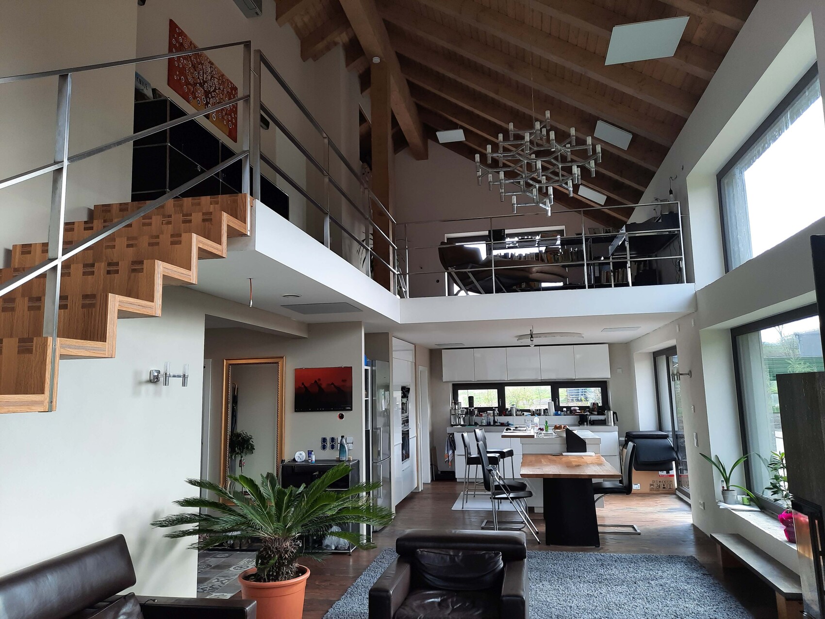

I’ll share an older picture of our open gallery. A pure “corridor gallery” without a real living area wouldn’t appeal to me, and maybe it’s just not the right time or place for that with children.
