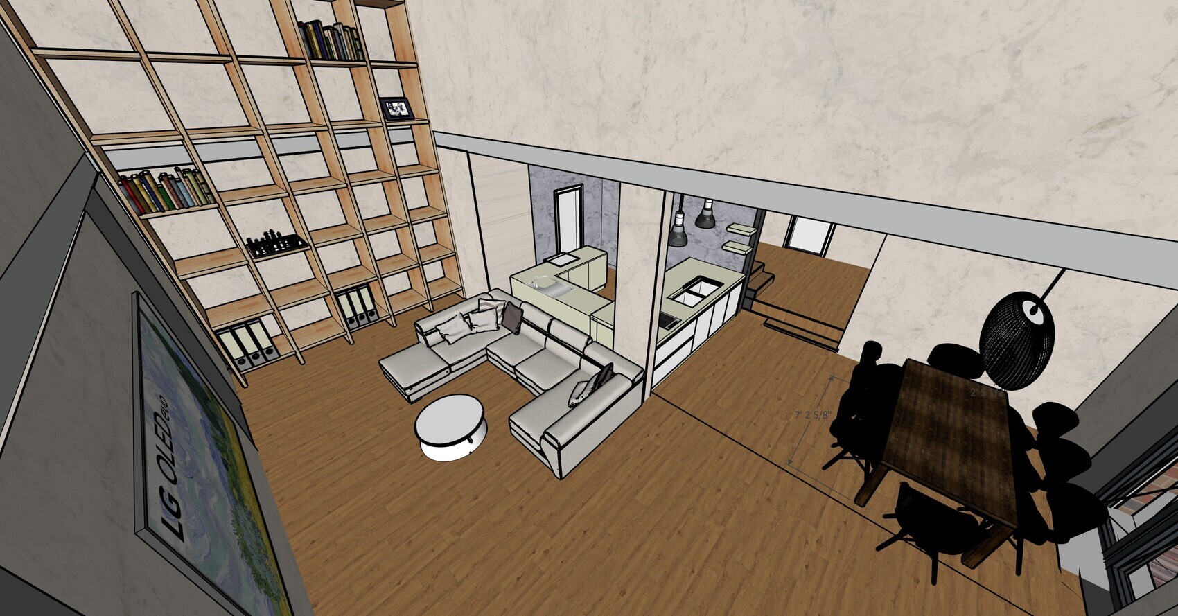

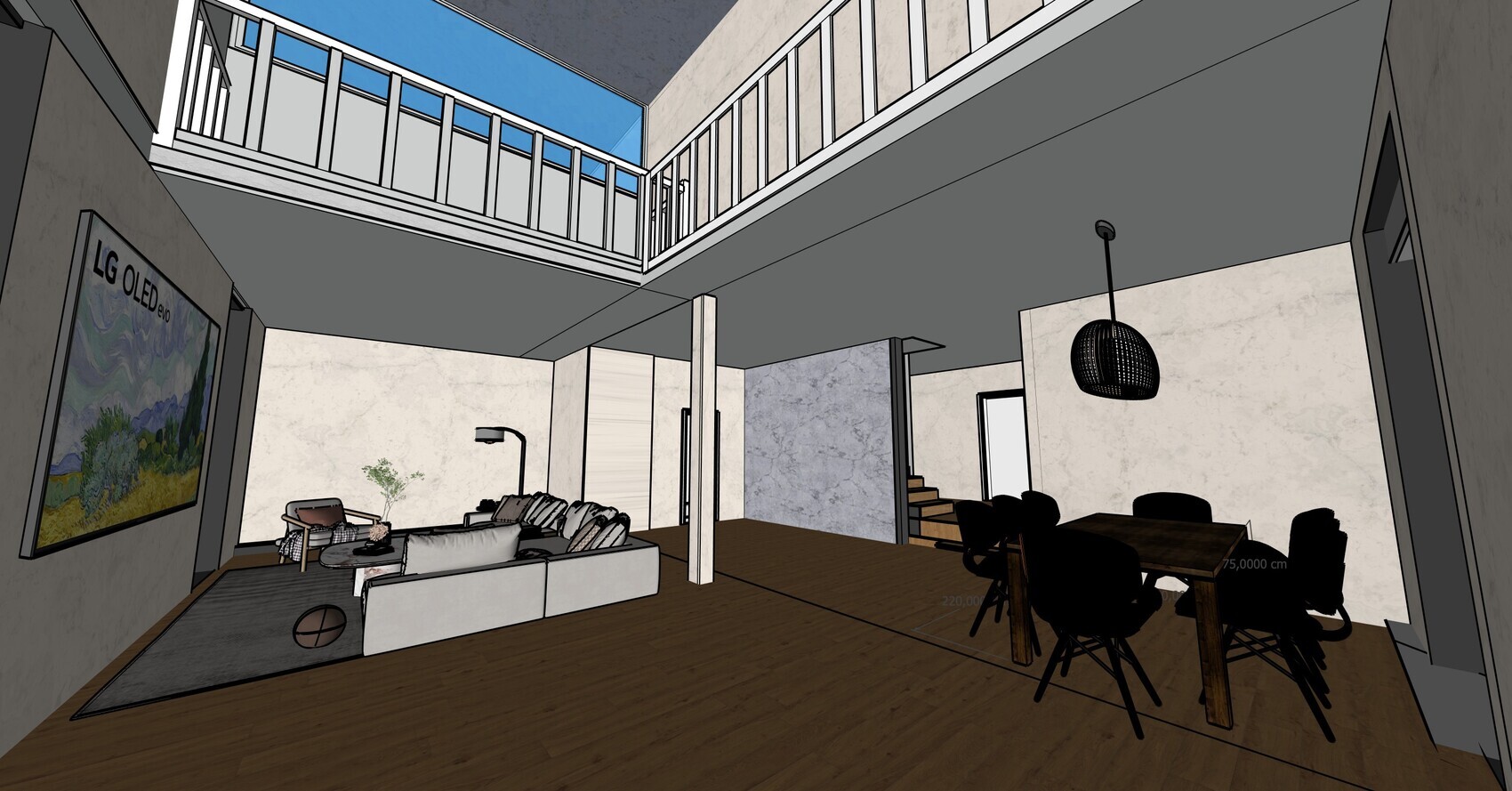

For a tall room to feel right, there needs to be a good balance between length, width, and height. I don’t see that balance in your design. The open space is 50% taller than it is wide. This ratio seems unfavorable to me — it gives a “shaft-like” appearance. Thank you for your valuable advice and sorry for my late response.
In the meantime, I have independently created a provisional 3D rendering (see attachment).
The proportions should now be suitable to avoid the “shaft-like” look.
What do you think? Could something like this be implemented? Before and after

nordanney12 Nov 2025 09:22lucaskilam schrieb:
The proportions should be adjusted to avoid a “shaft-like” appearance.
What do you think? Could it be implemented something like this? Before and after It already looks better and reminds me of my “model house picture” on page 2.
However:
No access to the gallery with the current floor plan – and how is it supposed to be used? Only accessible through the bedroom – so more decorative than practical.
Does the additional living space change anything about the single-story design?
You are placing a large window directly on the property line with the neighbor. That is probably not going to be approved.
Overall, the idea is good but will still require a complete redesign of the plot.
